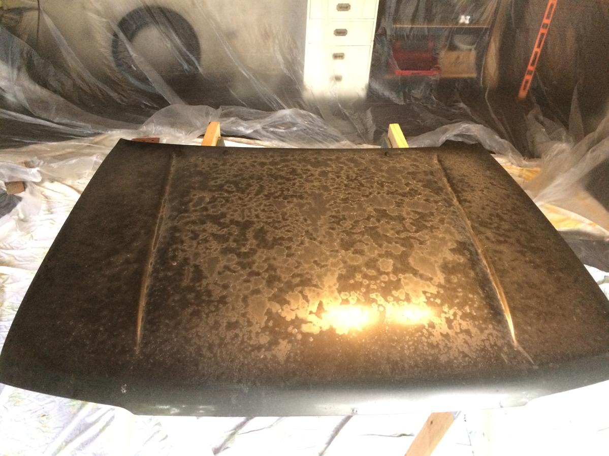

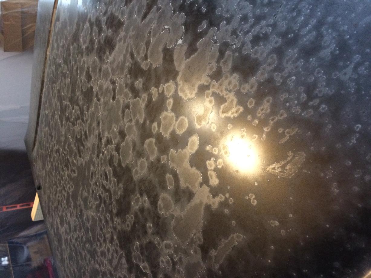

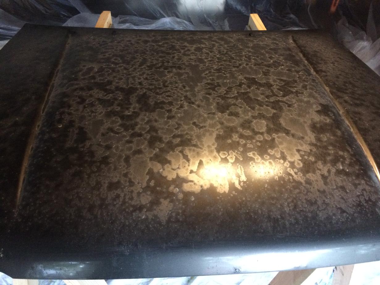

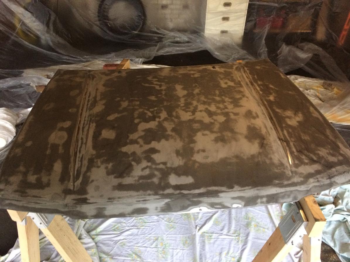

Before - the hood was a major eyesore

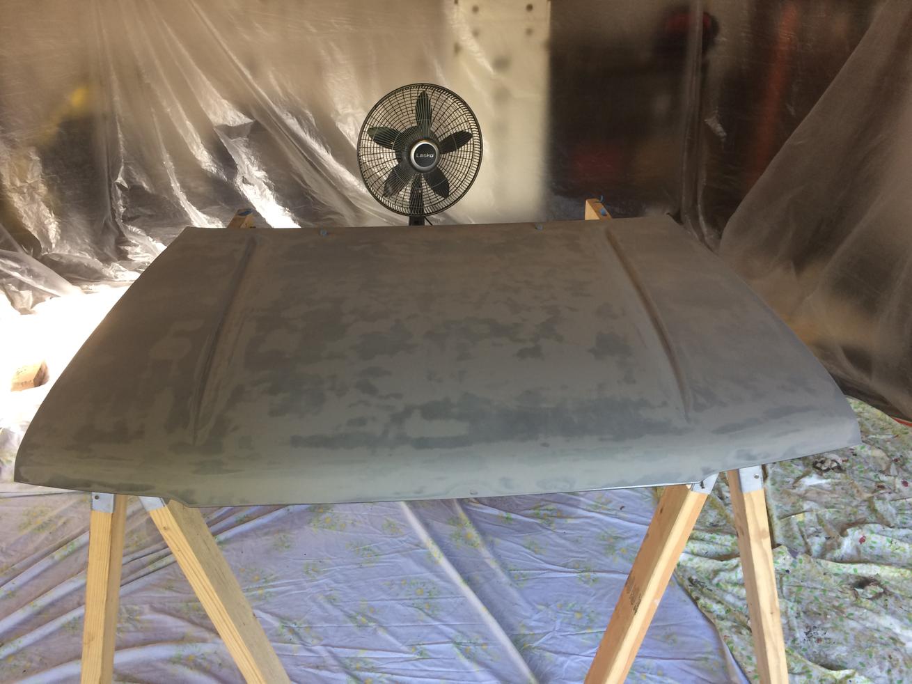

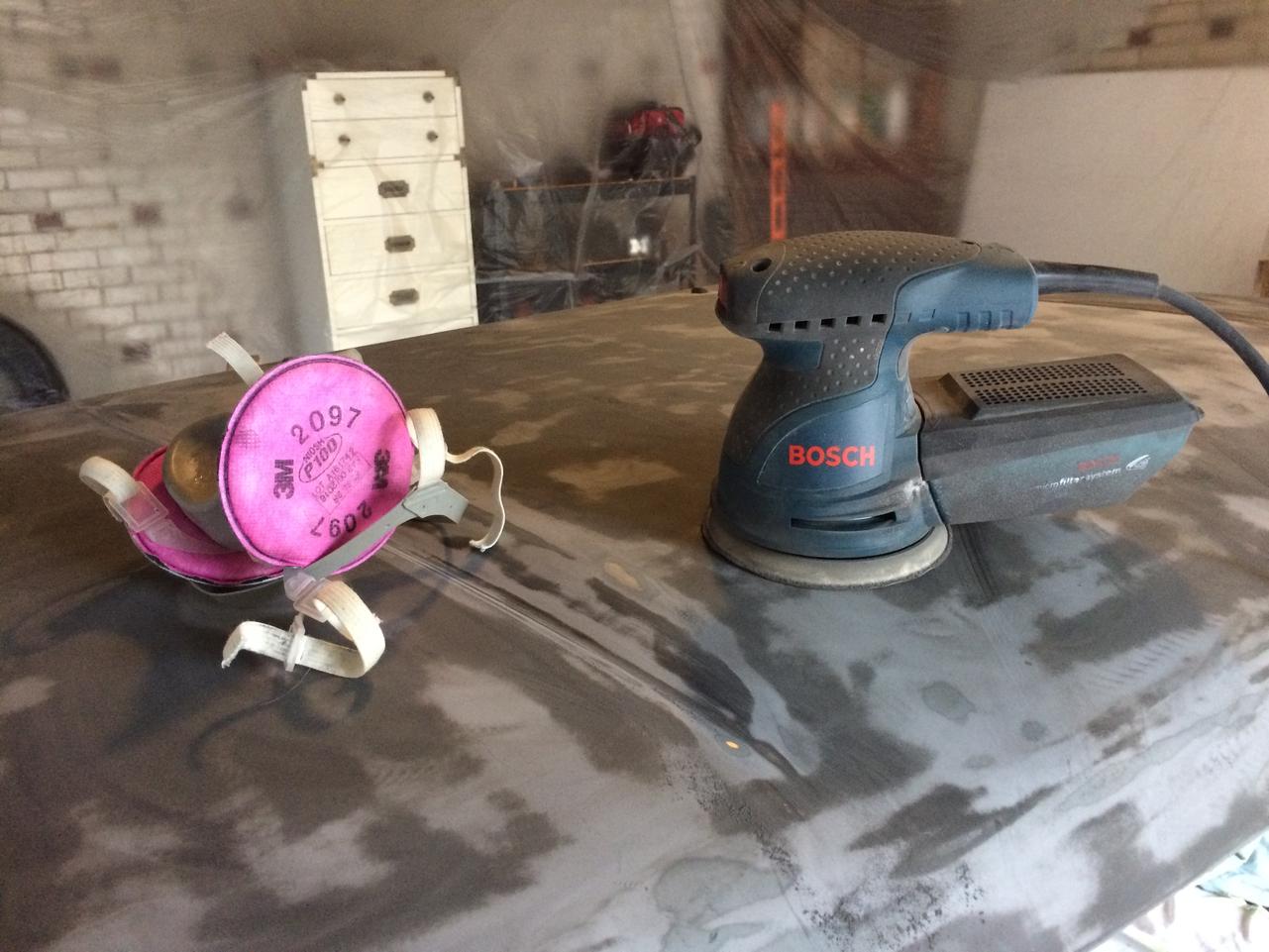

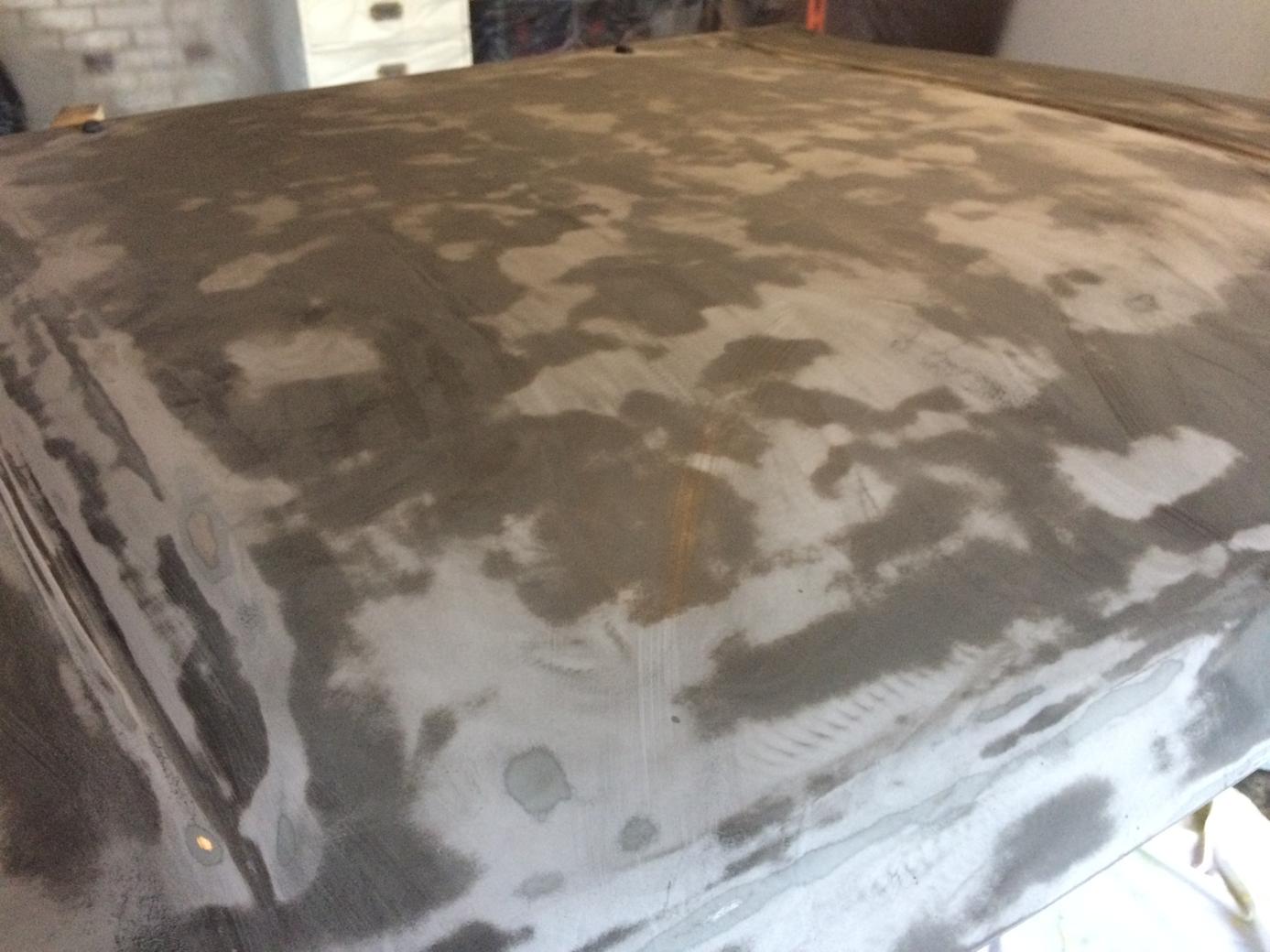

During - started sanding by hand, then said screw it, using my orbital sander and got it done in like 30 minutes - 180 grit then 300 grit. Then washed and ready for primer

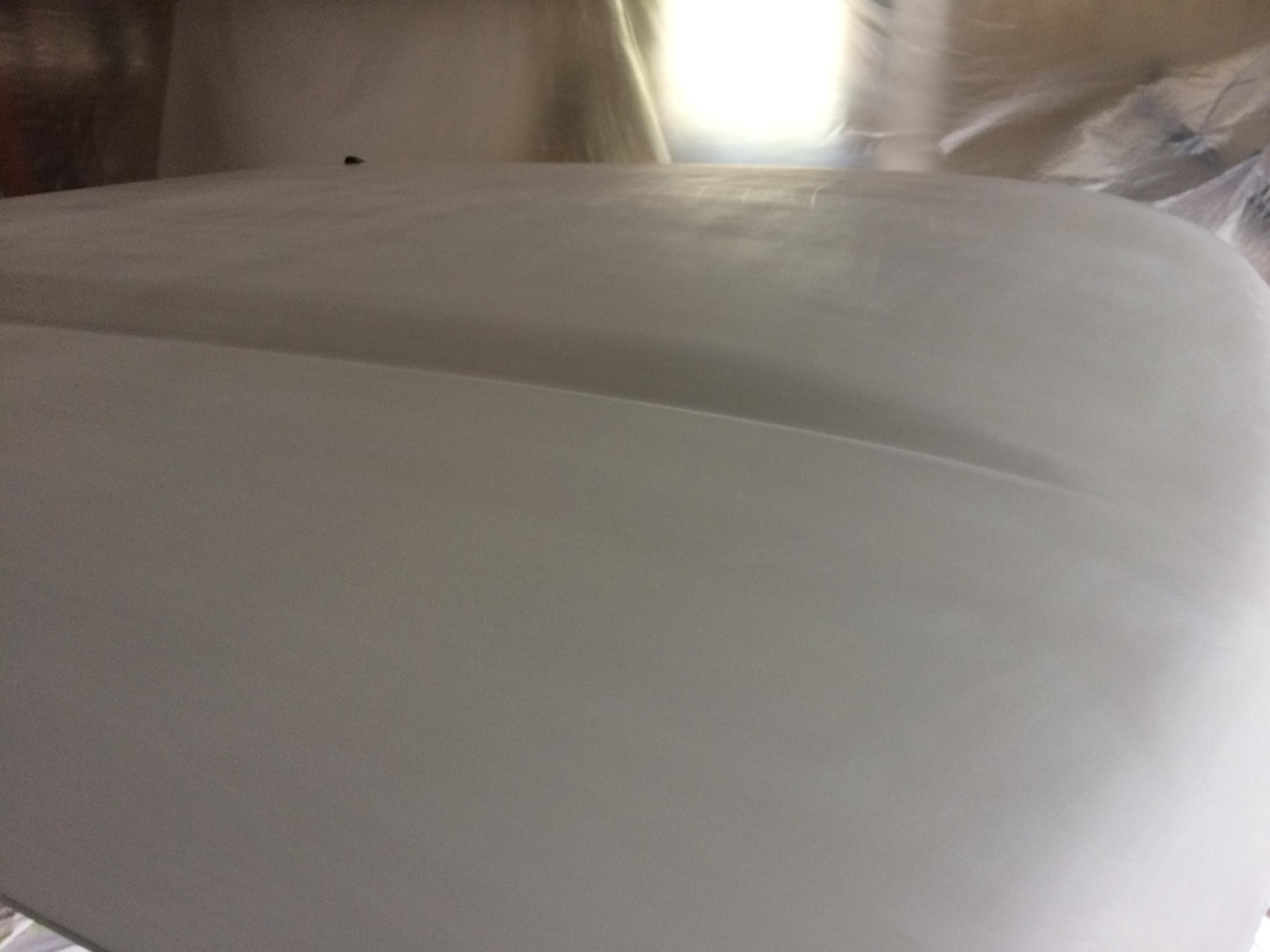

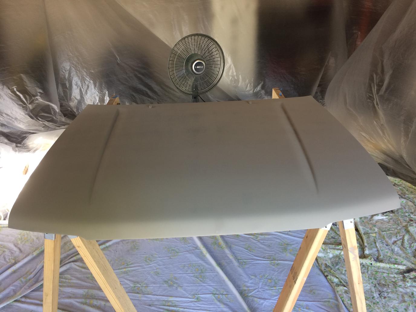

During - Primer was really thick, often times came out with a bumpy texture - but sanded really easily.

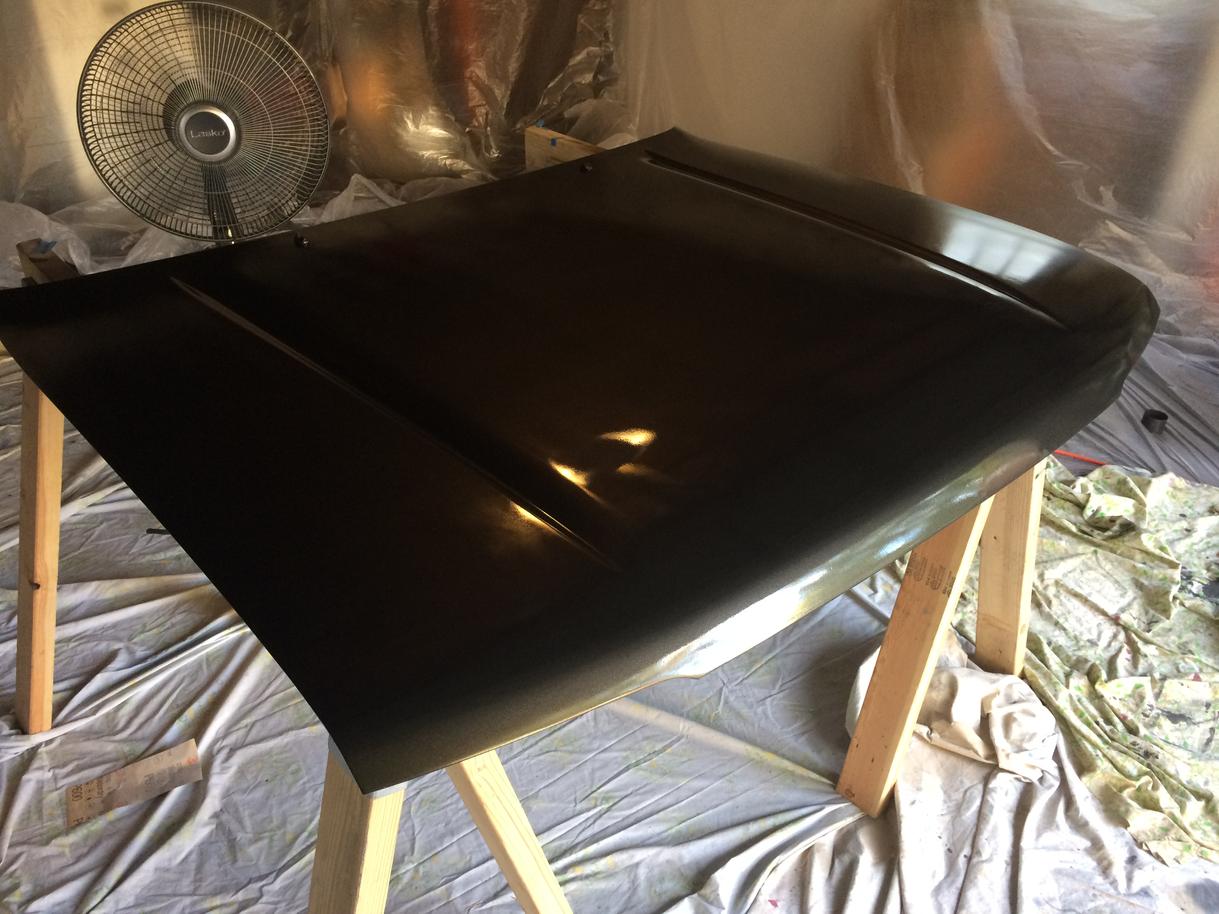

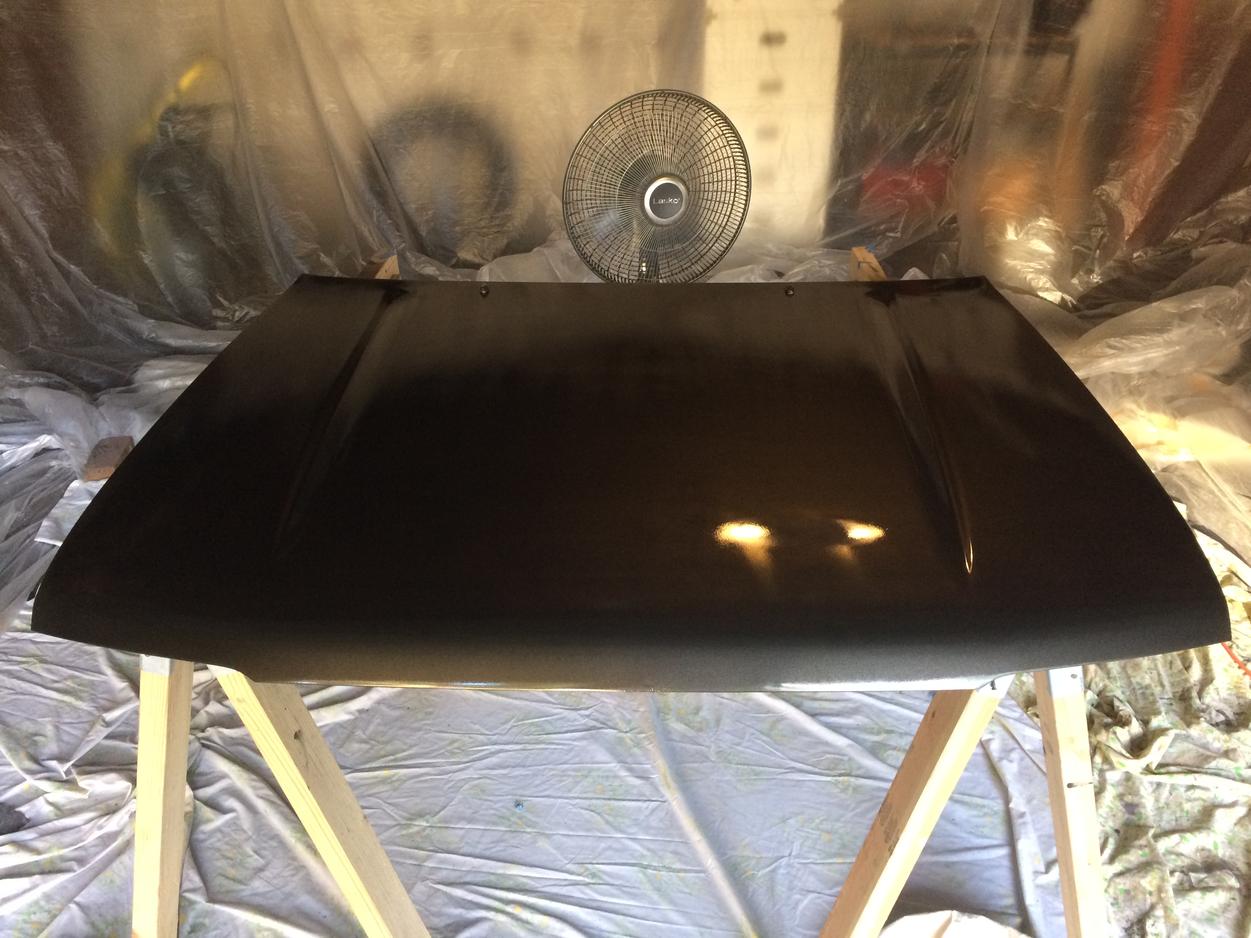

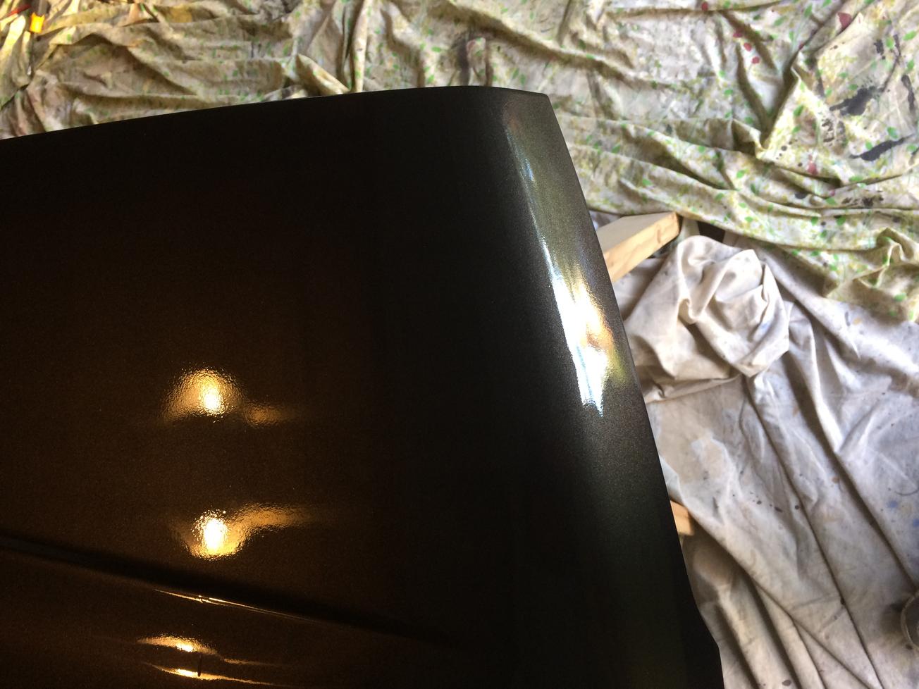

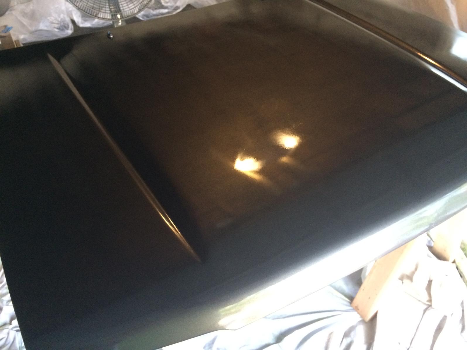

Finished Product! Haven't Installed it yet. Need to do rubbing compound, then wax in 30 days.

Yeah dude, clear is an important part. It will be matte finish if you don't clear coat it. I honestly wish I bought more cans of clear. This is 4 cans each of primer, base, and clear.

Definitely orange peel-I think the rubbing compound and buff will help lot. It said in the instructions that the best way to eliminate the orange peel is to wait longer between clear coat applications- must be completely hard between coats. It was humid out which lengthened drying times and may have led to this.

I've been told the only thing you can do to eliminate orange peel is color sand it with varying grades of abrasives ending in 1500-2000 grit.
There are plenty of tutorials on youtube on how to do it, but it takes time and the right touch (experience)

It did tiger stripe a little, I learned more as i went along - more paint cans totals, the better it will look for sure, and overlapping sprays. I was down to about 50% overlap. When overlapping, hold the gun farther away (I used a gun attachment for the cans- from the same company) since each "stripe" will be hit twice, if that makes sense?
If you are thinking about it, I would say definitely give it a shot. Take your time. I think overall between primer, base, and clear i had almost 20 coats altogether, but it was worth the patience.
