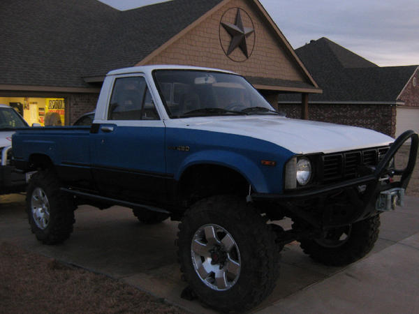

Rattle Can and Roll-on are two very differnt things. I did rattle can on mine and I think it came out pretty good. It took some time but not as much as roll-on would, and it was under $100. I used Rustolium Painters Touch. (Navajo White). Basic sanding, priming, sanding again after two primer coats with a higher grit paper, then about 3 coats of paint and a wetsand after. Then rubbing compound and wax. Wasnt hard at all and came out better than i expected. Best of all is i can touch it up in like 5 seconds if need be. Let me know if you have any specific questions.
Sand
Prime
Paint
It came out pretty good and has held up to the elements very well so far over the last 7 months.
