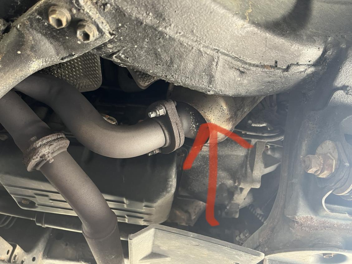

Old thread but same as you posting for anyone else out there as well. 04 v8 and when in park and when in motion, nothing at all. In drive and at idle at a stop light, loud rattle.
Put thing in drive with parking brake and someone in there on brake and took a peak. It was this shield.
