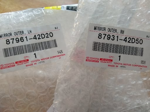

Don't want to add to the confusion, but I went to look back at my receipt from when I ordered them a couple years ago.
My receipt shows..
87961-42D20
87931-42D50

now that is strange because i order these first and they were not blind spot mirrors

edit i in fact did not order 87961-42D20
87931-42D50 the first time i was mistaken
