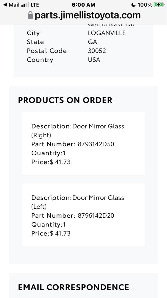

here's what i ordered and installed last week, simple and work great.
Toyota Parts Factory - #1 Source for Genuine OEM Toyota Scion Parts & Accessories | Camelback Toyota Parts
Part Number Part Name Price Quantity Total
87961-42D20 Door Mirror Glass (Left) $50.40 1 $50.40
87931-42D50 Door Mirror Glass (Right) $50.40 1 $50.40
Subtotal: $100.80
only thing was shipping was $20... ouch!

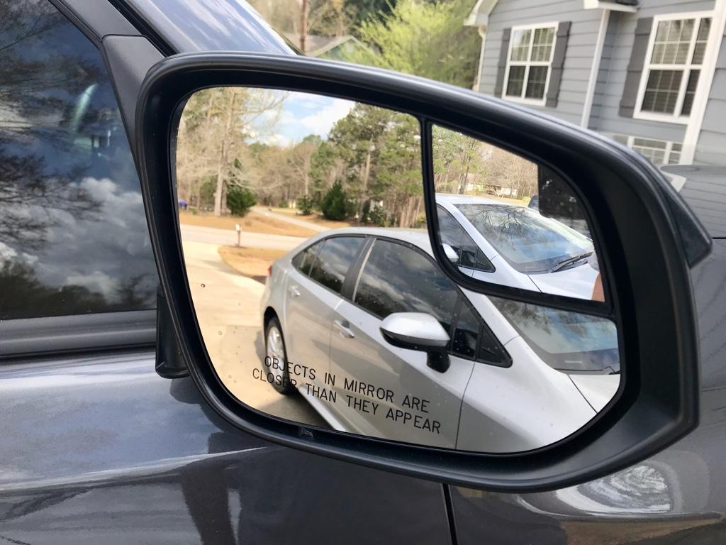

It doesn't give you the electronic blind spot monitoring...
...it's just that these mirrors have the little parabolic sections on the outer edge that allows you to see your blindspot in the mirror.

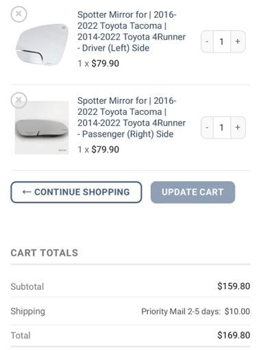

I think the aftermarket model I posted about should work. The seller confirmed it has been tested on a 2022. I placed an order and will report back how the install goes.
