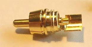

Maybe not the ideal way but, would soldering your own RCA's be a solution?
I think it's a better alternative to having the stereo mounted further out to make room in the back for bulky premade RCA cables.
