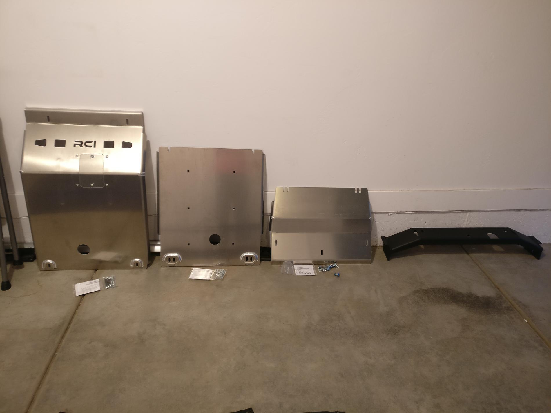

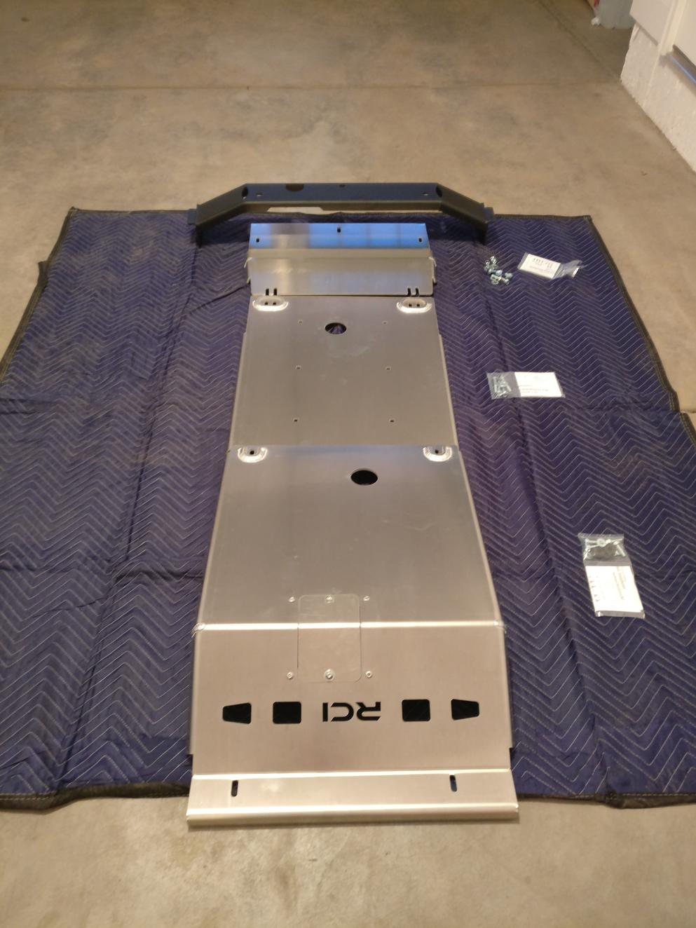

Got around to washing the underside of the truck and put my skids on today. Here they are laid out before the install. The most difficult part was installing the transfer case crossmember. Otherwise it was pretty straight forward.

Thanks for sharing! Can I use the existing stock filler plate with the RCI front skids?
You won't have any places to mount the nuts for the rear mounting holes on the filler plate. The stock front skids has access holes where you'd put the nuts for the filler plate, the RCI won't. You can still screw in the front nuts on the stock filler plate but it won't be secure in the rear. I mean you could wedge (and possibly trim) it up above the RCI front skid since it's just plastic but it's not an exact fit.
