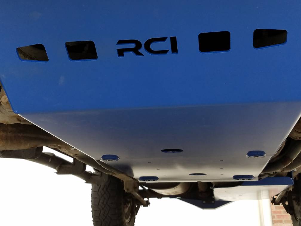

Received the skids yesterday and installed them with the help of a friend today. Overall, super impressed by the quality of the skids. Can't wait to bang these around on the trail!

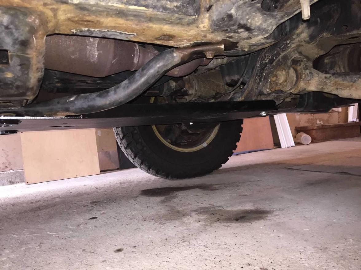

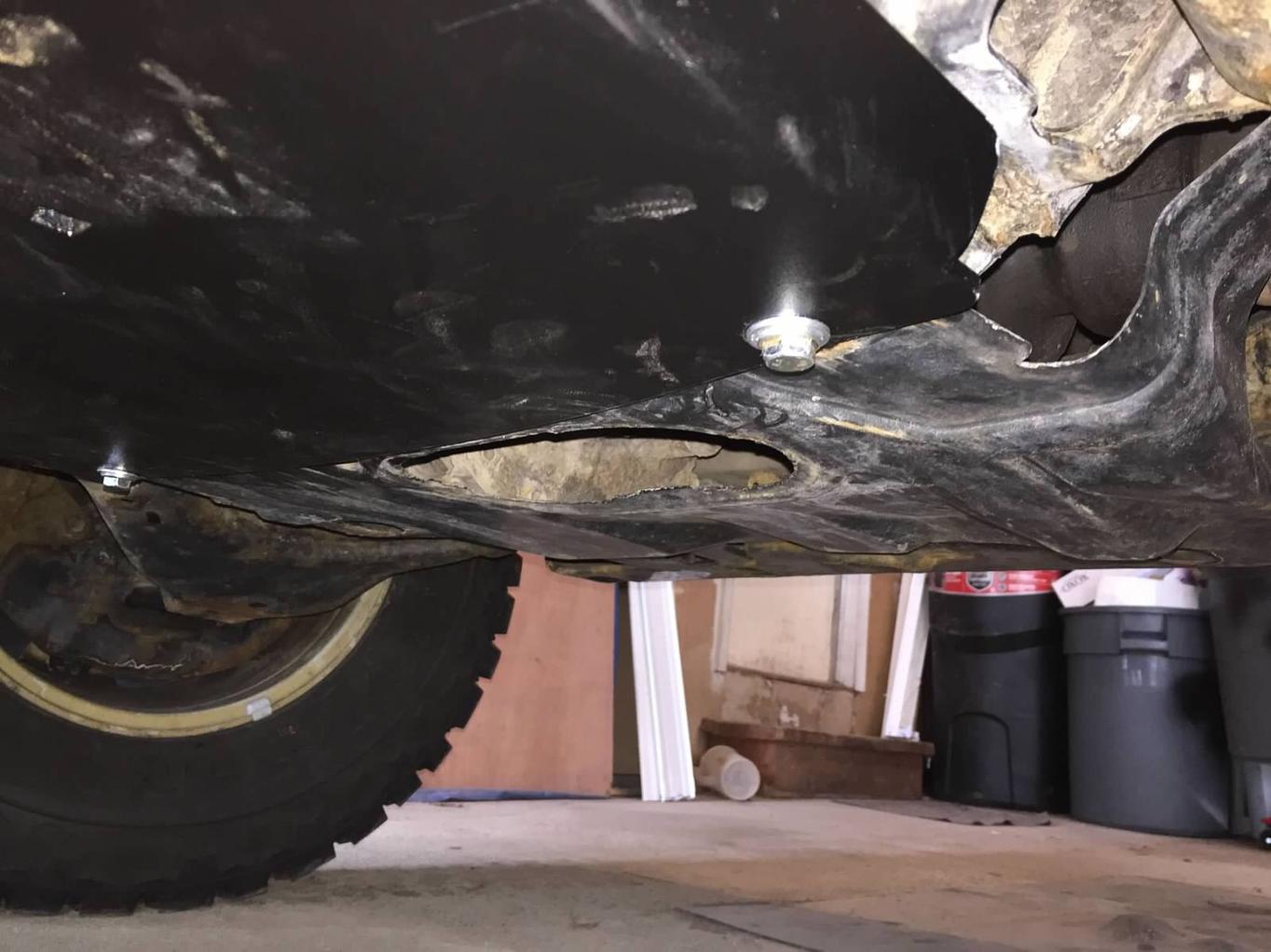

Well I installed my trans skid with my stock front skid. Only thing I'm not sure of
though. I installed the trans skid beneath my stock front skid. Looks better that way,but the trans skid bolt heads are exposed now. So maybe it gets sandwiched between the stock skid and the crossmember? Then the bolt heads won't be exposed.

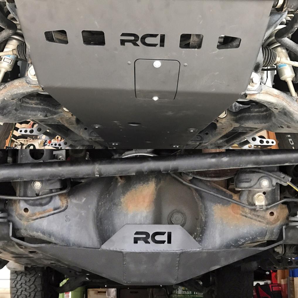

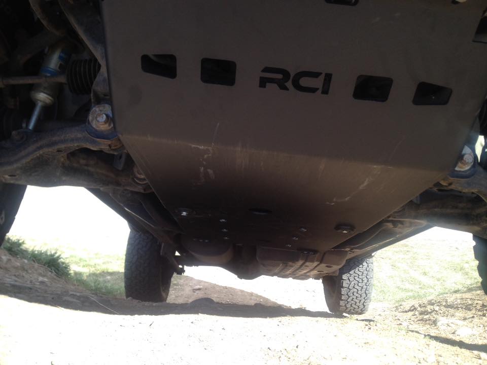

Picked these up last week, painted and installed. My only issue is the bolts are "soft" and if the holes are messed up or not pre tapped then the heads will torqe right off.

I would reverse the configuration, trans plate under the front plate. Think if you slide on a rock, it would be easier to go from plate to plate given forward momentum. Unlike your current setup, you might get caught on the lip.

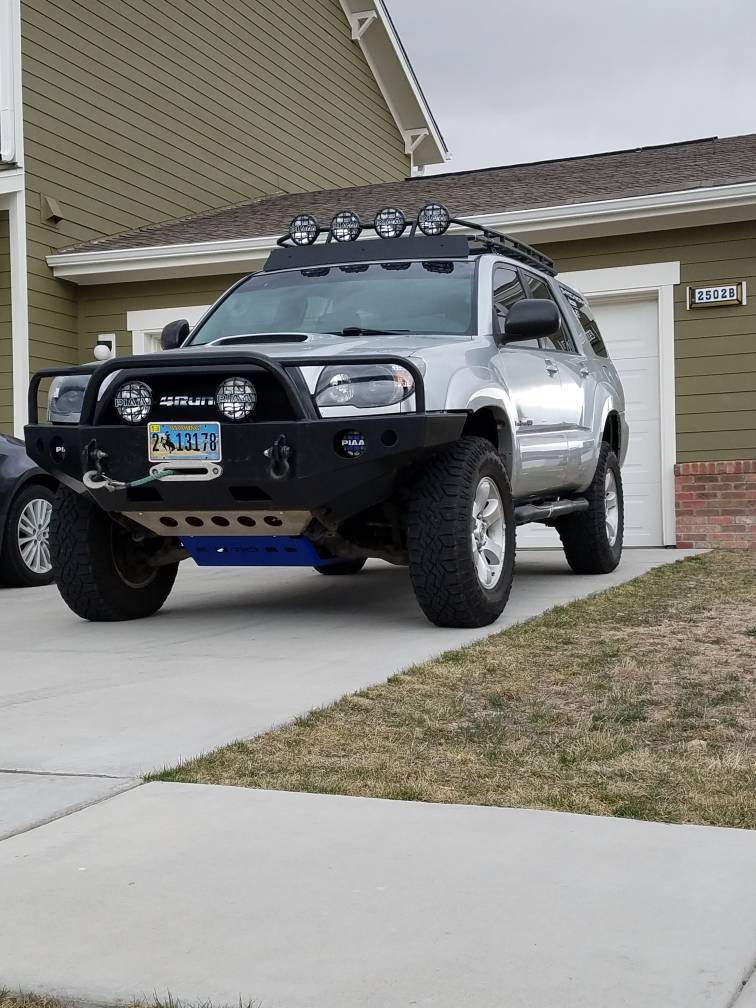

Installed. And I'd have to say I am amazed at the quality. Thanks RCI!

The support brackets mount parallel with the sides of the skid. Running front to back (not side to side). There are three holes in the support bracket that match up with the hole on the skid. You can see in the picture above, the two rows of three bolts that run in the center of the tranny skid. The brackets are there to added strength to the skid because of the space between the skid and transmission.
