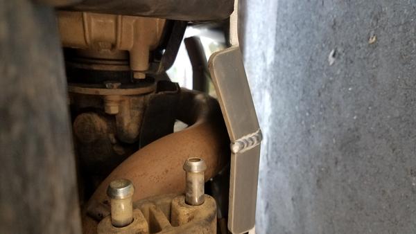

Noticed a different sound when driving, looked under, saw it.
Going to have to get the exhaust moved.
Super common problem with a 50 cent fix. Put a hose clamp over the rubber isolator and tighten it enough to stop the rubbing. Include a zip tie in case it ever slips off. No need to tighten much.
Moving the exhaust will cost way more. I eventually did that because I wanted to raise the t-case skid up an inch...

I saw this issue as well last night installing my skids. I ended up waiting to install the transfer skid to think through a solution.
I've been planning to do the hose clamp fix for quite a while. I guess it must not bother me as much as I pretend because I've had a vibration for about 4 years and still haven't done it. I have replaced that skid a couple times when I've bashed it up mercilessly. :lookout:
Edit: decided enough is enough and ran out (working from home), threw a worm driven clamp on there that I had (nice stainless with rounded edges so I don't cut into the isolator). Cranked it down... moved the exhaust up off skid. Now I need to drive... thanks as always [MENTION=106176]wfo9[/MENTION] for the reminder!

Man [MENTION=106176]wfo9[/MENTION] you are really delivering these days. I had this problem as well and ended up putting spacers on the skid plate bolts to drop them down just enough. Will try this trick next!

no pic, but you literally take a hose clamp and you put it around the entire rubber hanger, and as you tighten the clamp down, it raises the rubber hanger, and exhaust pipe.
It literally takes 5 minutes to fix and about 3 dollars.
Sorry, no pics, but once you look under your car, it will make sense.
