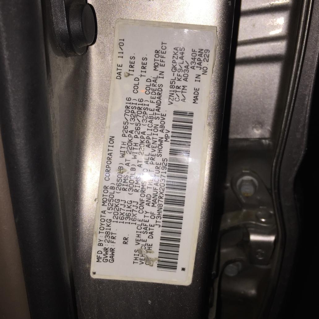

what am i looking for on this sticker?
From that sticker, your axle code is A03A. Give that a quick google and you'll find some info about it. But unfortunately, not very reliable. Best way to be sure is to count teeth. Divide the number of teeth on your ring gear by the number of teeth on the pinion gear, and that's your ratio (i.e. 43/10=4.30)
