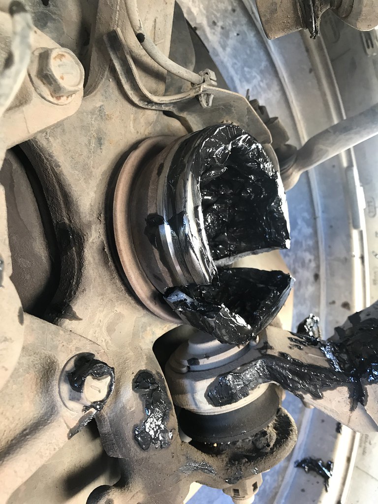

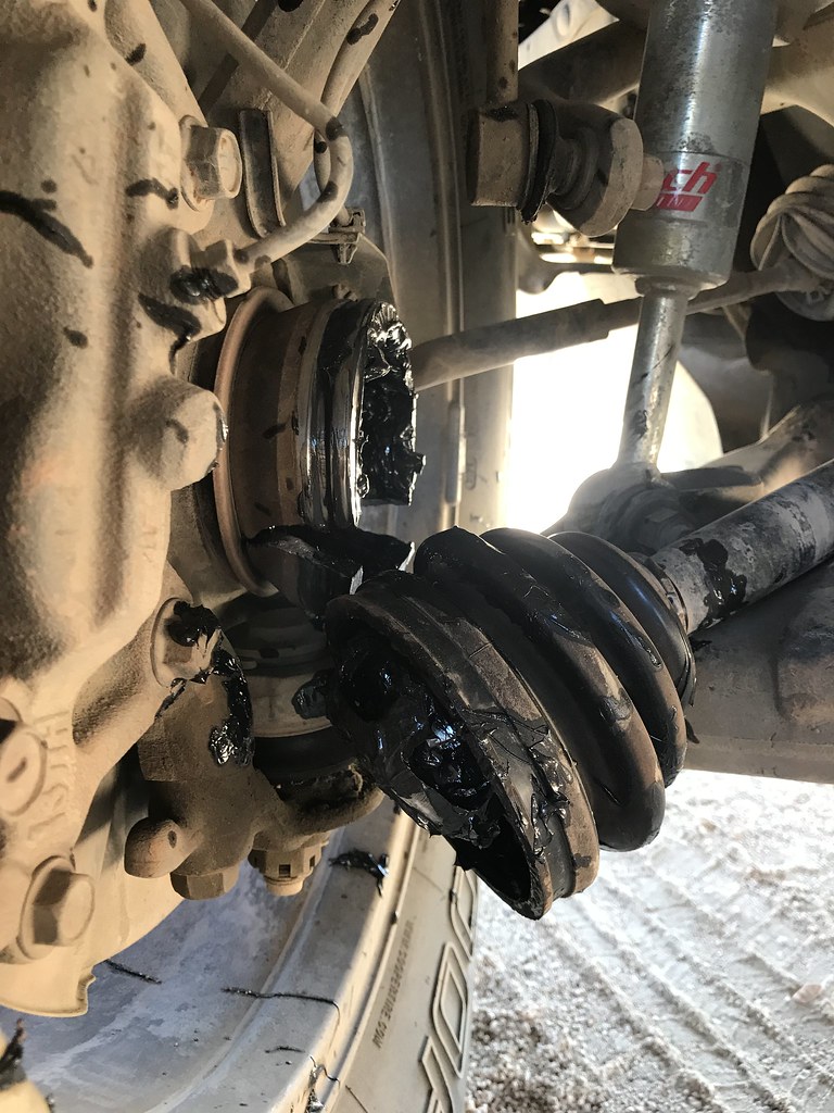

I honestly don't know if the joints are alright, both just have the typical torn inner boot. I don't know if a shop will just replace and repack the boot, they seem hellbent on replacing the whole thing.
The truck has 205k miles BTW. I doubt it's ever been offroad, still has the xreas system.
