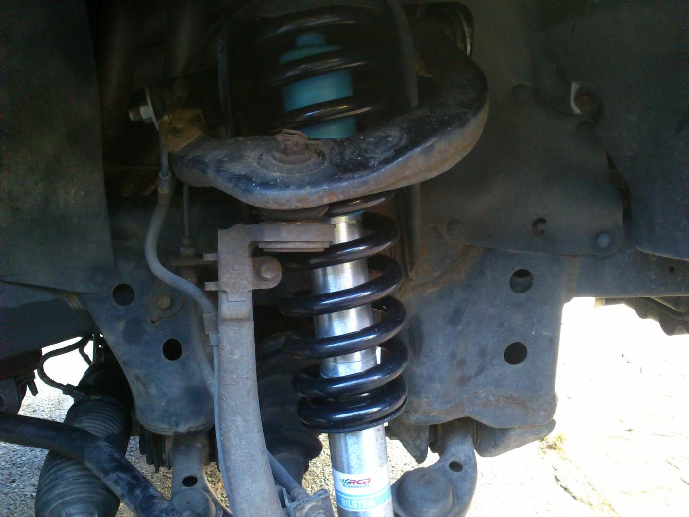

Shocks: Tacoma BE5-D558
Springs: OME 881
Setting: lowest notch
Comments: 1997, 4x4, 3rz 4cyl (lighter than v6). Ride is pretty good on or off road. stiffer than stock, running 265/75 duratracs.
Is that the lowest/bottom setting or the very top one?
Someone else can jump in here and correct me if I'm wrong, please.
I believe he is referring to the top setting.
With the Tundra 5100/'99 tall:
bottom setting: Same height as '99 stock
2nd - 5th setting: add 5/8" per setting, although Bilstein only recommends using the bottom two settings.
The bottom, middle and top settings on the Tundra/Tacoma are very similar.
