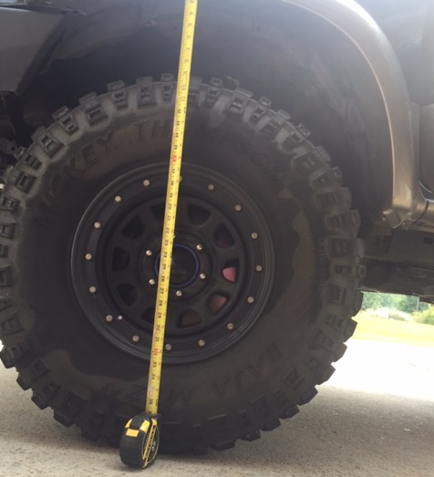

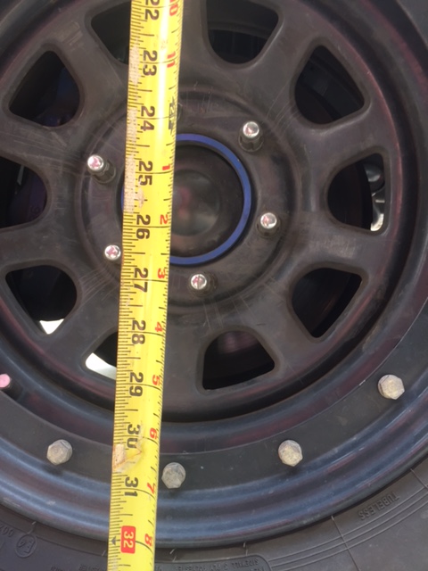

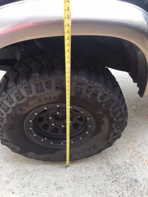

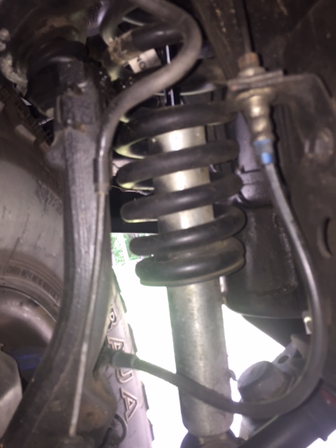

Highest setting and here are pictures

Thanks! how's the ride? what about the CVs? was very curious about it because the OME internet info on the 2887 indicates that it's about 15.75", so i imagine it would be very difficult to install it at the highest position of the tundra 5100.
would you happen to have a measurement of the free height and wire diameter of the 2887 coils before installing them? just wanted to confirm the internet data provided by OME.
It's definitely a stiff ride but once you break them in its really not that bad. When you are sitting that tall and running 35's smooth ride is not the intention. When I did the lift I also installed new NAPA CV's and in about 2 months the boots ripped. I installed high angle CV boots and 14 months later no issues.
