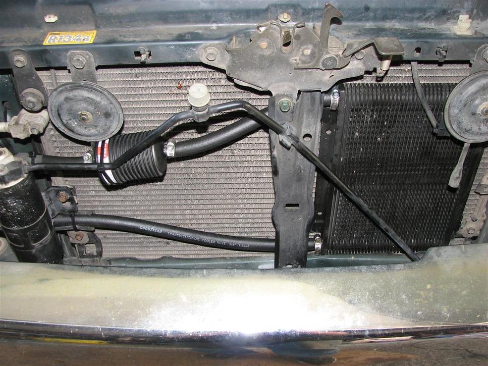

In short, I will be installing in-line transmission filters that go just after the cooler on the return line. Just as preventative maintenance - hope to help extend the transmissions life and help eliminate flow issues through the screen over time and buildup / contamination of the fluid.
I am going to try out the magnefine 3/8" inline filters and see how the filter media and magnet looks after a bit. I will drain a small jar of fluid before installing the filter and then after it has been run for a while to see if the clarity improves as well.

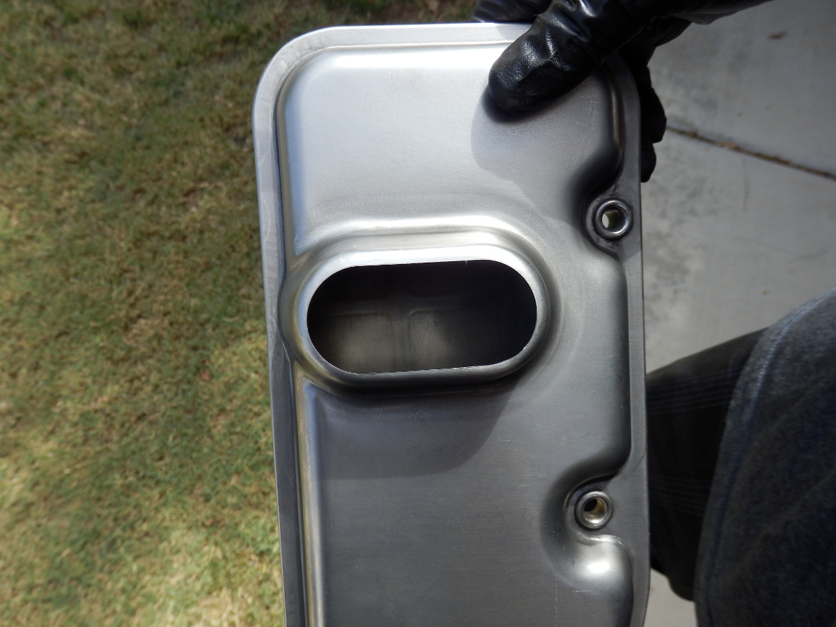

Here are some photos of my teardown this weekend. Again, nothing abnormal for a car with just a screen strainer.
In this photo, you can see the strainer assembly in the pan. Notice the blackish coloring on the sides and you can see where I wiped it off the surface of the strainer assembly (large rectangle thing with the oval hole)
Here you can see particulate buildup in the screen. Normal for a car with 230K miles that has never had a screen change. But not a good thing.
Here is the strainer after it was thoroughly cleaned / flushed and back flushed over and over
Some of the magnets from cleaning the pan. The bottom two were cleaned, the top was not. Again normal but not desirable of course.
Wish I had more pics before I wiped the pan down and the strainer. I am thinking a quality inline filter may really help the overall life of our transmissions as they are only about $16 ea and the filter is replaceable. Also it will help keep the screen clean and pan clean. Cannot hurt anyways.

where did you mount yours ?
I forgot that I had one on a shelf at my sons. Need to put it in. Should have done it when I installed my cooler. What was I thinking ? guess its just old timers. Will have to do it next week when Im at my sons
