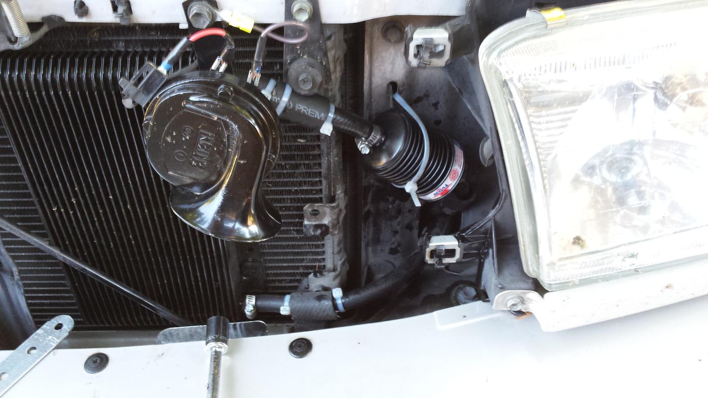

mounted mine yesterday and cleaned up my horn wiring
Right on man - did mine on both 4runners too. I do not use a separate transmission cooler so I mounted them just off the return line from the rad.
