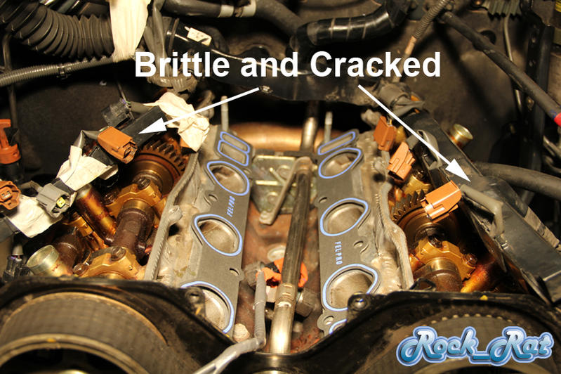

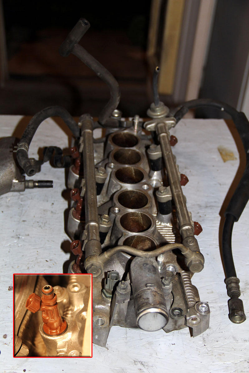

First of all that is your intake manifold and not your plenum. You've already removed your upper and lower plenum. Intake manifolds are designed to be rough to allow for atomization of your air/fuel mixture for a clean combustion when it gets to your pistons/cylinders. That's why it "collects" unused fuel air mixtures
I've attached a photo of my manifold from about a little more than a year ago and it doesn't look at all gummed up like yours. Neither did the intake ports on my heads.
A few recommended it already, use brake clean (evaporates rapidly) in a well ventilated area with a tooth brush or small wire brush. Nice thick Nitrile gloves because it's awful stuff. Cheap white respirator mask.
It would seem to me that you would be taking a big hit on your gas mileage and possibly a rougher idle than normal with the looks of it. Surprised you haven't kicked off a 0420 for HC or for your A/F.
No reason to remove your intake manifold unless you want to clean it and the ports on the heads. I needed to remove mine to replace my knock sensors. Pics are at 309K
Honestly, gaskets are gaskets. The only difference you'll see is in your wallet. I use Felpro.
Once back together, begin with cleaning all of your Air/Fuel components, Filter, MAF, IAC, Vacuum lines, Etc....
Just my own .02
