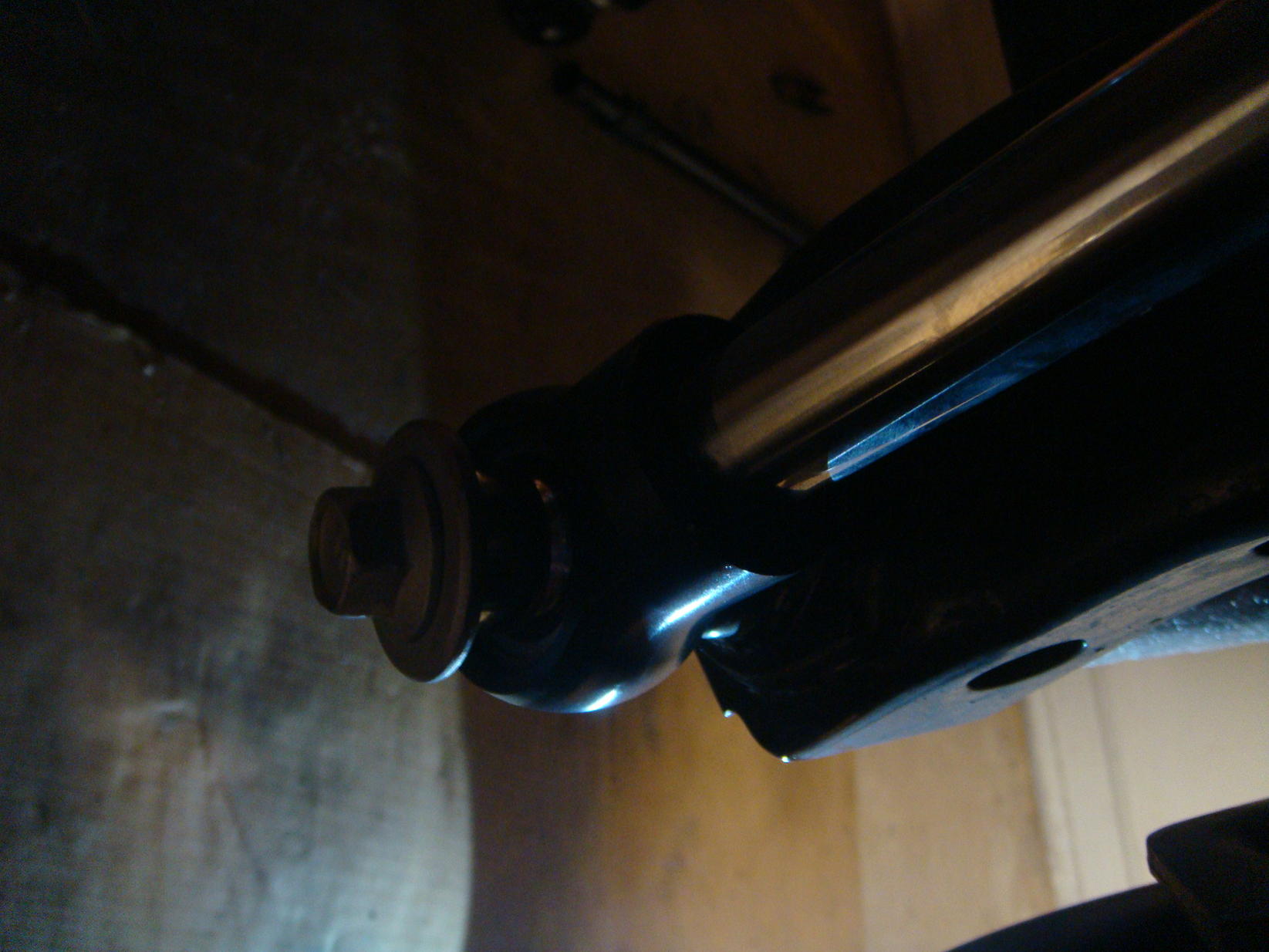

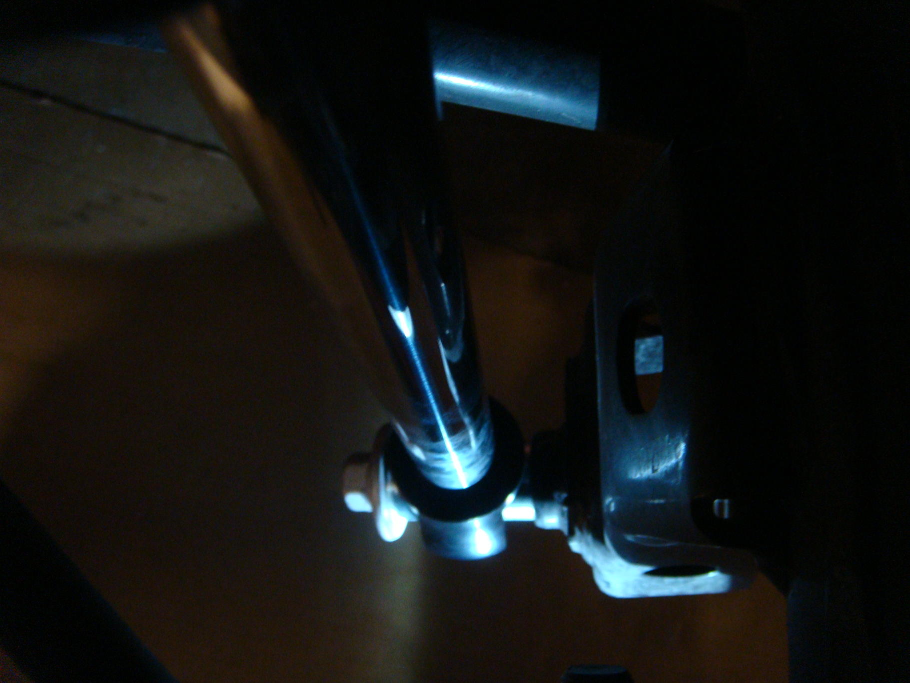

The heim shouldn't take too much force if the lower mount is clean and the heim is aligned. 1 spacer should go on each side of the heim, so slide spacer on; heim on; spacer on; then lower mount bolt.
is it like this? i'm doing my right now.
