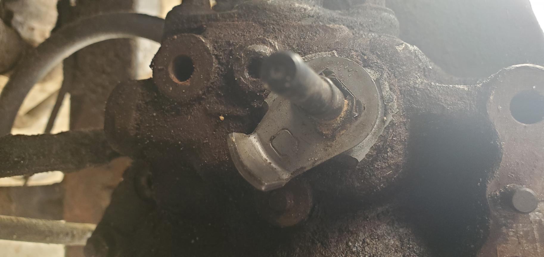

Need some help: 3Rd member was swapped, not sure what im looking at
Rear diff was leaking badly and had been run out of oil was trashed. The shop i took it to replaced the rear diff and third member with a locker because that's what they could find. SO far i have not been able to unlock the locker and my transfer case is puking oil (maybe from ratios not matching ? ) . may be unrelated but i also get a heck of a vibration at 80MPH too.
Here's a picture of what I'm looking at. From what I can tell its what is left of the elocker actuator. but it only moves a little bit. With the rear jacked up i can spin the wheels and it doesn't matter what direction i turn the handle the locker stays engaged.
any help appreciated thanks

stop using your vehicle before that rear diff is fixed. you're going to destroy the TC or the rear diff or even perhaps the transmission. you don't drive a locked center diff on hard surfaces.
and until you have verified that the rear diff has the same ratio as the front diff, don't engage AWD/4WD.

After inspection: Vibration was from a failing Universal. Transfer case leak was caused by a failing seal around the shifter stalk, replaced that and a micro switch for 4x4 indicator while it was in the shop. Rear Is Definitely 4.3 not 4.10
On the hunt for a rear 4.10 3rd member, locker would be cool but at this point i just want it to go into and out of 4wd without binding and damage.
Decided to send this rear diff to ECGS to be rebuilt as a 4.10 and it arrived back today. Also ordered a new rear diff actuator motor and sensor. In the process of cleaning an alarming amount of metal shavings and rust from the rear axle. Doesn't look like it was throughly cleaned from the first failed diff. Also the fluid was milky and contained water. Hence the rust.
If anyone down the road is looking at something like in the above picture, it's what's left of the inside of the rear differential actuator. The material is very brittle, that combined with a swollen o-ring most likely caused what I ended up with.
Oh and the rear locker was stuck in the engaged position because the housing was never modified to fit a locking rear diff. In the process of using the retrofit kit from yotamasters.

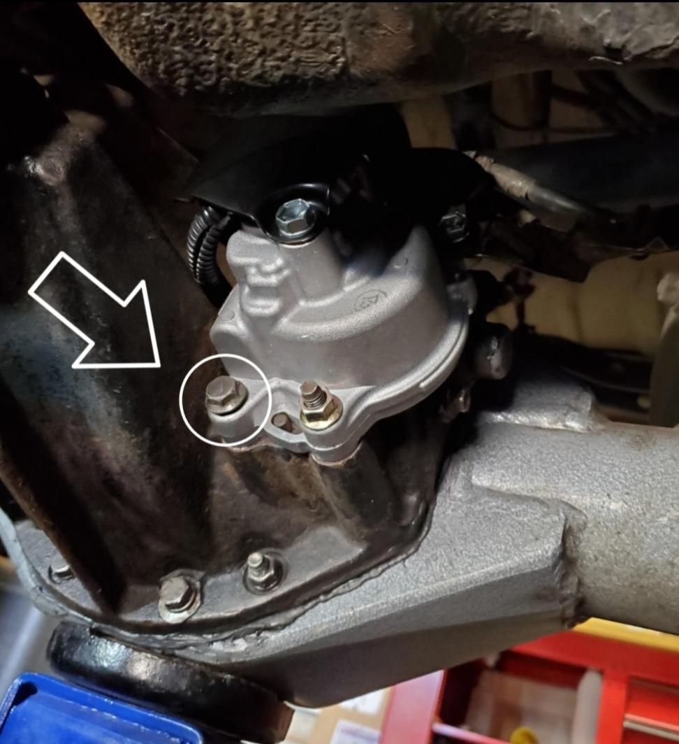

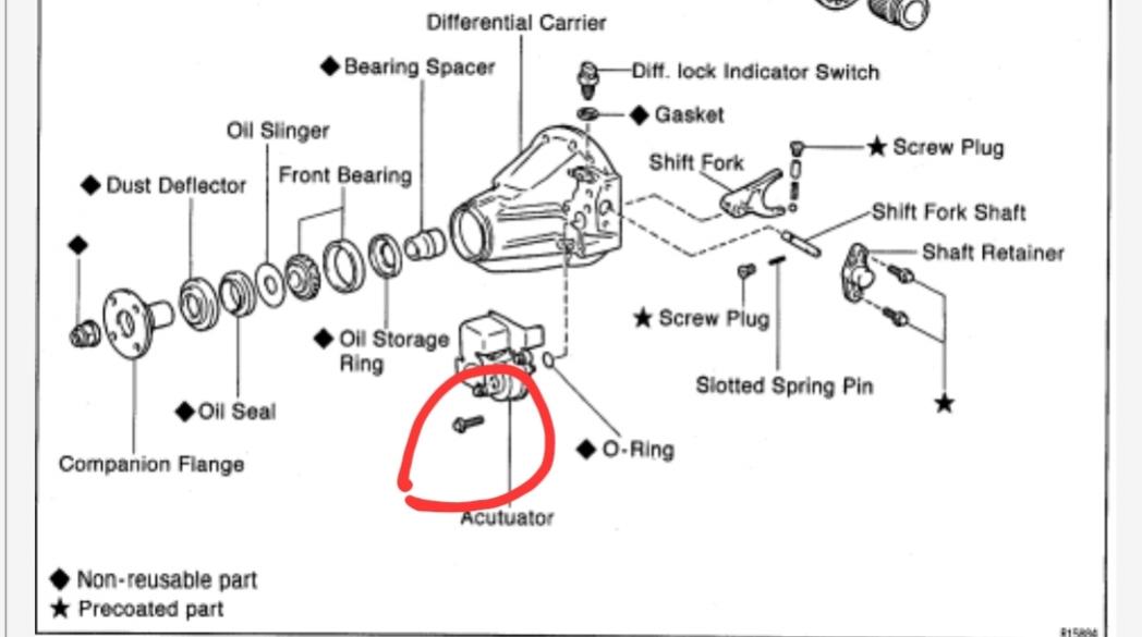

On a related note does anyone know what bolt was used to secure the elocker actuator to the rear diff? I know 2 of the holes are occupied by the extra long studs. The third hole looks like it should have a bolt in it.
