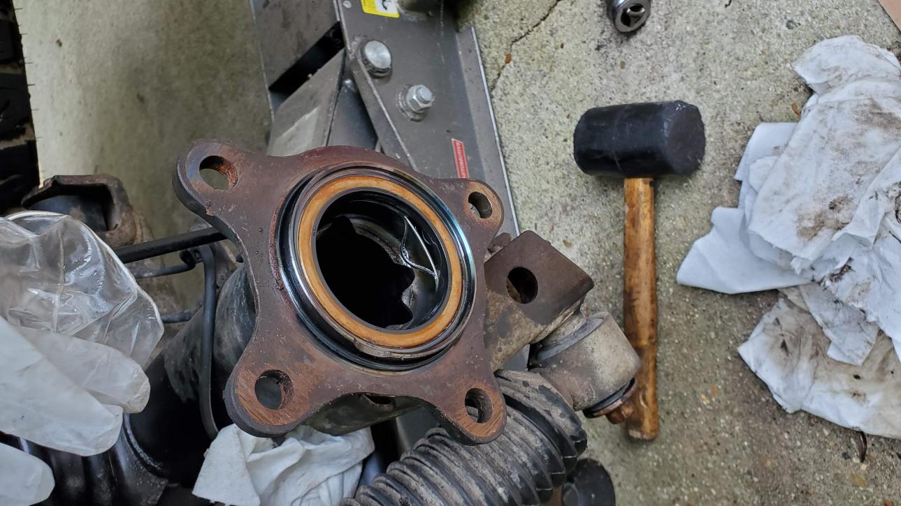

I was definitely still leaking after the seal replacement a few weeks ago.
Since I had to re-do it I went ahead and got the Dorman replacement from Rock Auto. $400 delivered in 2 days.
The retainer on the orig axle had a groove cut into it. See pic.
The seal I replace a few weeks back had the spring loose. Wondering if it could cause the groove in the retainer

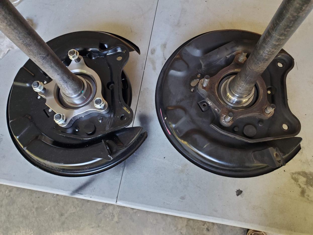

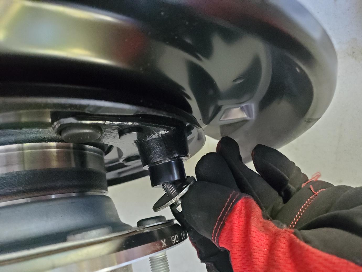

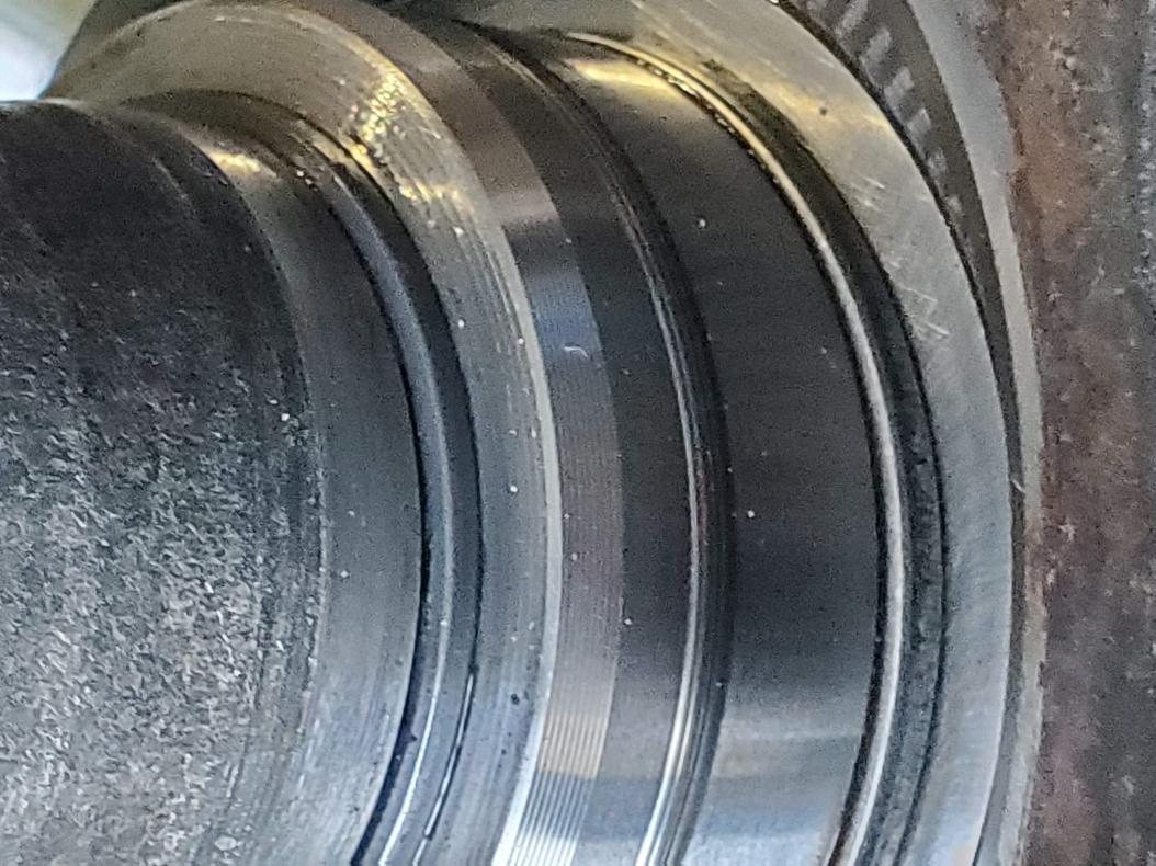

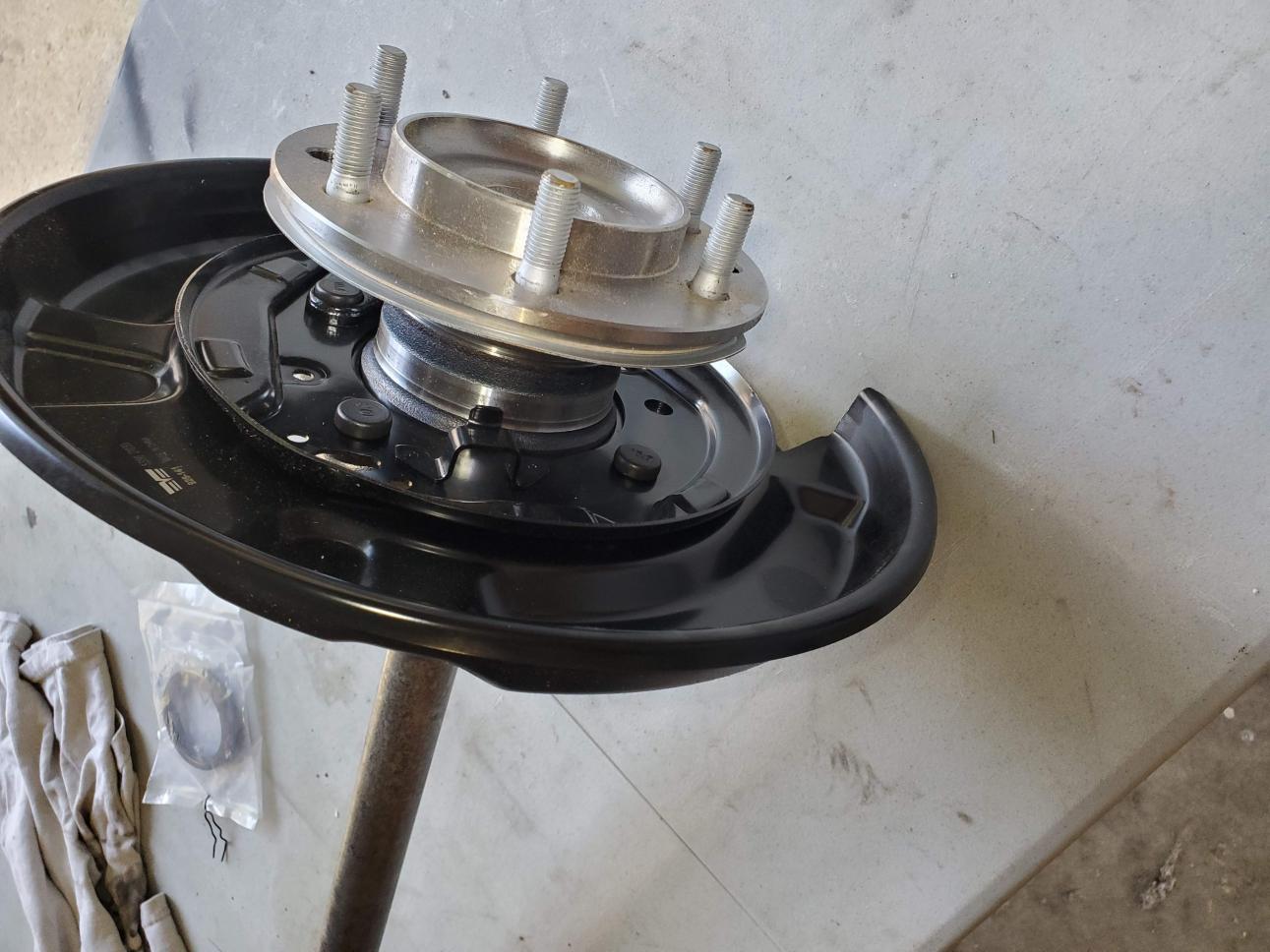

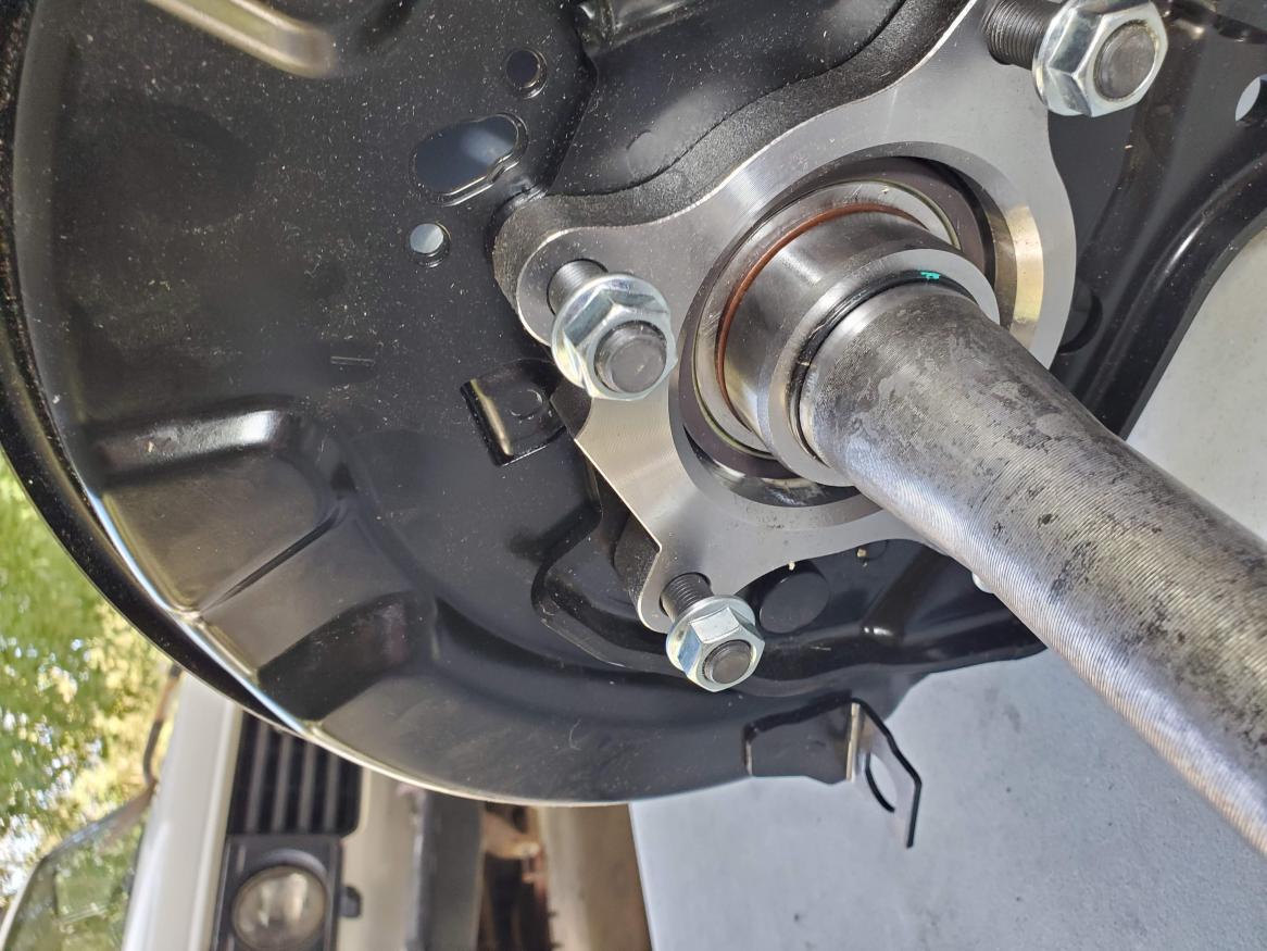

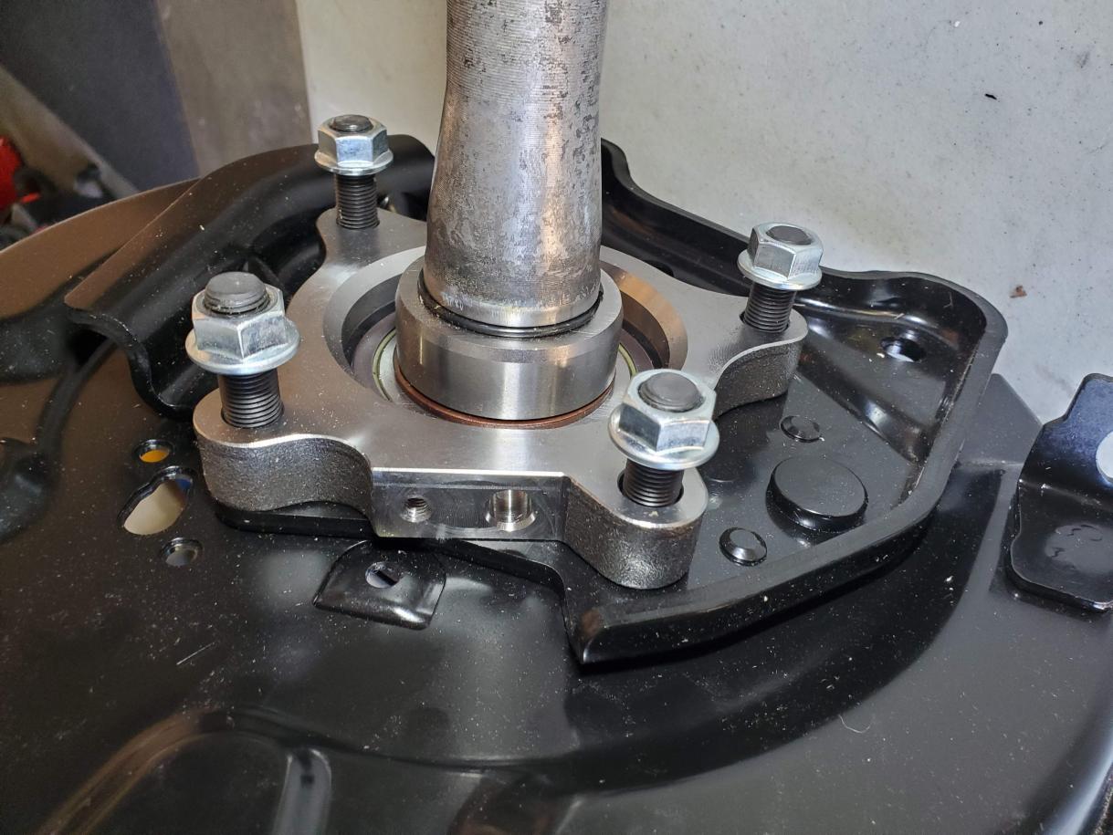

New Dorman Axle pics i case anyone is interested
Seems identical.
Only part not supplied was the top screw/washer that the 2 parking Brake springs attach to. Just moved it over.
The Orig has a serrated look to the back of the bearing which I assumed was used by the Antilock/ATRAC. But the new one is smooth.
No issue or CEL so I assume its OK.
No way to tell the bearing manufacturer that I can see.
Comes with a new seal and ORing, but I used Toyota seal.
Was very well boxed and came in 2 days from Rock Auto
