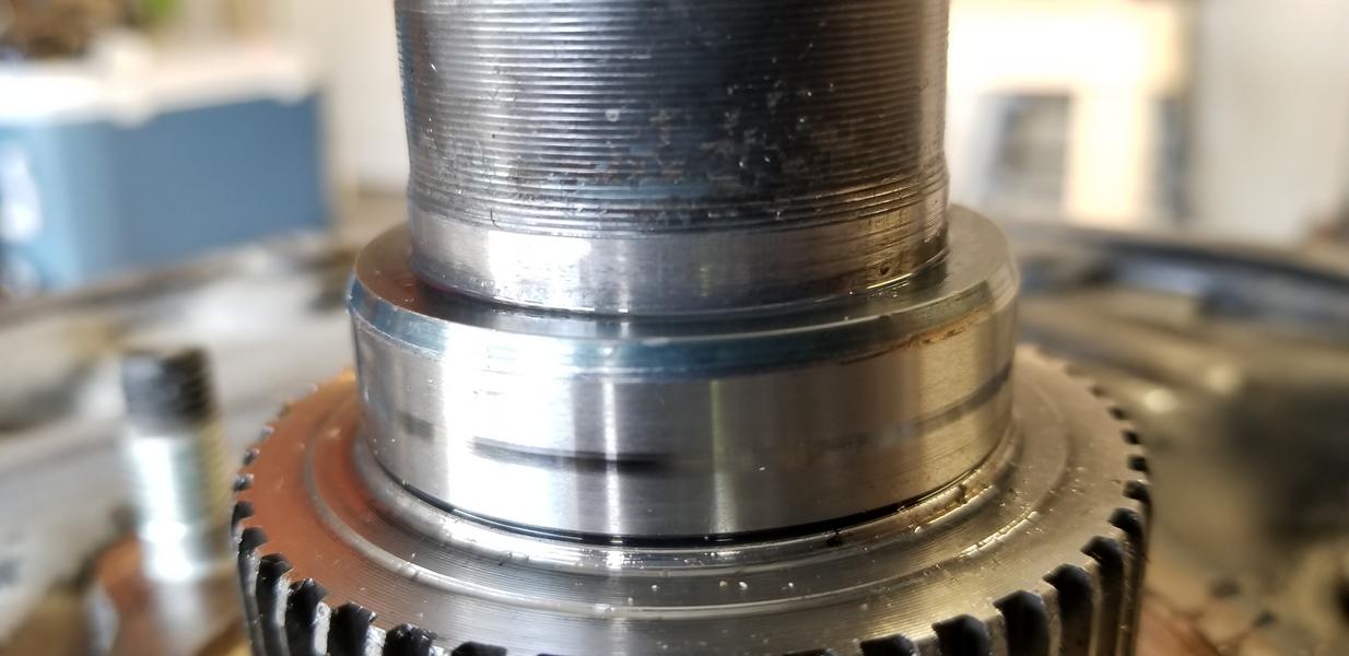

Well Buddy Ol' Pal, I agree that the key is to get the seal riding correctly on the retainer. If you can do that, you are doing pretty good. Anyone that knows how to measure albiet with a tape or calipers can do it,hell how about marking before you remove it.
Sounds like you're saying lots of seals will work just as good as the Toyota OEM seals and this is where I disagree. The seal was redesigned in such a way to be much more pliable than the original seal design. Aftermarket seals DO NOT have the same pliability built in.Why did they change the "pliability" if there is no lateral movement and the seal rides in position on the retainer ? It was a change in composition that benefits and wiping surface.
The reason for the flipped retainer is to get a better mating of the axle seal with the inner retainer without risking having the retainer rub the inside of the axle housing. what's the bevel for? Due to the re-designed seal, the seal lip now sits 2mm for inboard and thus you have to either readjust the inner retainer 2mm more inboard If it's worked for 100k plus at factory settings why?(risking the retainer rubbing inside the axle housing), or you can flip it like we show in the video and leave the retainer in the same OEM spot on the axle (5mm or polished axle showing above the retainer). Because the bevel is 2mm wide,OEM yes some aftermarket not so much when you flip the retainer putting the bevel facing the ABS tone ring, you compensate for the seal re-design because now the seal doesn't have to first push past the bevel to get up onto the polished shoulder of the retainer. WTF? The bevel should only help the seal "get up" ( it's beveled )
302k on original seals. Ok Bro. I bet you've never pulled your ABS sensors and taken a peak into your axle housing. Pretty much every one of these rigs that has 200k+ miles on it will have some leaking.misguided I've seen it on way too many rigs.How many Bud? The gear oil hasn't found it's way into the brakes yet or is leaking out making a mess on the inside of your wheels but I guarantee your seals are leaking at that mileage.You'd lose Pull your tires off, pull out the ABS sensors,No need to pull tires and then rotate the axles while looking at the ABS tone ring. If there's gear oil in that cavity, the ABS tone ring works like a water wheel picking up the gear oil that has accumulated in there. I'd bet Big Big money you have quite a bit of gear oil in there that's slowly washing away the grease inside your bearings. You assumed it's a third gen

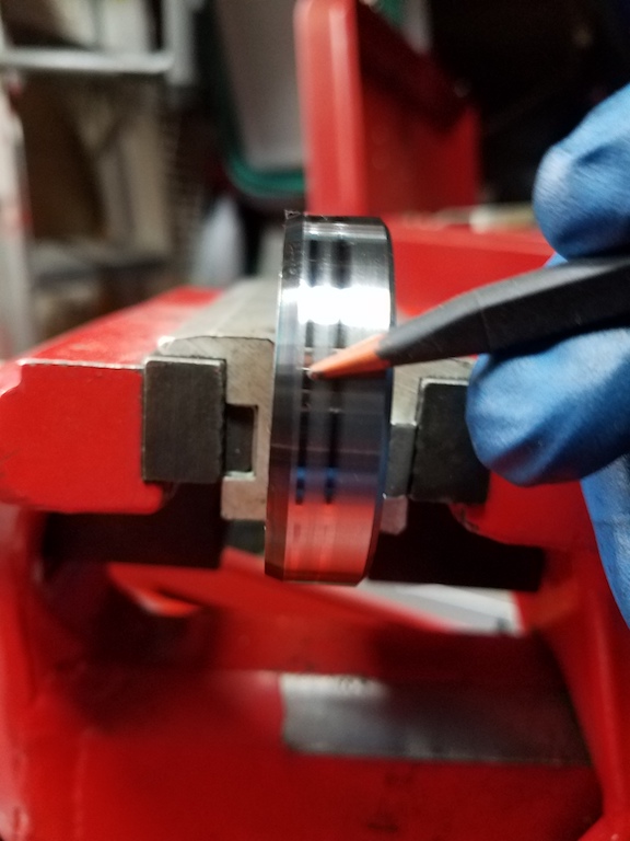

Hey A-Hole,
You obviously show a picture of an axle that was pulled from a rear end with an original OEM seal. The reason why I know this is because, to answer you question, I've performed this job at least 12 times. The amount of polished shoulder showing above the inner retainer coupled with the witness mark on the retainer lets me know this.
Now, here's a retainer I pulled from somebody's rig. Look at the two witness marks on the retainer. The one more in the center is where the original seal was riding. The one close to the bevel is where the newly designed Toyota seal was riding without any change of position of the inner retainer. The person thought they would be good with just replacing the seal and doing nothing else. But, this person's axle seal was leaking after the replacement. Why? Well, it looks like the seal was safely riding on the polished shoulder of the retainer, but maybe with some axle movement from a worn bearing, the seal was able to sometimes ride on the non-polished bevel and it caused the seal to fail prematurely.
To respond to another one of your a-hole comments, we agree that the newly designed Toyota seal now sits 2mm more inboard. We either have to adjust the inner retainer more inboard to compensate for that, but now we will be risking having the inner retainer rub the inside of the axle housing. So, using the Dr. Coffee method, we flip the retainer. Yes a-hole, we know the bevel is there to facilitate the insertion or the axle into the seal. But, since the newly designed seal is so PLIABLE, you DO NOT risk damaging the seal by flipping it's orientation. Get one of the new seals in your hands and insert a retainer into the seal. There is so much flexibility in this seal, you would have to try to damage it when inserting the axle. Our "Flip Method" allows us to keep the retainer in the original position (5mm of polished shoulder exposed above the retainer) on the axle, allows a good mating with the seal and eliminates any concern with having the retainer rub the inside of the axle housing. Ok, pay attention a-hole. The bevel is 2mm wide. The seal now sits 2mm more inboard. BECAUSE the seal DOES NOT First have to push past the 2mm bevel to get up onto the polished shoulder of the retainer, we gain back the 2mm lost with the seal re-design. Do you understand the purpose for the flip method now a-hole?
Dealerships, Private Shops and Machine Shops screw up this job on a regular basis. You don't have to like the way we do it a-hole. The way we do it works. It's worked for all 12 jobs I've done. That's 24 axles imbecile in case you couldn't do the simple math.
I'm not going to give you any more of my attention. I've ran into a-holes like you in person, on our channel and on this forum. Luckily dickheads like you are an exception to the rule. So, go ahead with your final a-hole comment because I know one's coming. Have a nice life a-hole.
