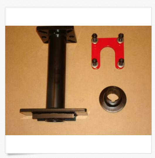

Does anyone have the bearing puller tool I can rent?
