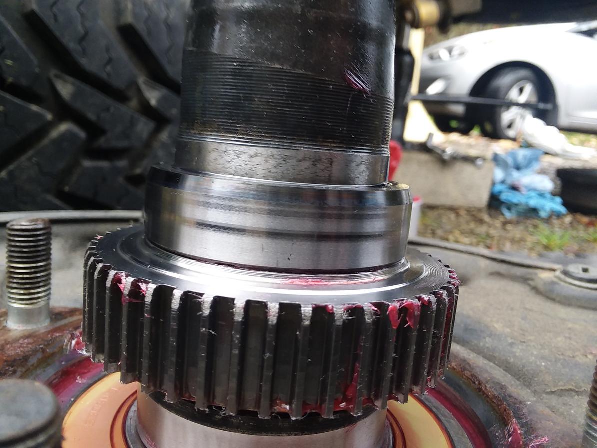

I decided to cancel the appointment and do another seal replacement leaving it out a mm or two instead of pressing it in fully. This is my last attempt before I find a cliff.
The picture shows the old original seal mark and new redesigned seal mark above it (which was leaking).
