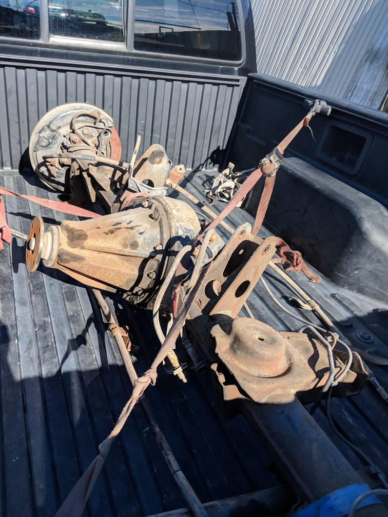

In the meantime. Picked up this 2003 junker. Seals look decent. I'm working on removing the rust with some gel shit I picked up (that seems to be working well) and I'll paint it with high temp auto paint before I swap everything over.
Yeah, you're already invested in the 8", doesn't necessarily make sense to swap. But for those of us still on stock gears the extra ~1500 for a dramatically stronger axle makes sense. You should be able to sell yours to help cover the cost (~1500 for the third?) but still expensive.
