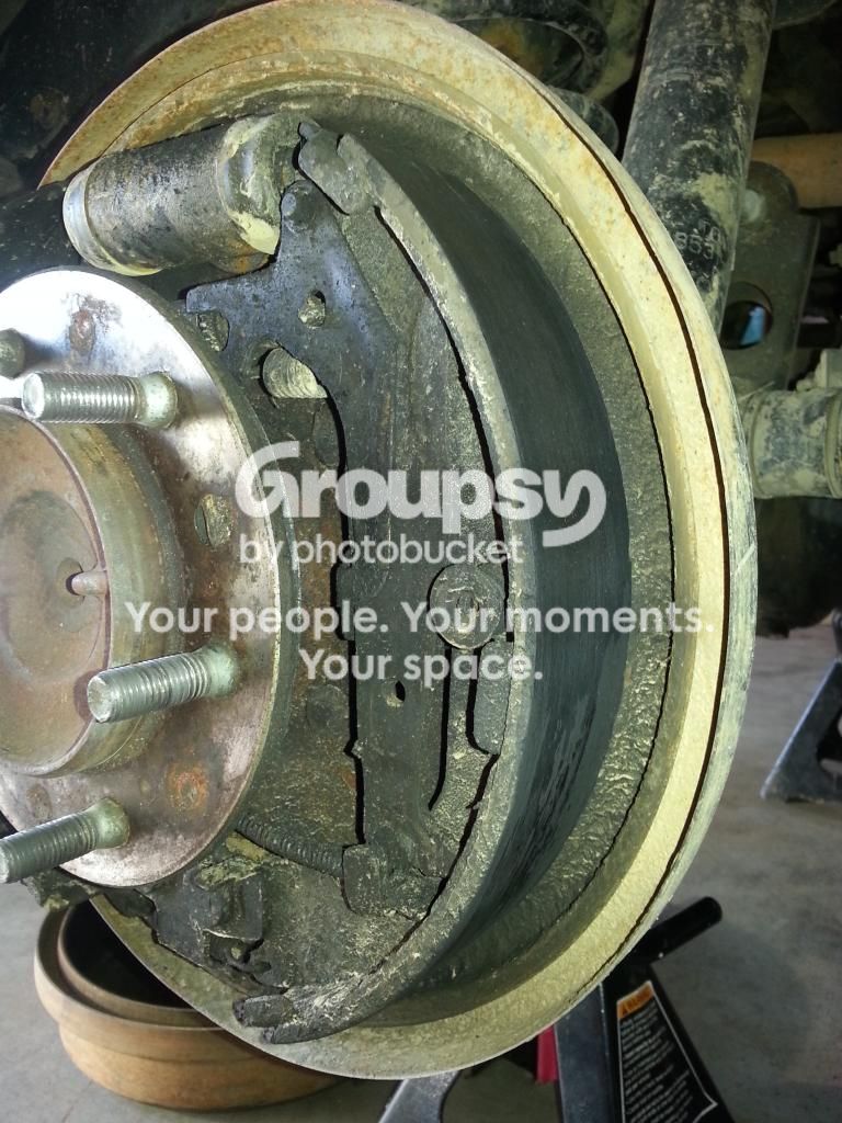

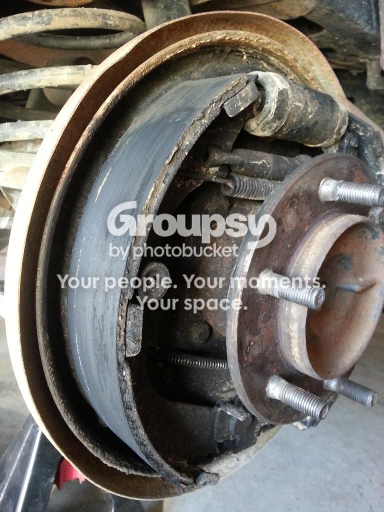

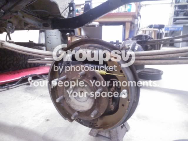

Well, got it jacked up and pulled the rear wheels and drums off. This is what it looks like in there!
Planning on going through it all this week...
I had an 87 Toyota 4x4 pickup, ran it for more than 340K before I sold it and kept the shoes clean and adjusted never had to replace. I would clean the heck out of the assembly make sure there is no gear lube leaking from the seals, no brake fluid leaking from the WC, hit the shoes with some sand paper to remove any glaze, adjust and go. There appears to be plenty of mtl remaining on the shoe.
Really?! Think so huh?! That would save me a lot of money!
I bought a 87 4 runner with 222K and when I checked the rear brakes they were worn about the same as your rig. I took a water hose to the assembly made sure everything was clean, lubed the shoe contact points, took sand paper to the shoes and drum contact surface and adjusted the emergency brake and then the self adjuster. Good to go for another 40K.
Well, I've already bought new shoes and a spring kit, so I think I'll just throw those on, clean, grease, and adjust everything else, then go from there. Drums definitely don't need replaced, they are still good, and it doesn't look like there is any leaking going on from the WCs...
