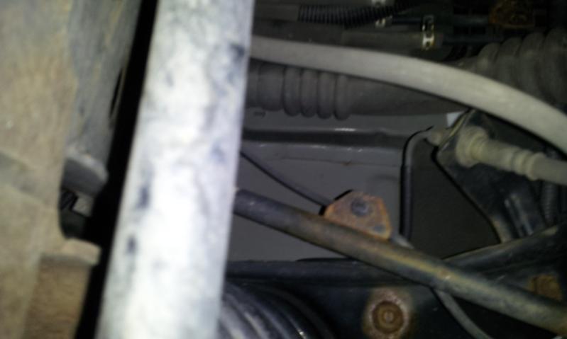

The first picture is the passenger side and the spring is the passenger side spring and that's the bracket I was talking about.

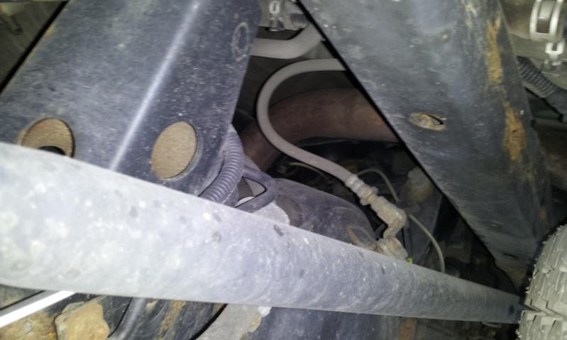

I don't remember the second picture.

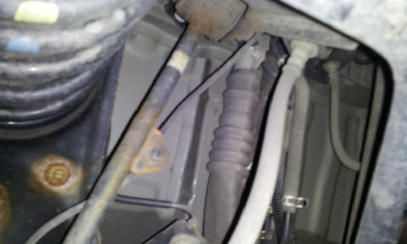

The third is from the drivers side and you can see the 2 lines. The one closest to the camera is the drivers side and I think I can do that one but the other...
