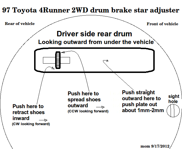

So I just tested it on flat pavement to see how freely the wheels spin with rear in the air. I could barely spin the rear wheels. Obviously parking brake was not engaged :)
I then adjusted each side about 5-6 clicks inward (spinning the inside gear downward) and tried again. The diagram below is by user "mom" - I found it helpful.
Now I can easily move the wheels but they don't spin for more than 1-2 seconds so some minor resistance. We'll see what it's like after I drive a bit.

Brian,
If you have the ability to push the push plate off the star adjuster (I use a long 90 degree pick), then with your spoon or flat blade stubby screwdriver, spin the adjuster until you literally feel the shoes pressing up against the drum, then barely back off.
Drive around, find a hill, then pull up the parking brake. Five clicks should get it to stop.
