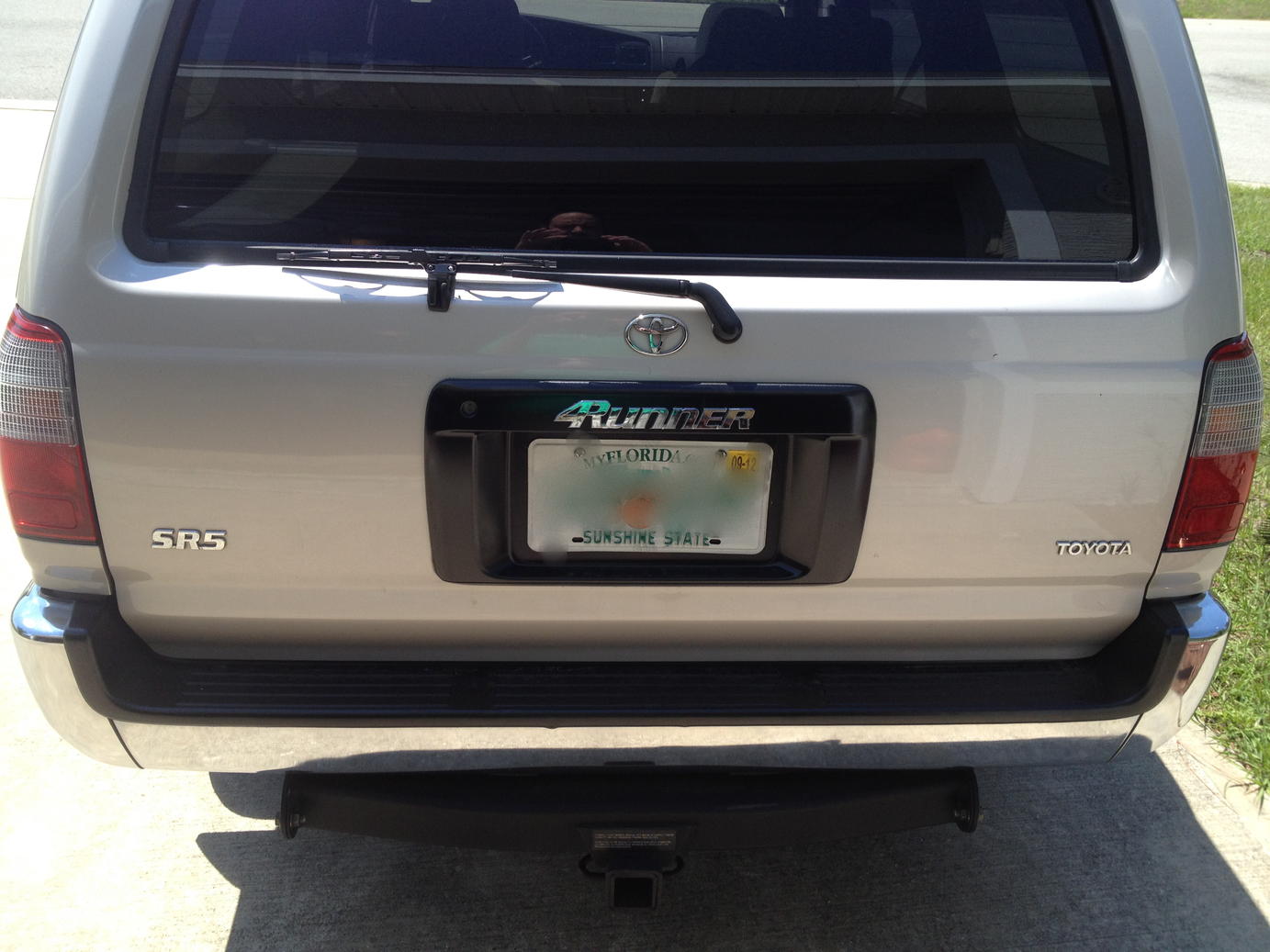

Yup. Rust O Leum Paint for Plastic worked awesome. Cleaned it with simple green then 3 coats of gloss black and it looks brand new, still perfect now after 2 years of duty. Climb under with a pair of 90 degree needle nose and a small pry bar/flathead screwdriver and pop the clips, think there was about 8-10 of them. I used the same paint on my front valence, rear license plate surround, and SR5 flares and mud flaps. Love the stuff.
I used Rustoleum satin black on the roof racks, the cowl, and the bumper cover over a year ago and they still look like the day I painted them. :artist2:
