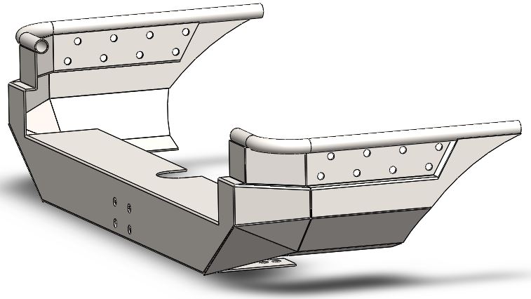

Should be starting the rear early next week. We are kind of getting away from the non-cut style for the rear on the 4th gen. Not completely throwing it out but for now we are going to do one that requires cutting the stock plastic bumper cover.

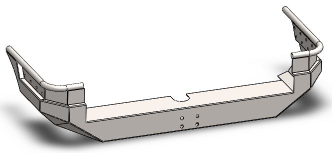

Not sure how I feel about the rounded tops yet, but I'm excited to see how it looks in the flesh.

We are trying to be creative and attractive. The tubing is just an idea that we thought about throwing on for two reasons. There is nowhere to tie the corner into the truck so the corner will be a touch weak in our opinion. Other reason is aesthetics. It might look weird once on so we might not do it.

Without getting into details, it is extremely hard to make this bumper not look bulky and not be heavy. The body behind the bumper cover hangs down a lot in the corners and the bumper cover itself goes all the way up under the tail light. It is a tough bumper to design and build for sure. The 5th gen T4R is just as bad. The last gen to make a good, lightweight bumper that isn't huge was the 3rd gen.
Hmm... I actually kind of like the tubular idea. The main thing I see a lot of the aftermarket bumpers fail to do is take into account the roundness of the 4th gen. It's not an easy thing to design for and many end up looking too clunky because they try and make tons of facets to "blend" in. But the tubular top gives it a slight melding of the more angular lower section as it meets the more rounded sheetmetal.
Additionally, while I know this would be a huge pain; if you made the door opening a bit more rounded so that it matched the rear hatch it'd also seem less "clunky". I realize that's a lot of R&D/Manufacturing Effort for an aesthetic thing; but it goes a long way to making it "fit" the vehicle better.
There was a member who had a blacksmith roll his inner edges on his bumper and it looked beautiful.
Design looks great! Can't wait to see the outcome...

I think Mobtown would benefit by fabricating a bumper that is fully bolt on. Eliminating any cutting or extensive disassembly would make it easier for enthusiasts to buy and install their bumper.
I do like the idea of cutting the crossmember but I could see most potential customers being put off by the idea and looking elsewhere. Same goes for the sides coming up to the taillights.
Personally I would be all for cutting the crossmember as long as it's structural integrity can be duplicated or improved during the bumper install. If theres a way to make it aesthetically flow with the rest of the back end without cutting the bumper and crossmember then I say go for it MobTown.
