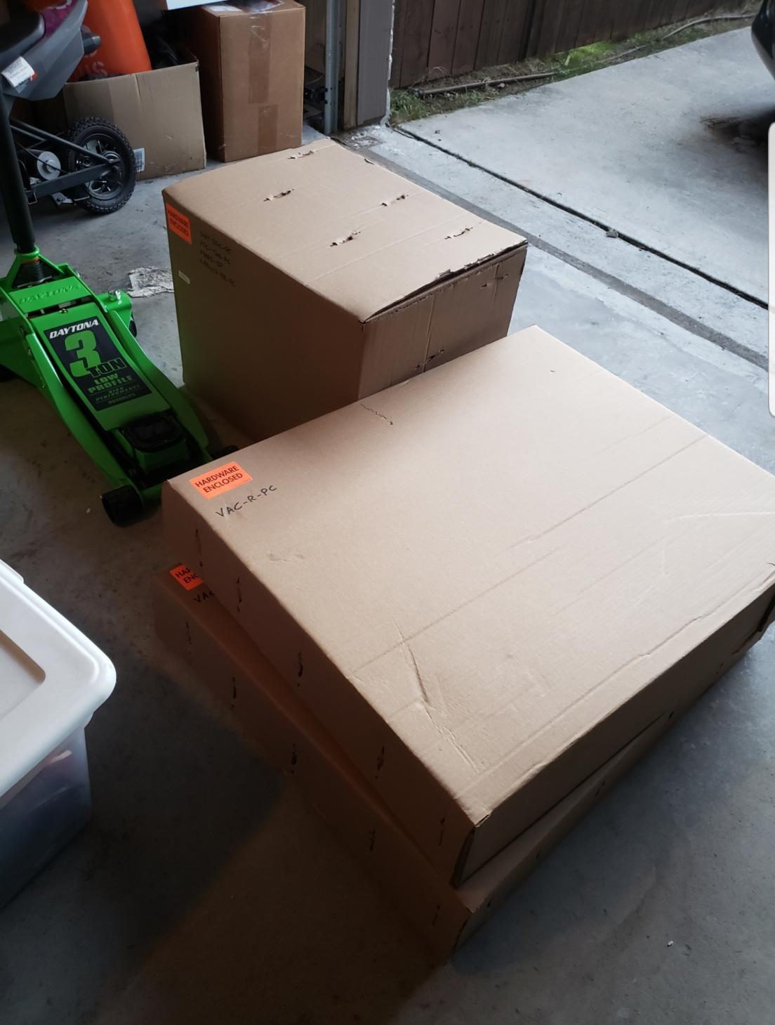

Mine is out for delivery today. That said, its at a business I work with so I'll have to make a couple of trips to get it to the house. I might/SHOULD have it all to the house this afternoon.
mine is as well! weather is going to be great here over the next few days. perfect time to install

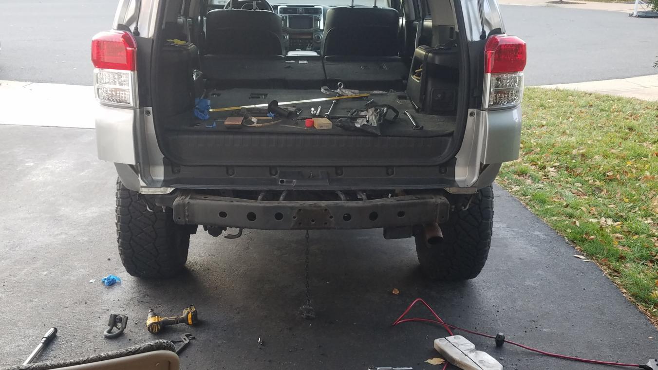

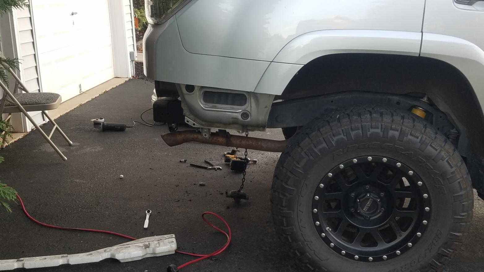

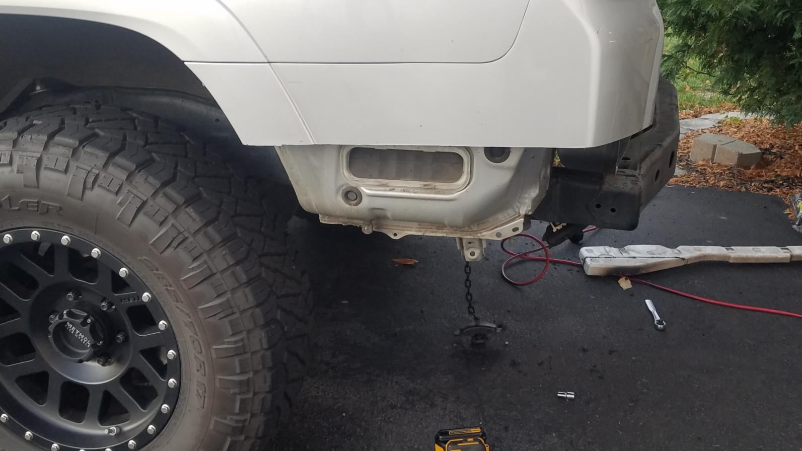

3 hours and this is where I stand. Bumper and swing out are assembled, but not together, and ready to install. Had to run to Lowes and get some flat black paint to paint over the silver pieces under the bumper cover.

Did you take out the rear proximity sensors prior to cutting off the. Bumper or disconnect afterward?

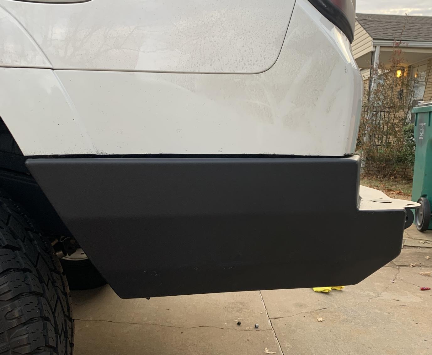

Looks like the cut turned out great. Was your measurement 5” from the side body line like in the video? What was your measurement at the rear to connect the side cut (under the taillights)?

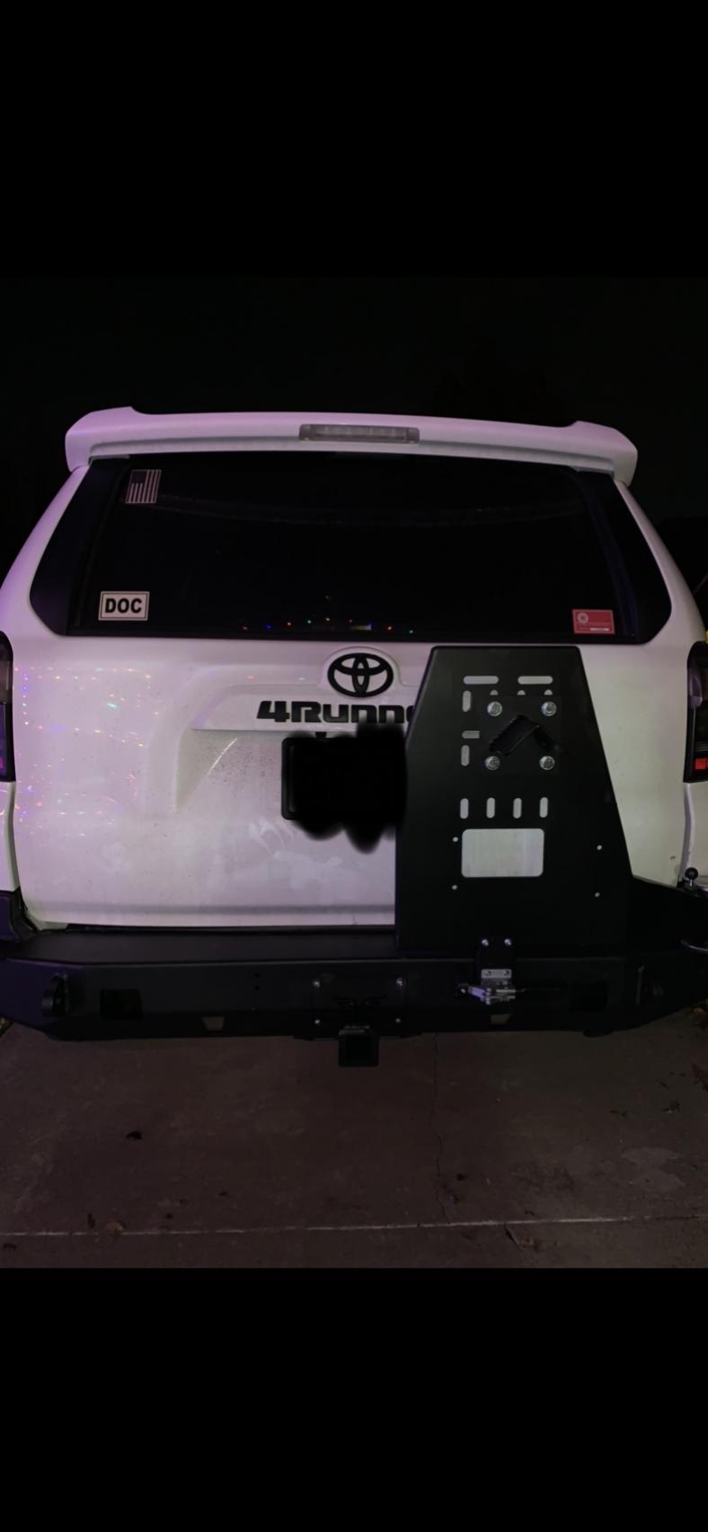

Couldn’t finish the mounting of tire because I do not have an impact wrench. Sorry for the terrible photo. Great product and was packaged very well.

I used 5" on both sides and 8.75" down from under the tail lights since my limited has a more curved transition from the bumper cover under the tail lights to the lower bumper cover.
I have a few little imperfections that were my fault with the angle grinder and the cut off wheel but you can't really tell until you are up close. I think I'm going to throw on some black pinch weld cover to make it look a little better.
Overall I'm about 98% done with only 2 issues I'm going to try and remedy tomorrow.
1. The 2 large bolts underneath that go into the frame will not reach and there is a gap the same thickness as the spacer used on the front. I had to use the spacer in the front to keep the bumper level with the body cuts as per the instructions. I'm going to pick up some longer 10.9 bolts tomorrow with some thick washers to full in the gap as a temporary fix. I'm hoping that Victory can send me two spacers the same thickness as the front spacers with holes that match up to those large bolts so it has a clean finished look rather than some washers.
2. My Method Race wheels take a small diameter spline lug nuts so a socket won't fit to use the lug nuts provided with the universal carrier. Likewise, the lugs used for the universal carrier don't appear to be the same thread pattern as the stock 4runner lugs since my lugs won't thread on so I can't simply steal a couple lug nuts until I can gets some spares enroute. Looks like I'll have to buy spline nuts the same size as the lugs on the carrier, or buy new press in lugs that have the stock 4runner pattern. I would rather keep the thread patterns all the same in case I ever need a quick replacement lug for the truck.
Victory's CS has been great so I'm thinking they will help me out somehow.
