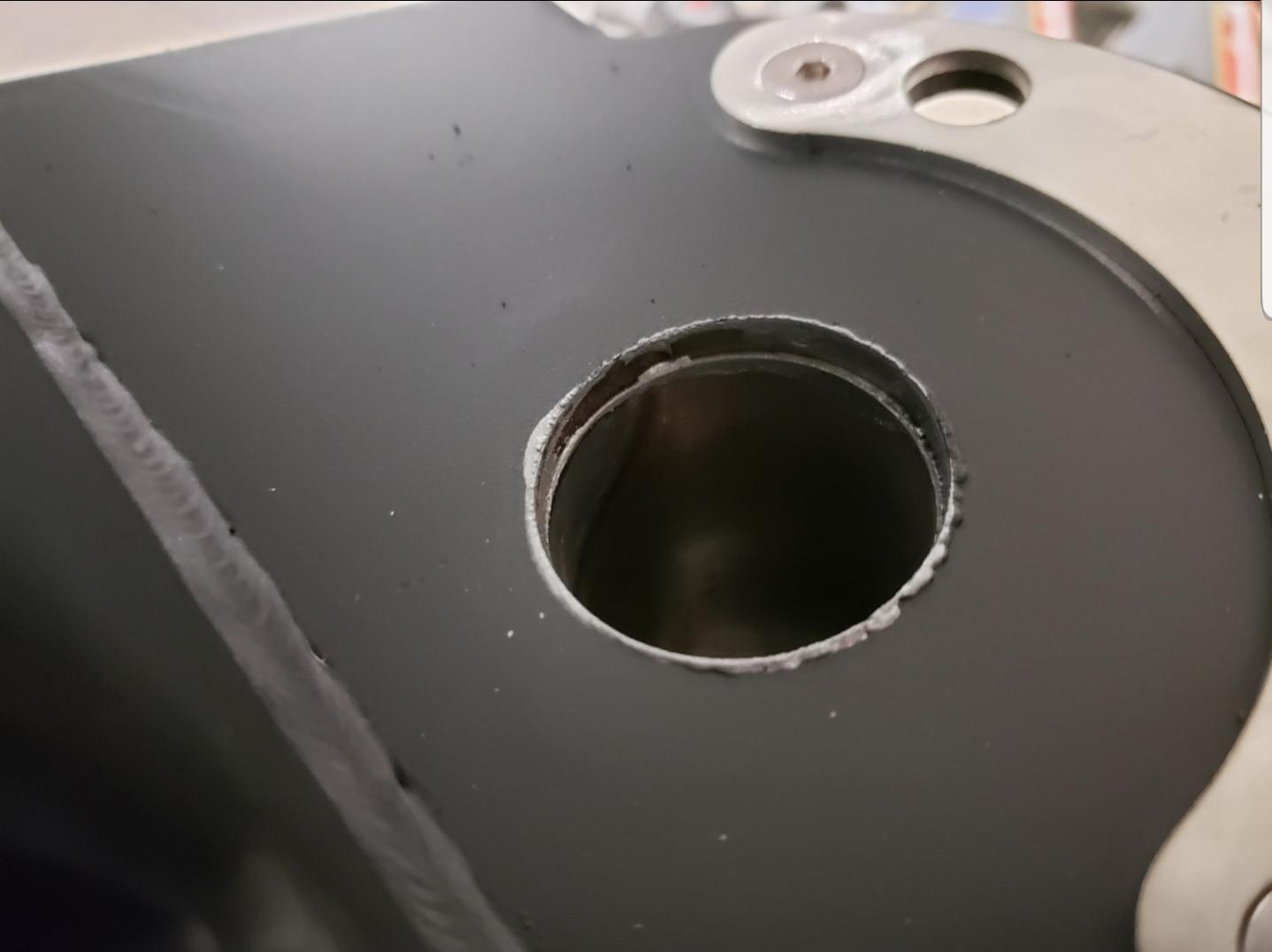

Started the install this morning. The large bolts that bolt to the frame (2 on both sides) were too short just like [MENTION=314855]Off-Camber[/MENTION] so I had to go to a specialty hardware store to buy them. They didn't have the bolts at Home Depot or Lowes. Tried to install the spindle into the right side bumper and it would not go in. Tired to put the same spindle in the left and went right in. Looked at the cavity closely and noticed the top hole did not match the cavity. And just realized that I didn't receive the tire carrier as well. P by maybe a millimeter. Pretty disappointed right now. Too late to contact CS right now so will have to wait till tomorrow to contact them.

It looks like you tried to clean it up by re-drilling to match the spindle opening. Maybe use a Dremel grinder to smooth out the side to get them better aligned.

That's silver colored anti seize. I don't have the tools or the know how to do all that. As soon as I couldn't get the spindle to go in, I stopped.
