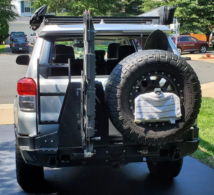

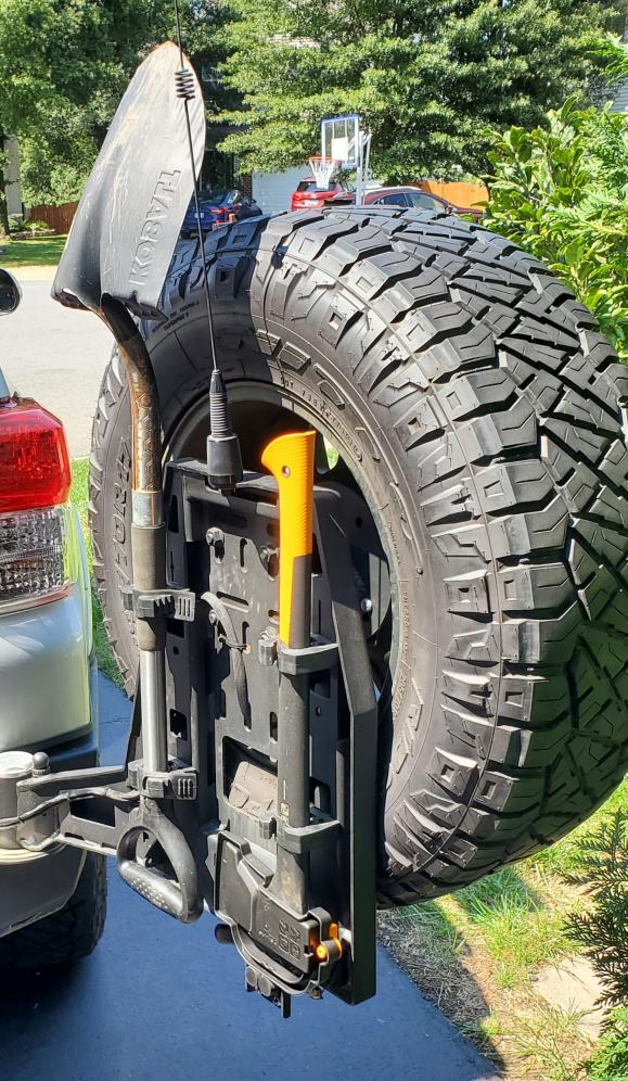

Rear end update. If anyone is looking for a nice place to mount a shovel and or Axe, etc it will fit behind the swing out with quickfists. Just drill a couple of holes and throw some black spray paint on there for prevent rust.
Left side carrier will eventually get 2 x 3gal roto pax and 2x 2gal water pax. Or 2 x 3 gal rotopax and then 1 more 2 gal rotopax and 1 x 2 gal water pax.

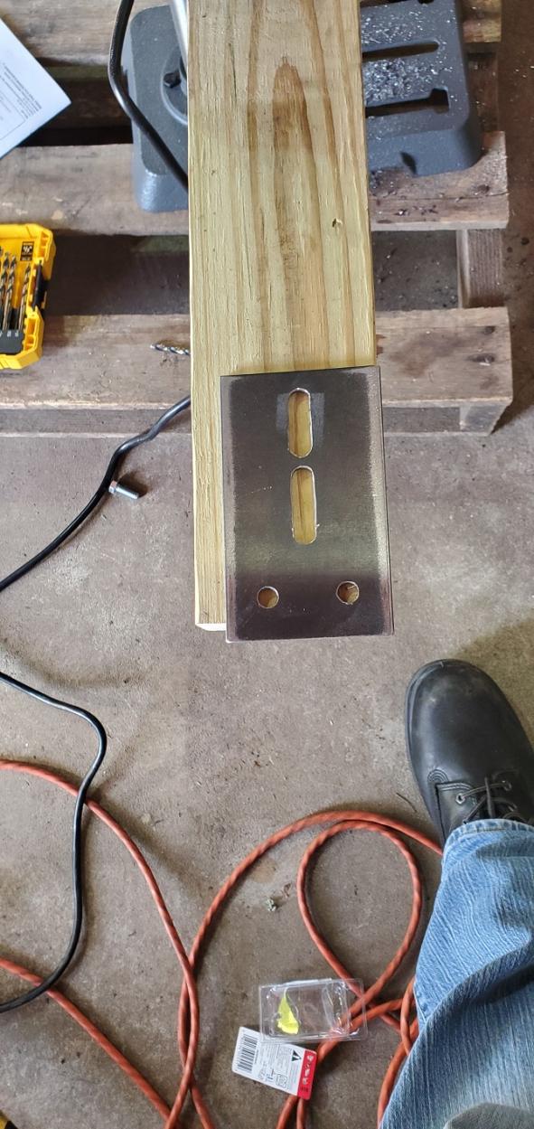

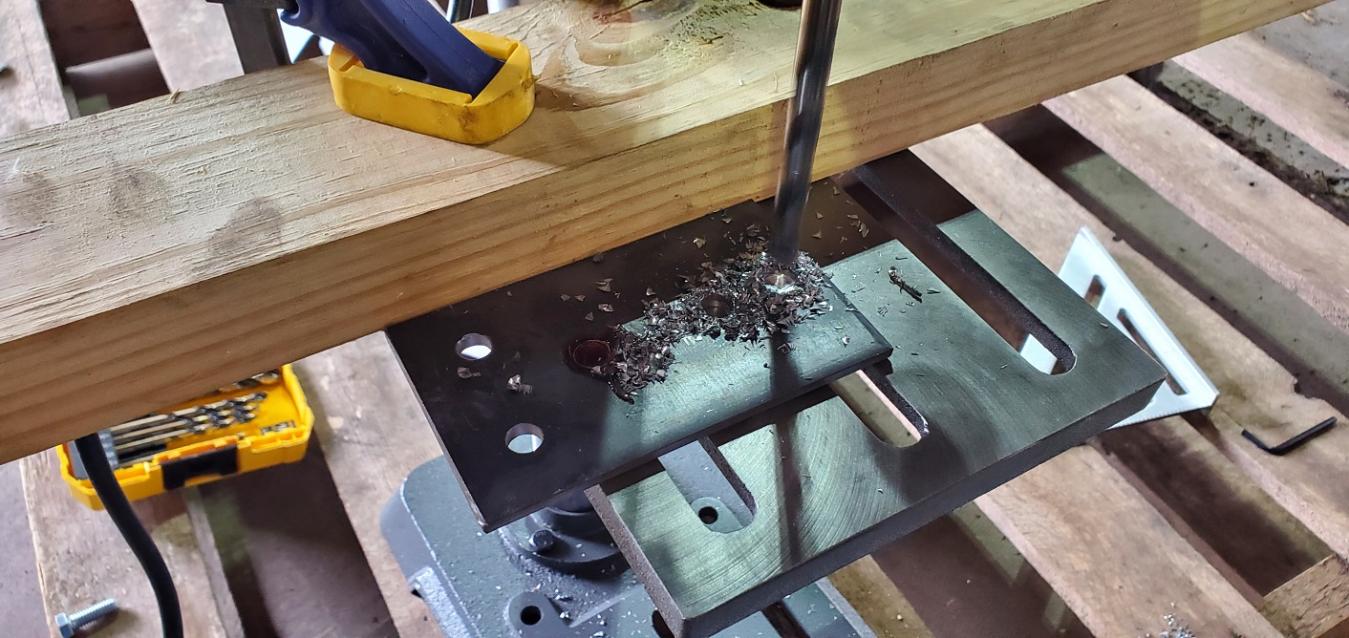

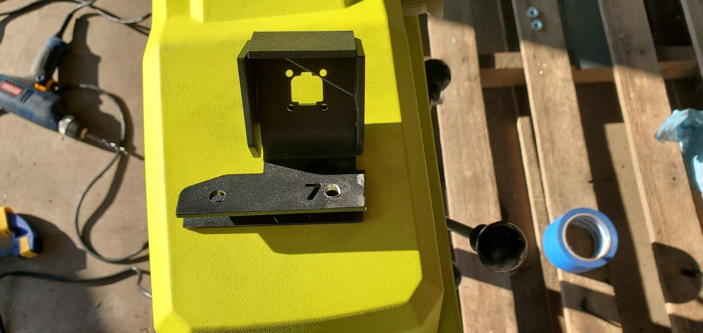

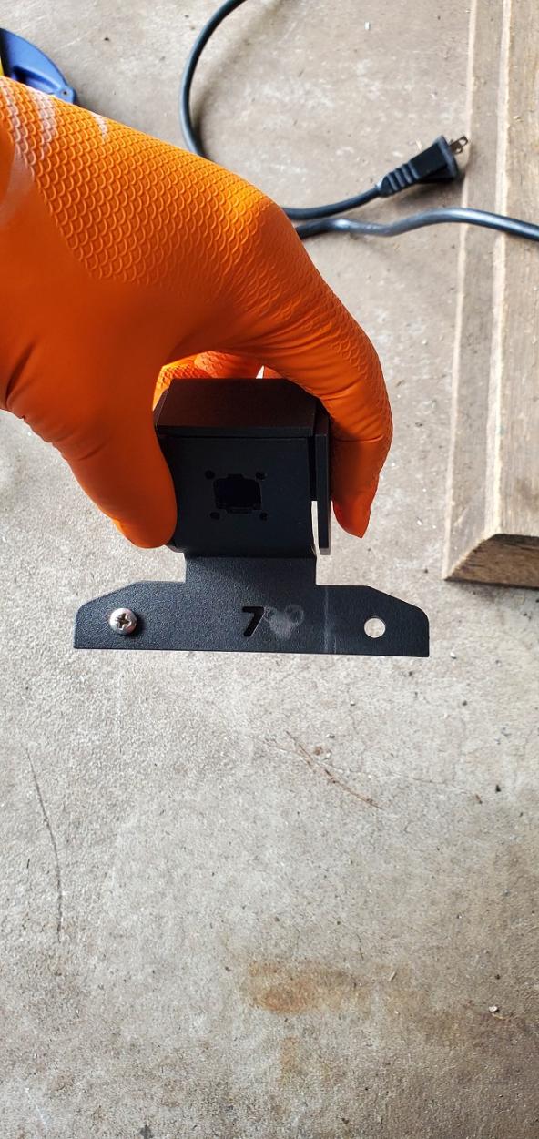

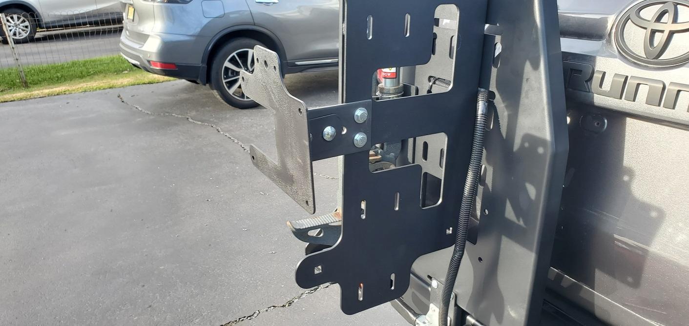

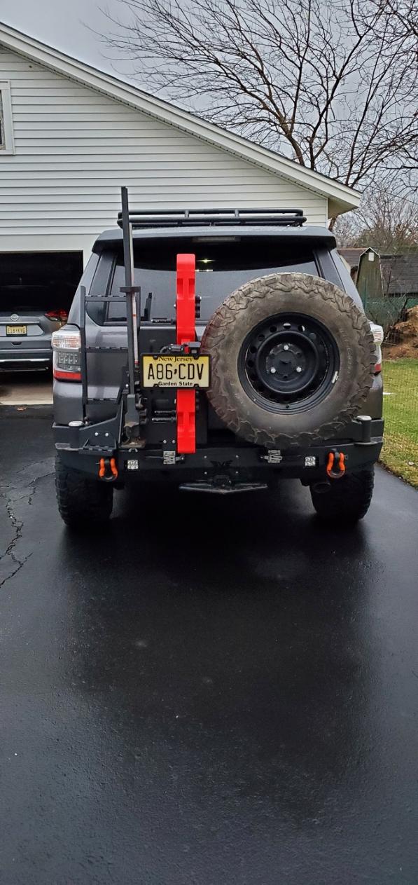

made a custom bracket with some home depot steel and a drill press & 2 cycle engine oil. it also puts the camera in damn near the stock location.
Bought another company's license plate mount, but could have made my own.
I also flipped the bolts and used weld nuts so it would not rub in the gas can. my switch them out for rivet nuts.

I figure with rivnuts and a good drill, I can mount the plate almost anywhere I need to. Still haven't decided if I'm going to get a driver side swing-out or just stick with the pass side only for the tire, since I'mnot sure if overlanding is in my near future and most trail runs can be done without much need for extra gas if you don't head out low (nice thing about the modular design, I can add on if I need it). Suppose I can always wire in an after-market camera instead of the factory unit if I have to, since the runner I'm buying has it displaying on an aftermarket HU screen anyway. I do need to find out if the HU can run 2 cameras since a spotting camera up front is a good idea for crawling in a vehicle I'm not yet used to.
