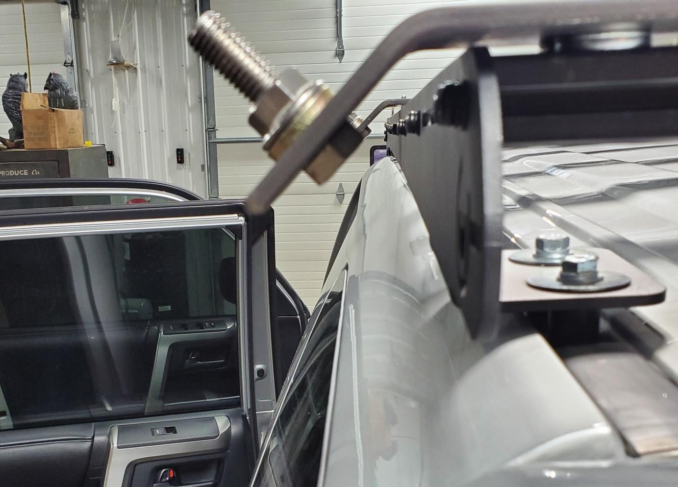

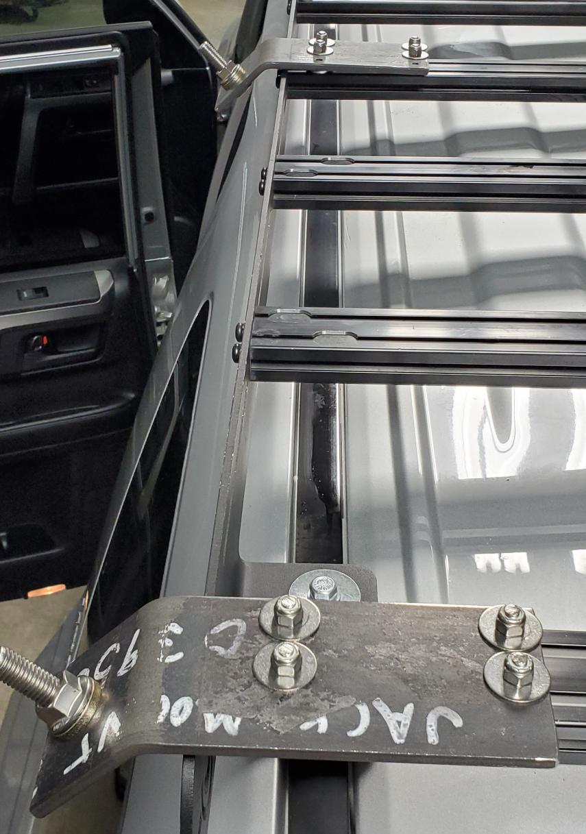

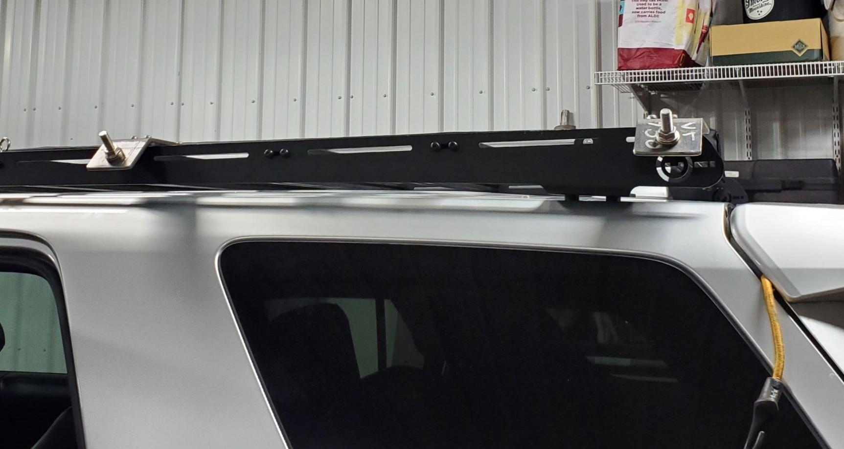

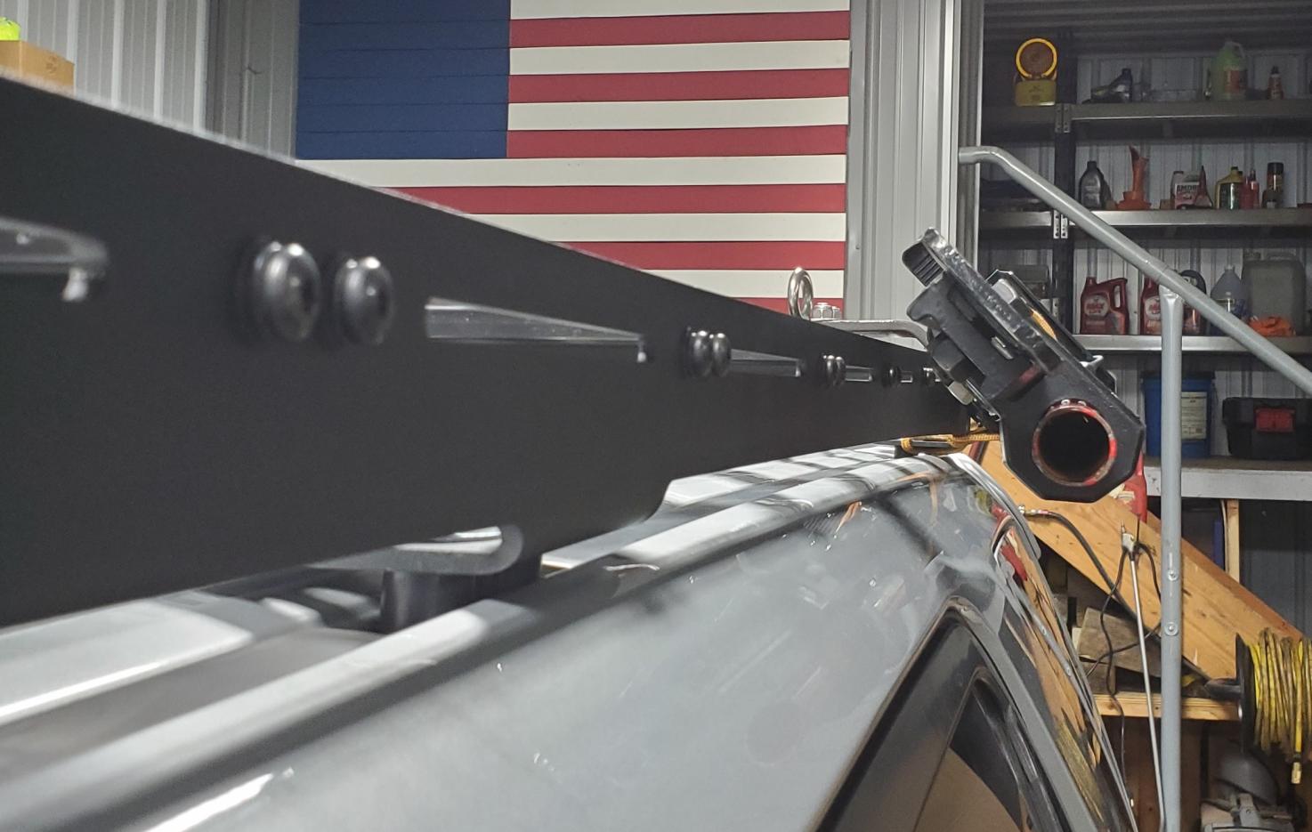

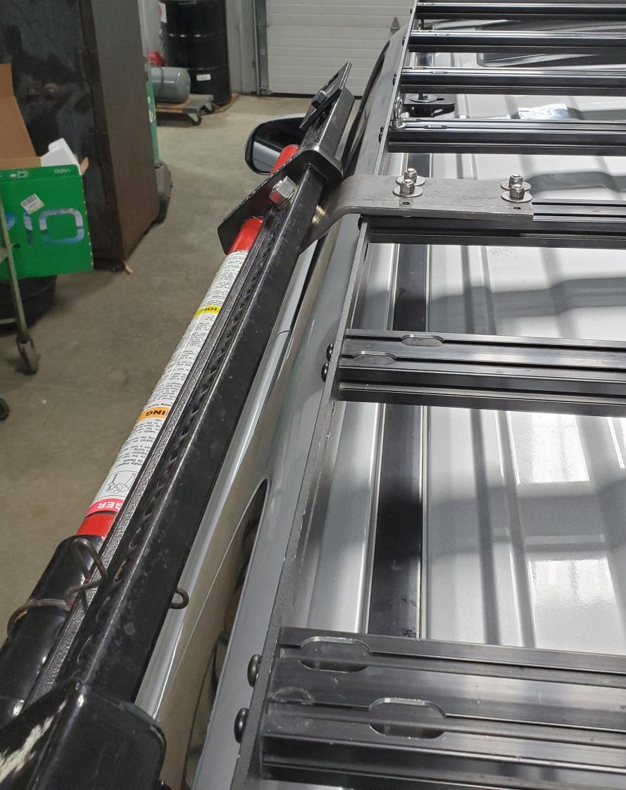

No. I never did as far as mounting it to the bumper. I went to a local metal fab shop and had 1/4" steel plate bent at a 45* angle so I can hang it off the side of the prinsu rack. That way I can still mount up the RTT.
On the left swing out I'm going to use the vertical rotopax mount. Plan on stacking 2 4gal pax on the inside (center) portion of the victory mount and bolting a propane tank mount to the outside of the victory mount. Maxtrax I'll be mounting on the roof rack horizontally in front of the RTT.
I'll attach a couple if pics of the jack mount once I get to better service area.

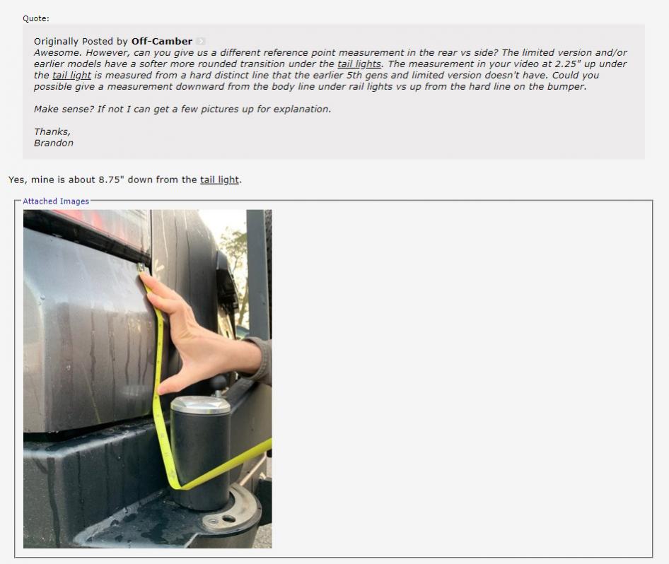

I'm in need of a rear bumper :( (and a little body work :( )
Because I messed up part of my bumper cover, I'm looking for a good used bumper to cut up for one of the Victory 4x4 bumpers. I have found a Limited bumper that's Barcelona red. What's the difference in the areas that are left after cutting? Anyone have a Limited with the Victory bumper and could post a pic or two of the interface with the bumper.
Thanks in advance
Stephen
Those who have Limiteds can also chime in here, but several have installed them on a Limited! I believe the only real difference is the hard body line we used to measure the cut from in one area. So here is the measurement down from the taillight instead. We have also had someone buy a new rear bumper cover (unfinished) and left it matte black. It looks good! Either way should work fine.

Hopefully these all come through. Both mounts are at Zink Primer/Powder Coat now. should have them back in a week. I have 1 more mounts I'm going to have to make when I switch out for a 60" hi lift instead of 48".
Brandon

I saw what I needed - thanks :) Just curious if there's a difference if I use a Limited cover after cutting. They look pretty much the same.
