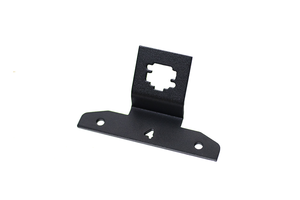

A new camera mount will ship out today or tomorrow! Thank you for your help! From now on, the camera relocation will come with both styles of the bracket. We will also ship them to those that already ordered and need the older style.

Is that an overlay of new vs old mount pattern or a multi mount pattern?

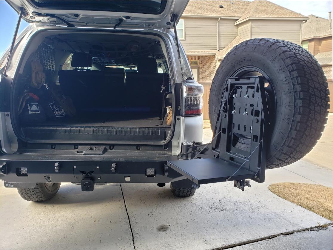

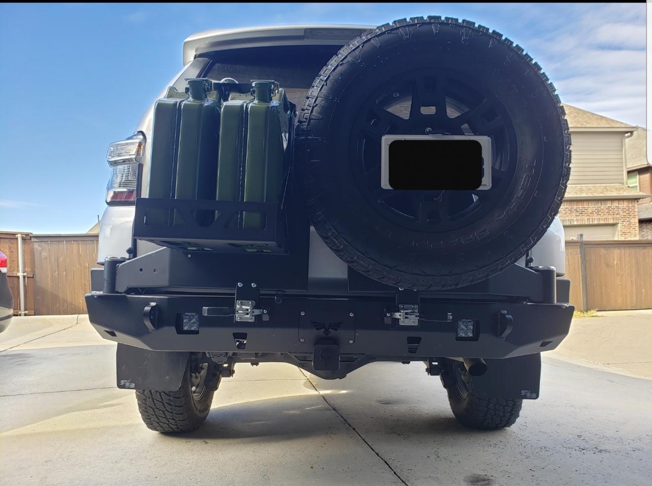

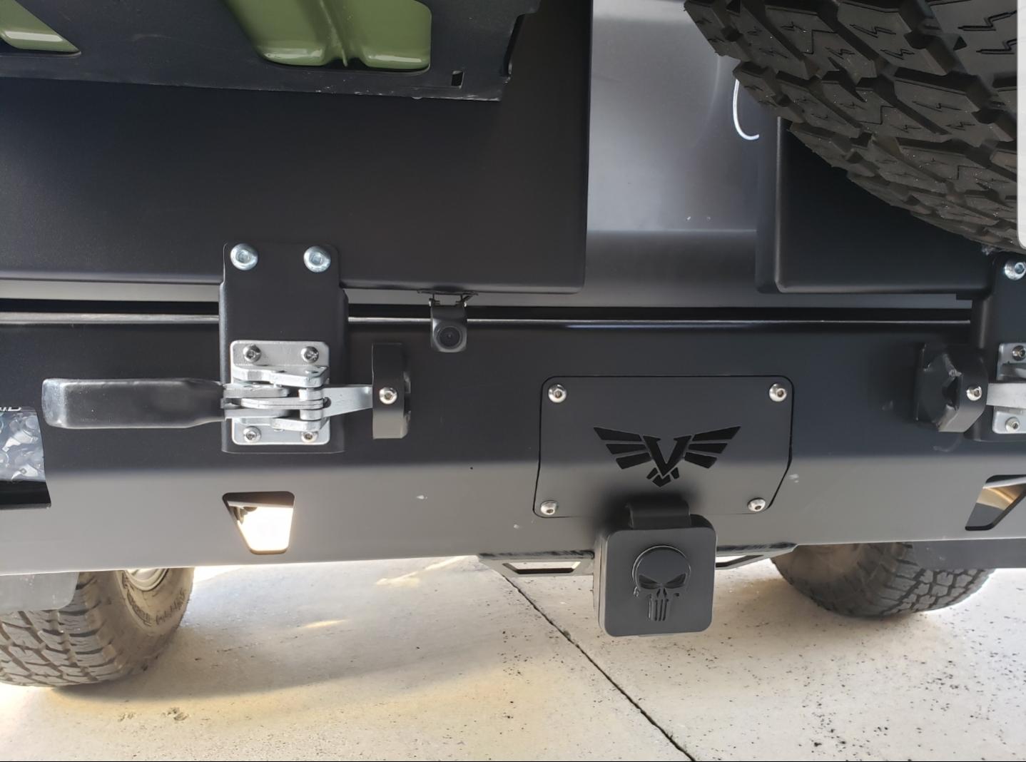

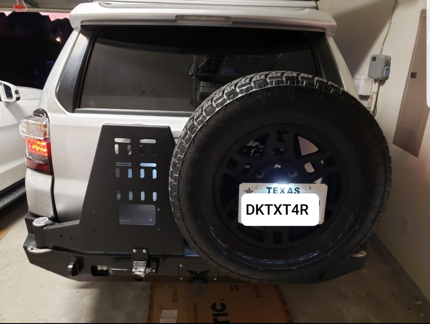

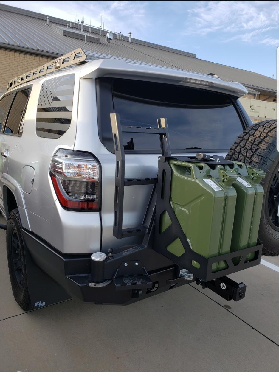

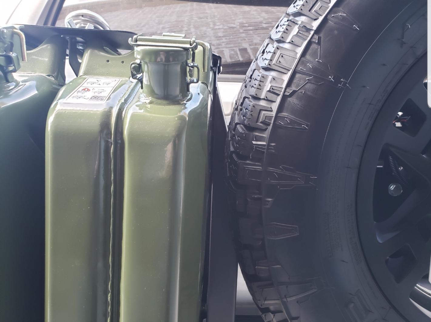

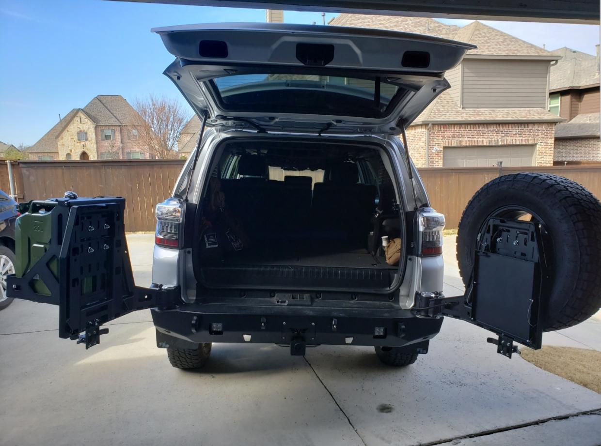

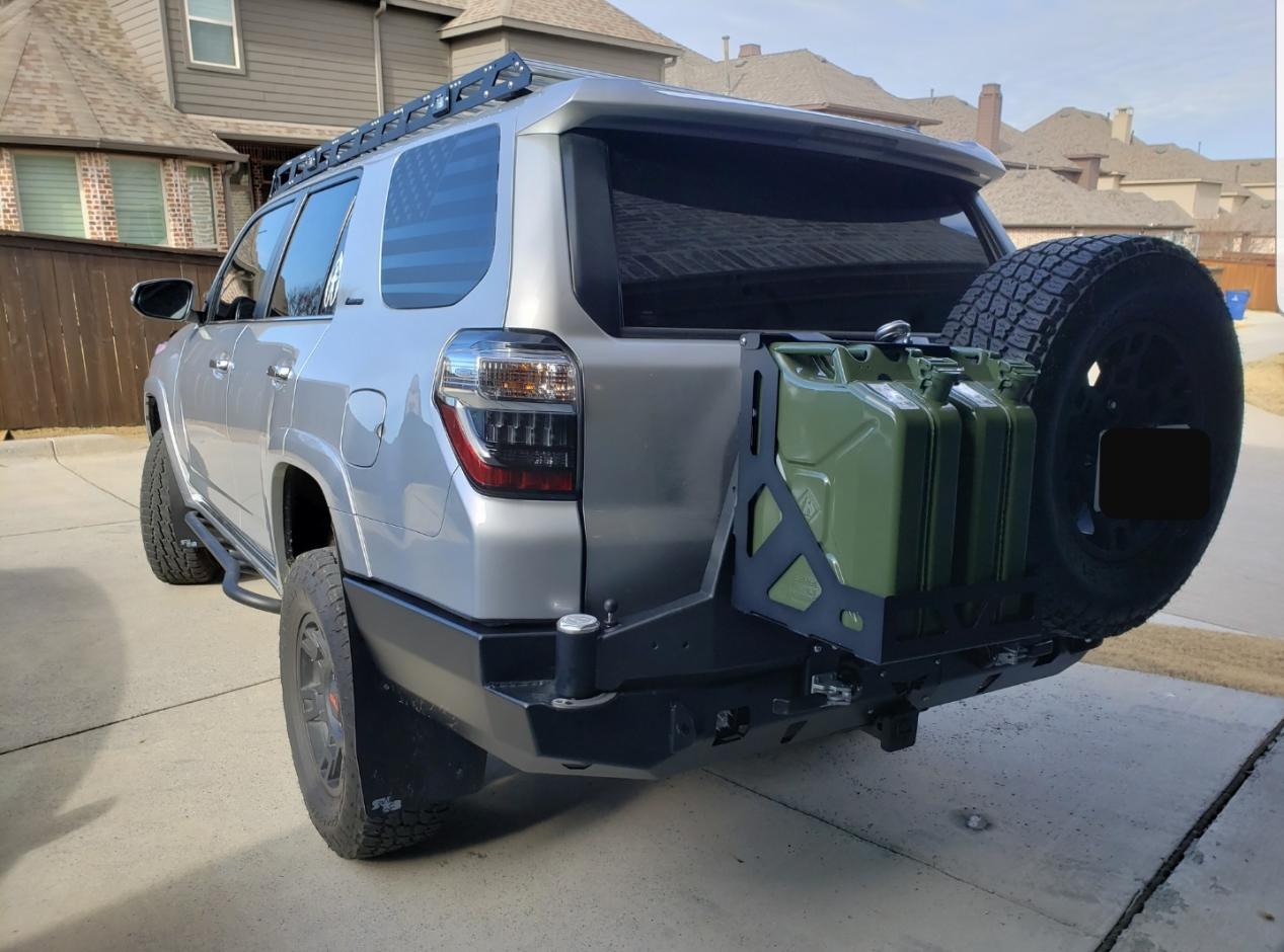

Here's my setup. Once the ladder comes in and I install it, bumper will be done...or so I think. Running 265 70 17 tires and there is about an inch from the dual jerry can holder. These were installed the furthest apart from each other so larger tires may be an issue. I didn't mess with the stock backup camera because I had previously ran wiring for an aftermarket backup camera.

Nice man congrats on the rear setup. What aftermarket backup camera/bumper mount did you use? Looks really nice

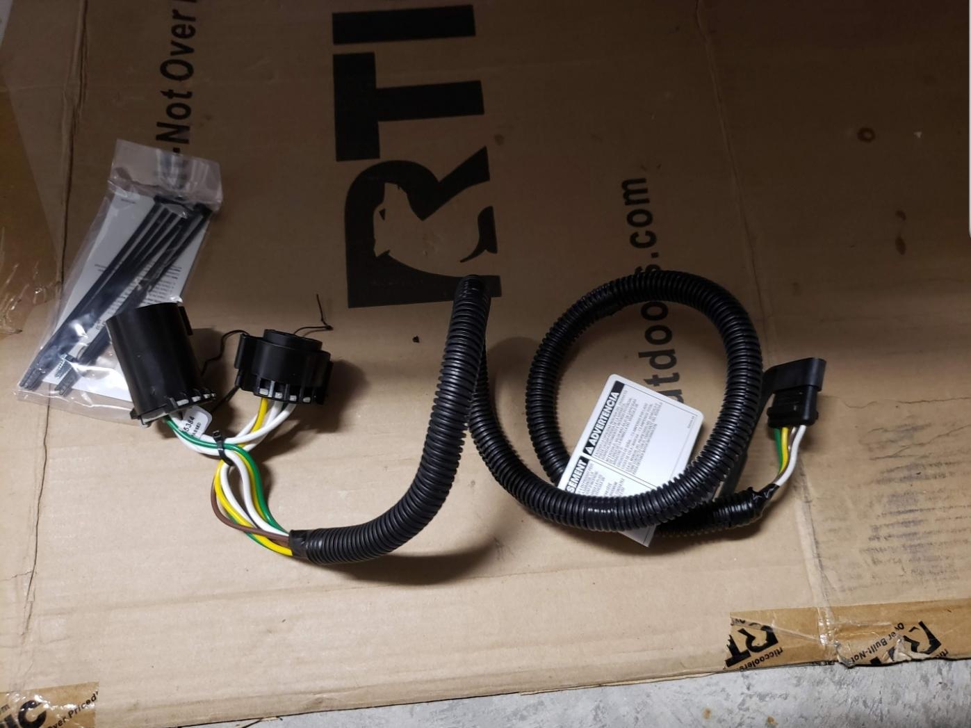

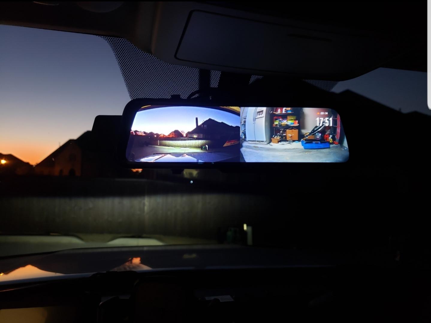

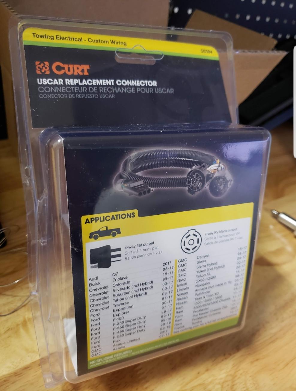

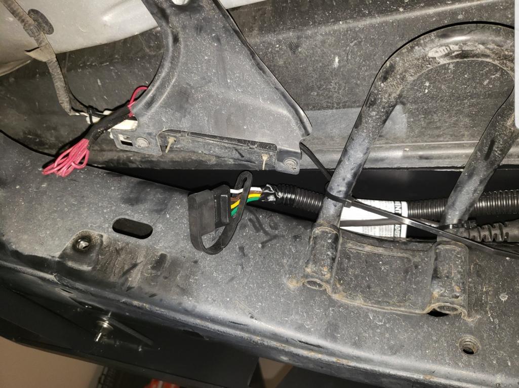

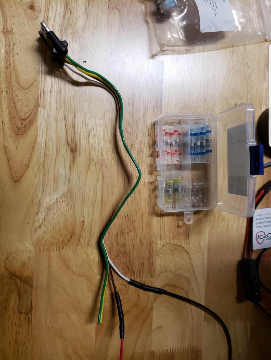

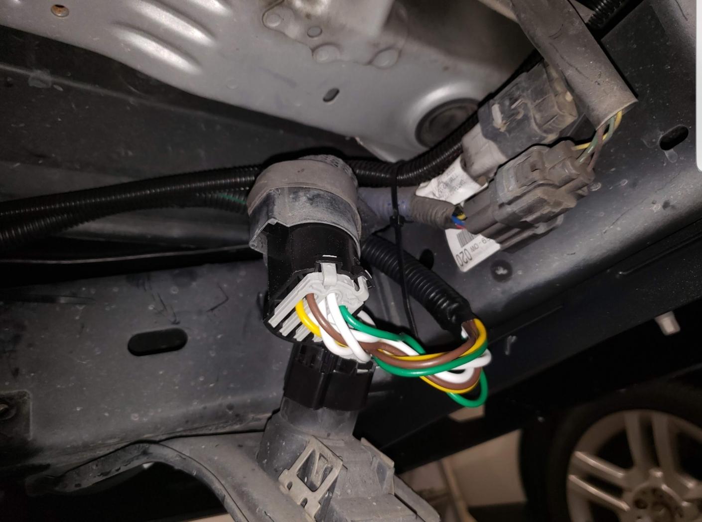

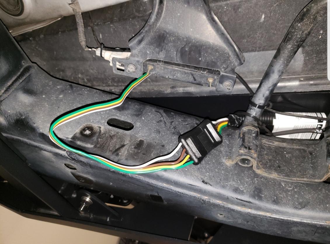

For the license plate light, I didn't want to tap into stock wiring so I purchase a Curt USCAR 7 pin T harness with 4 pin. This way, I can still use 7 pin or 4 pin from the stock location. I ran the new 4 pin wiring from the harness to the rear passenger side. I then connected the LP light to a quick disconnect 2 pin plug female end and the male end to male end of the 4 pin connector. Brown to red and white to black on the LP light. Taped off the yellow and green wire since it wasn't used. I've had a few drinks and I'm typing this on my phone so I'll post pics to illustrate. Just showing how I did it.

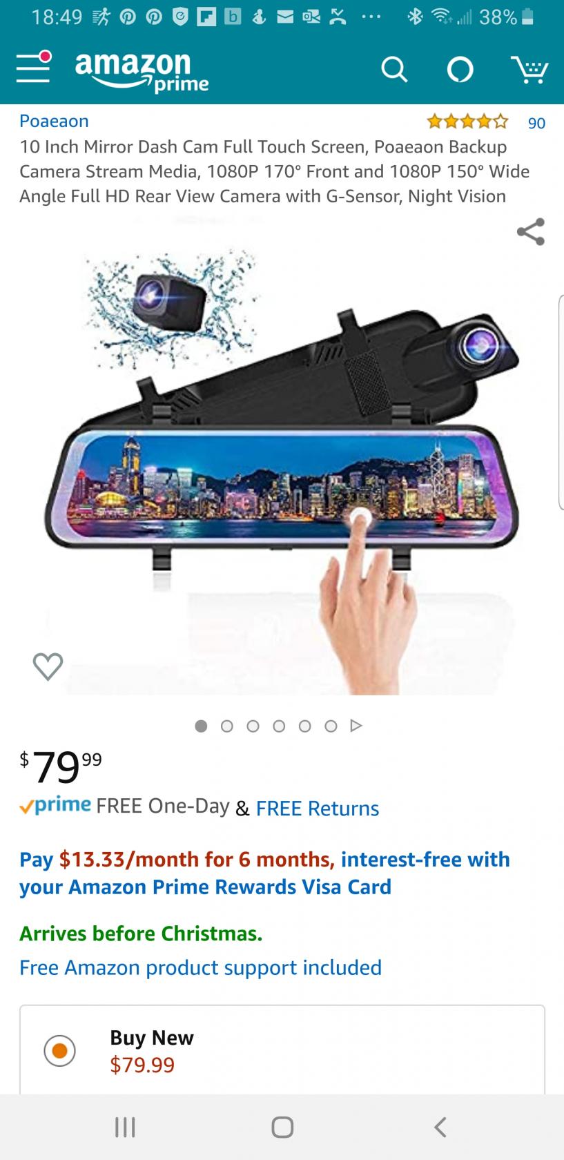

This is what I'm using. Acts as dash and rear cam.

“Nice cans” dk. It looks great with the dual green Jerry’s on there. I just got my bumper this week and the weather is a bit too snowy for the install. Going to have to wait until better weather.
Hmmm. Any plans for the hi-lift jack carrier? Earlier on in this thread it was confirmed that the jack carrier would work with the dual jerry can set up (post 129). Looking at your pics, I'm trying to figure out where it would go since that is the route I took with mine.
In all honesty, looking at the pictures of the high lift mount on the Victory website and looking at my setup, I don't see how they would be compatible.
