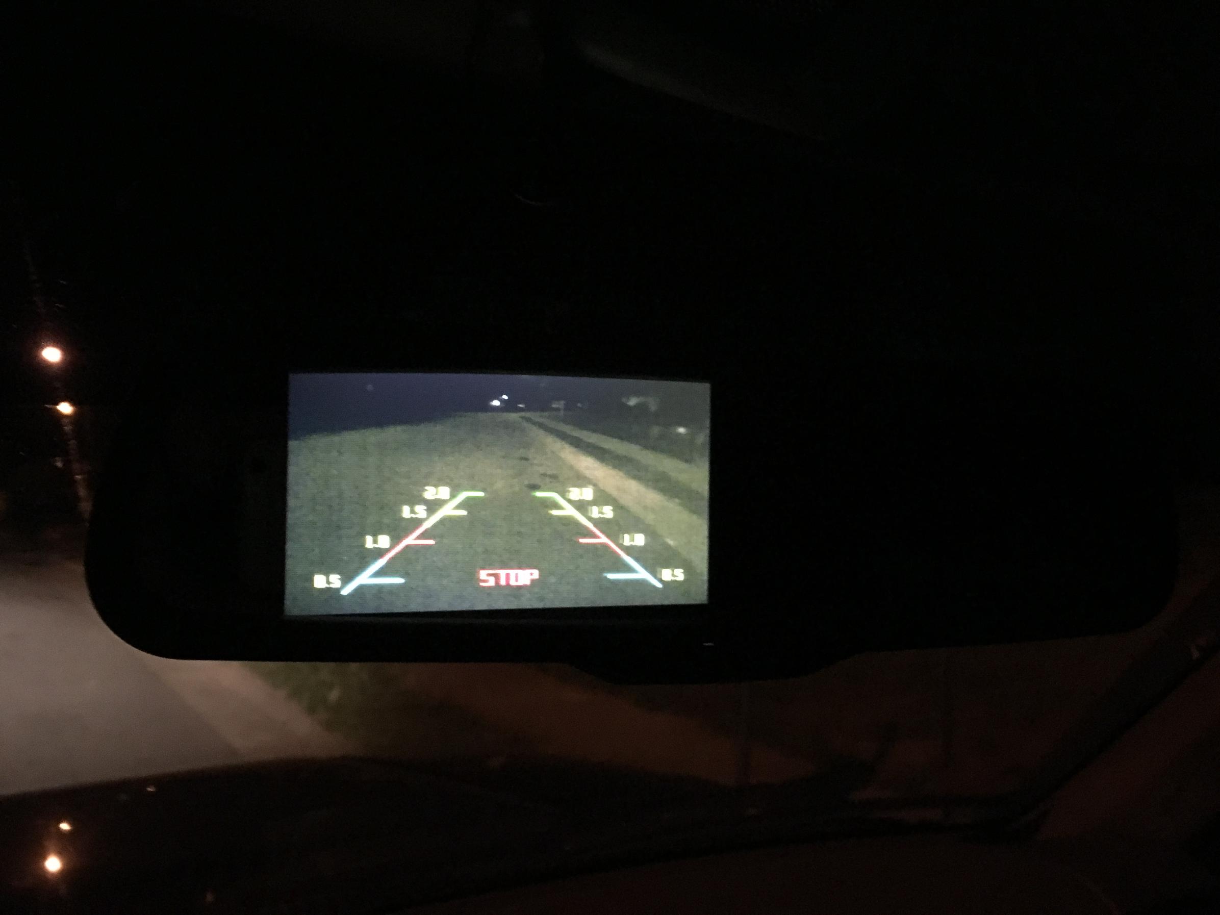

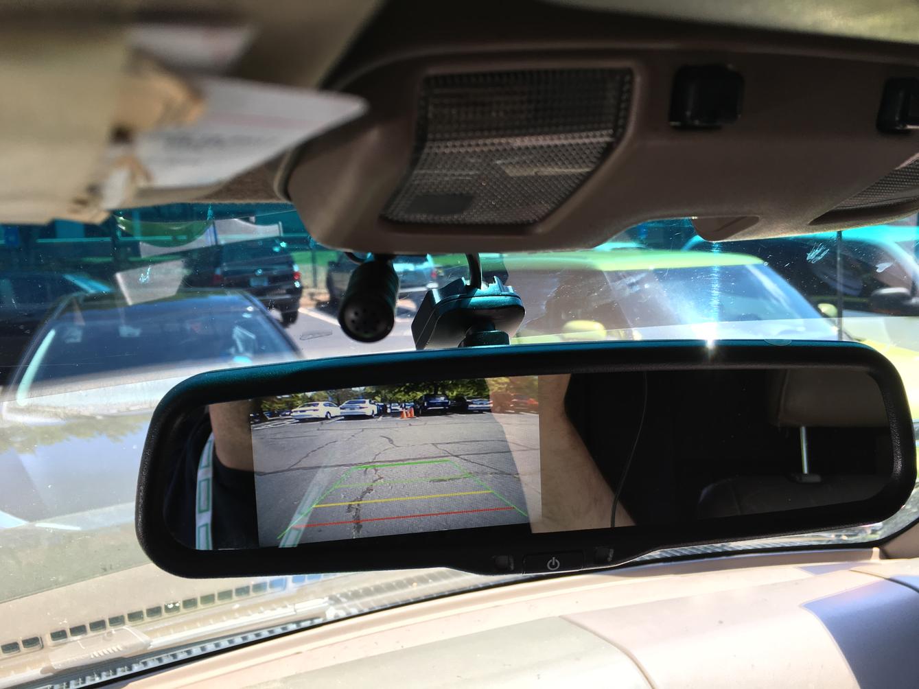

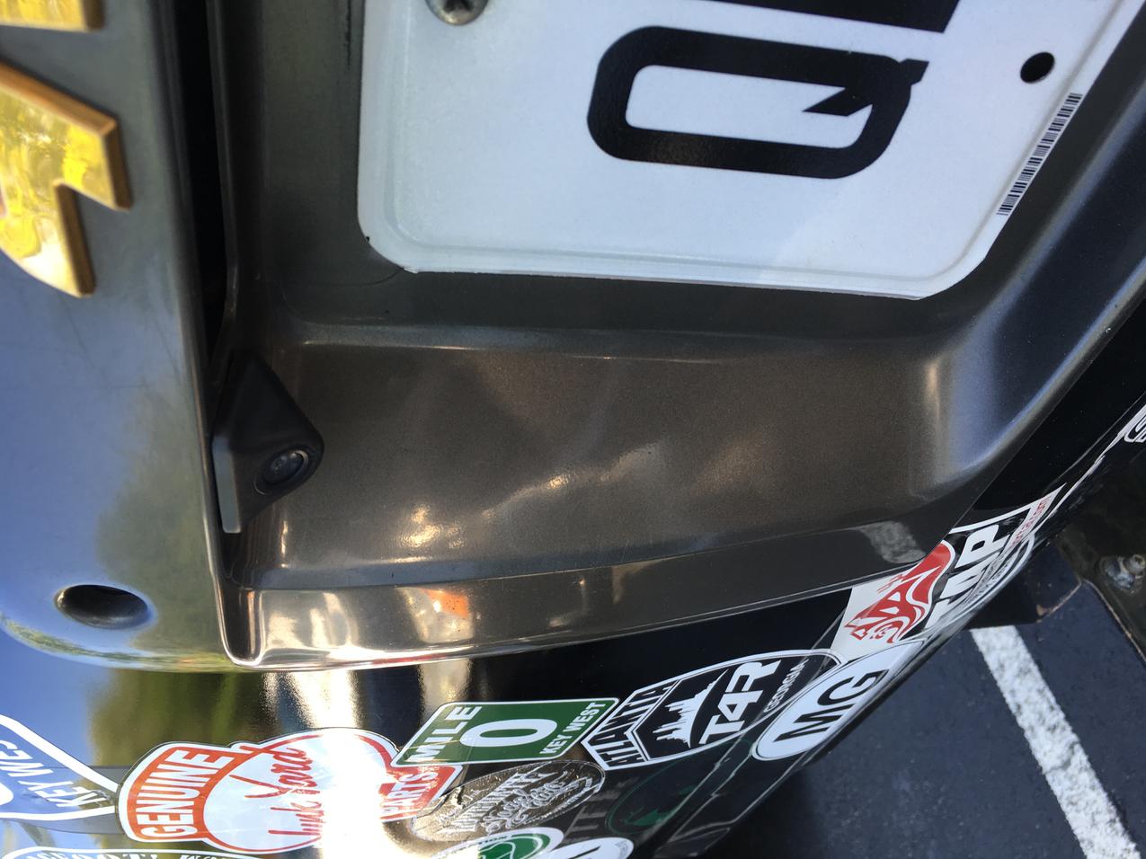

My camera install and mirror
[/attach][/attach]
