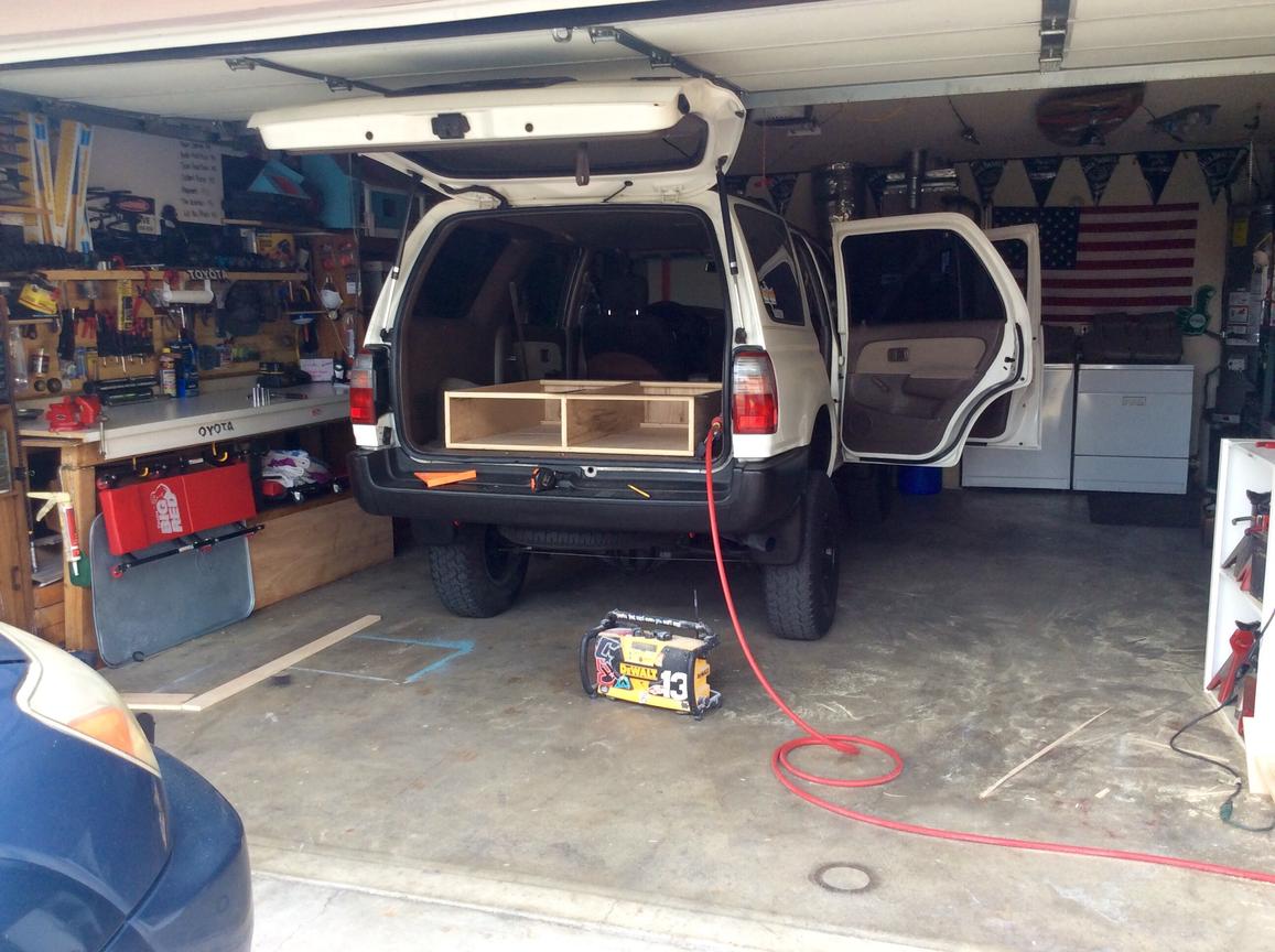

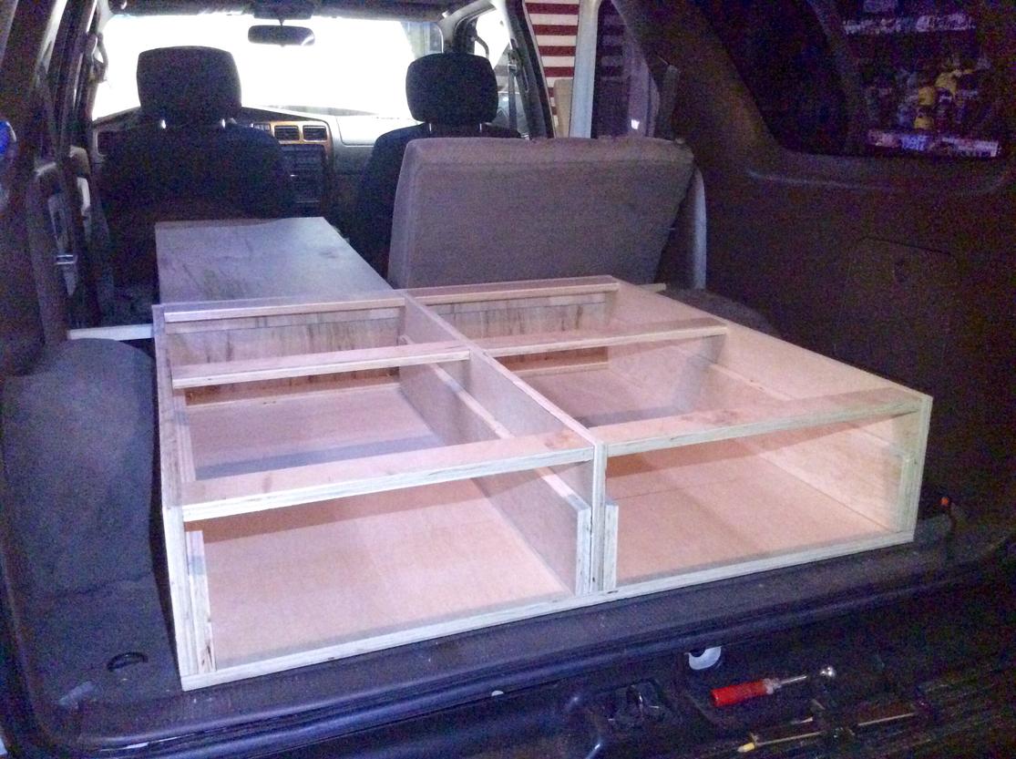

today i spent most of the day building my rear cargo box. got the idea from gottabetrd box build thread.
got 1/2 inch boards had them cut to size which for me was 36inch wide 34 deep. the total height is 8.5 inches. drawers are 30inch deep buy 16 inches. here are some pics.
Untitled by ecsbaseball, on Flickr
almost finished. just need to add some carpet and paint.
tomorrow i hope to have my doors cut for half doors.

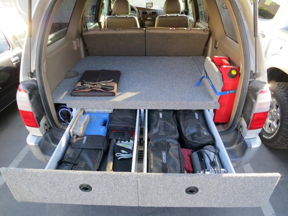

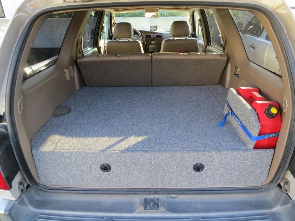

Here are some pics of my setup:
With the seats out and the rest of the platform in it fits two REI Camp Bed sleeping pads perfectly.

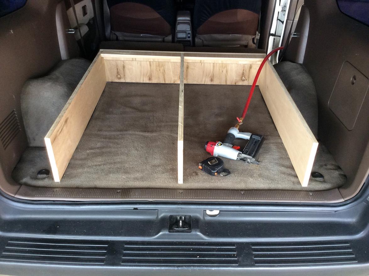

Resurrecting an old thread because I'm starting this project as well. Here's a sneak peek, will update once I'm finished! I'm basing my build very similar to [MENTION=64995]Patio Burrito[/MENTION] with a few modifications.
The Start Of my Bed Platform/Storage
For the most part It will be similar to @PatioBurrito
which you can see taking shape here in a few photos
This is when I realized i should probably start taking some photos of this build, lol.
This is all being made of Birch.

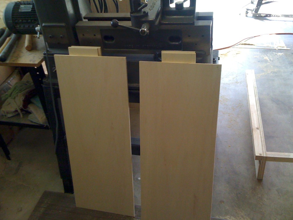

The board toward the front and the board going all the way across I was using to mock things up to get a visualization for my thoughts and to get measurements as well as last list of materials I will be needing like, drawer glides,handles, indoor/outdoor carpet, hinges, latch down ,eyebolts etc, Oh and 1 full sheet of birch.
Done at this point til tomorrow.
