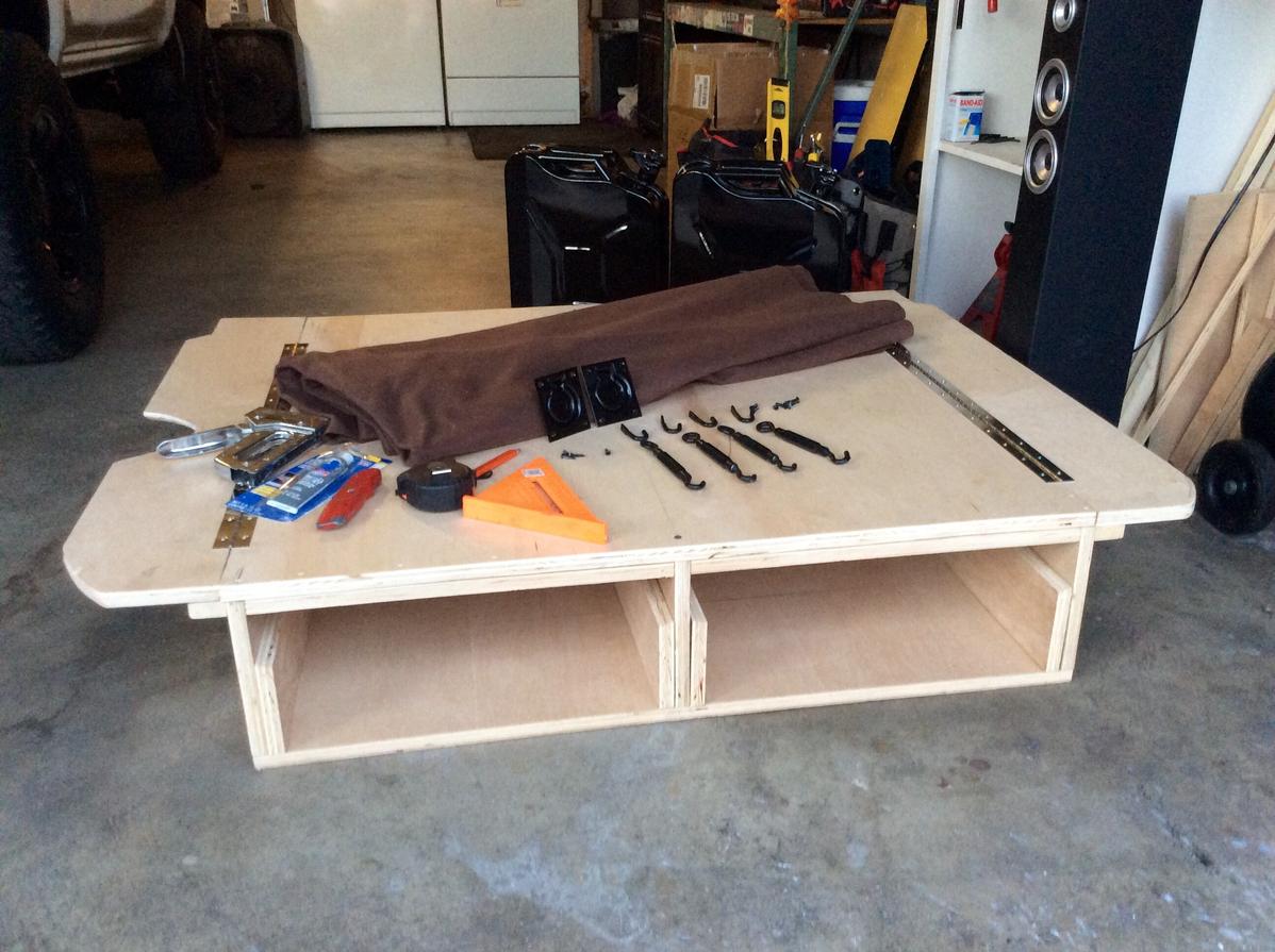

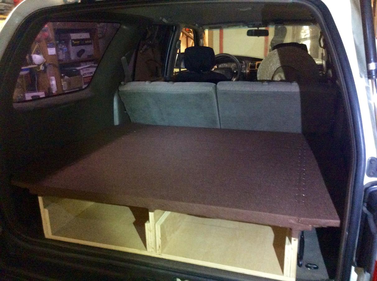

Done at this point til tomorrow..the board towards the front and the one behind the seat going all the way across are just to mock things up to visualize any ideas ,get measurements and make my last materials list for things like drawer glides, handles, indoor/outdoor carpet, latchdownd,eyebolts, hinges and 1 sheet of Birch should do it. Then install my extra battery,compressor,1500watt inverter, all in preperation for our Few day Drive Across the Mojave Desert, from oneside to the other can't wait.

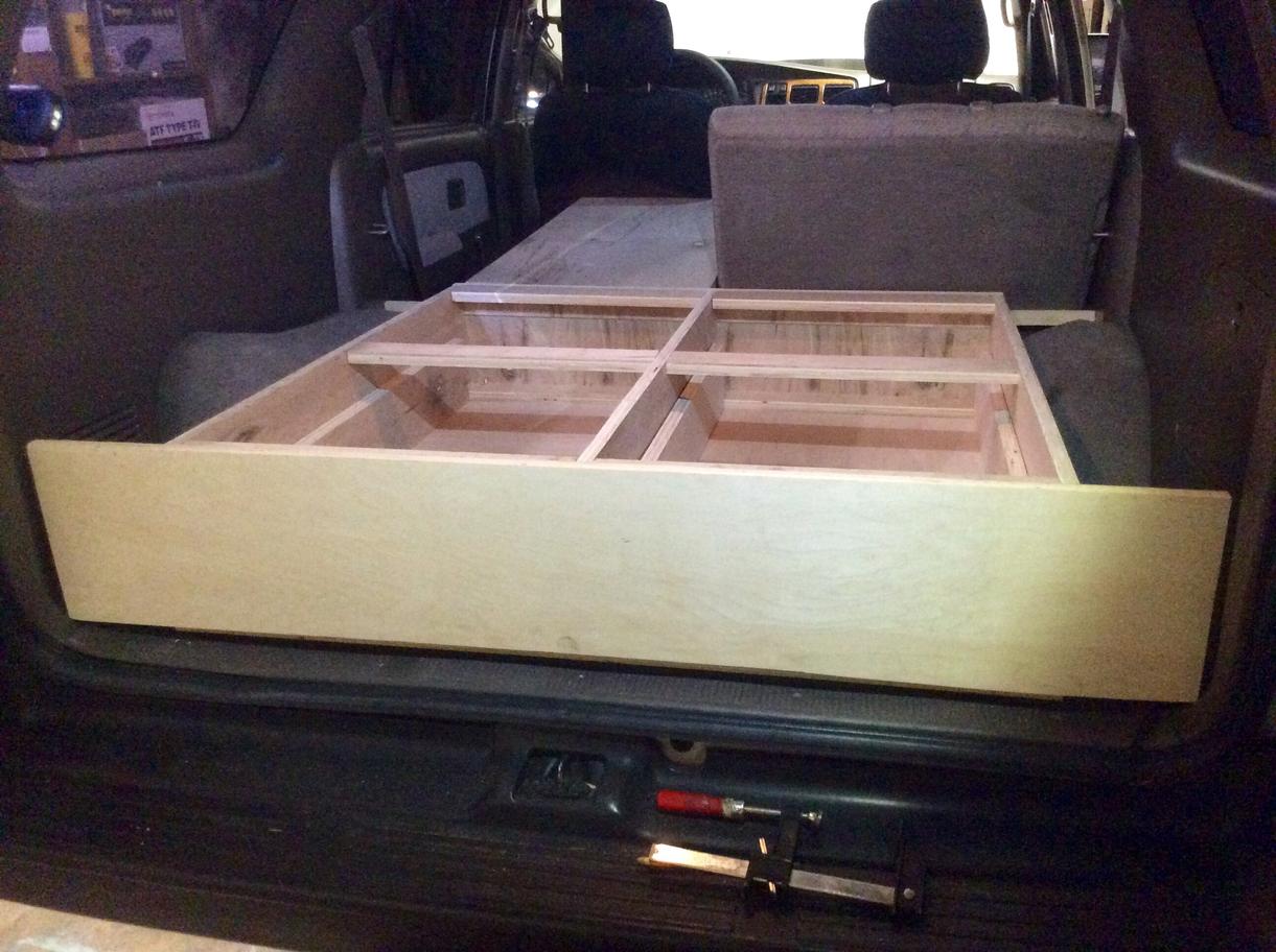

And thtas it for today tomorrow will be the completion of the drawers and the extension for the bed platform.

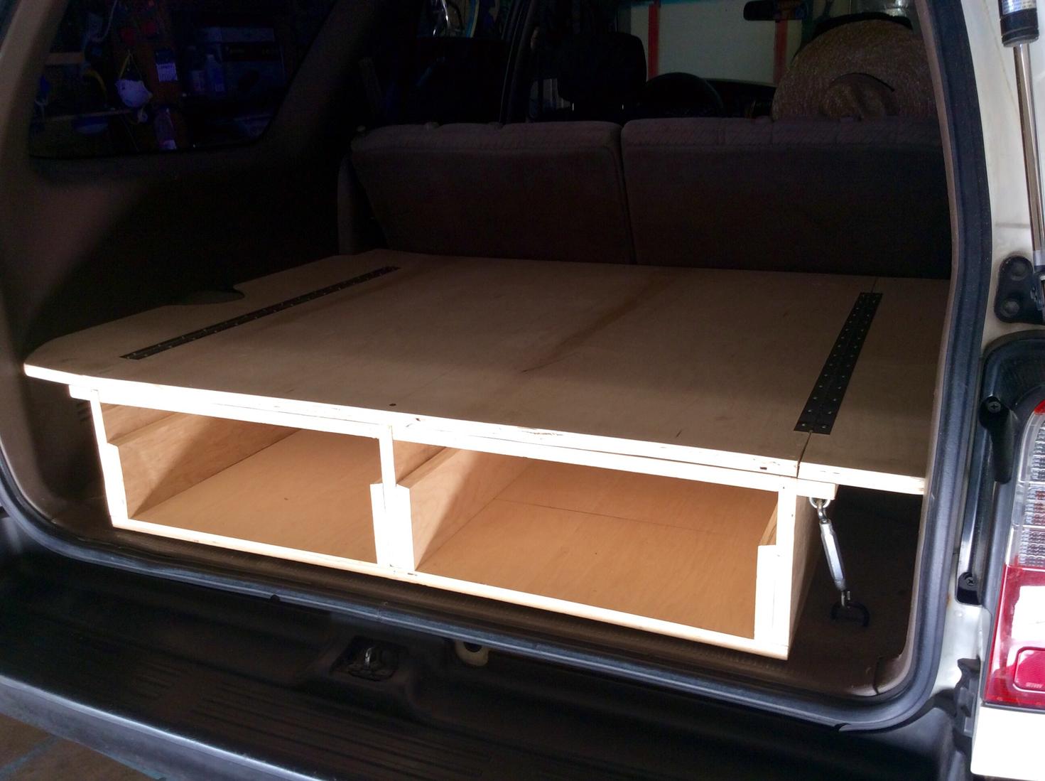

I am loving this thread, I'm working on my design and getting hardware together. What length drawer slides are you guys using? According to my initial calculations I could fit a 40" drawer but the ones on Amazon are pricey! I know I can make them shorter and just have a storage bin anterior to it, but that'd be a pain to access when fully loaded. Thoughts?

I decided to go with a shorter one too after seeing the prices on Amazon. I went with a 24" full extension slider and it is working out great so far. Behind the drawers I made a space where I can store some extra things when the seats fold forward. I am able to store everything I need in the drawers no problem too!

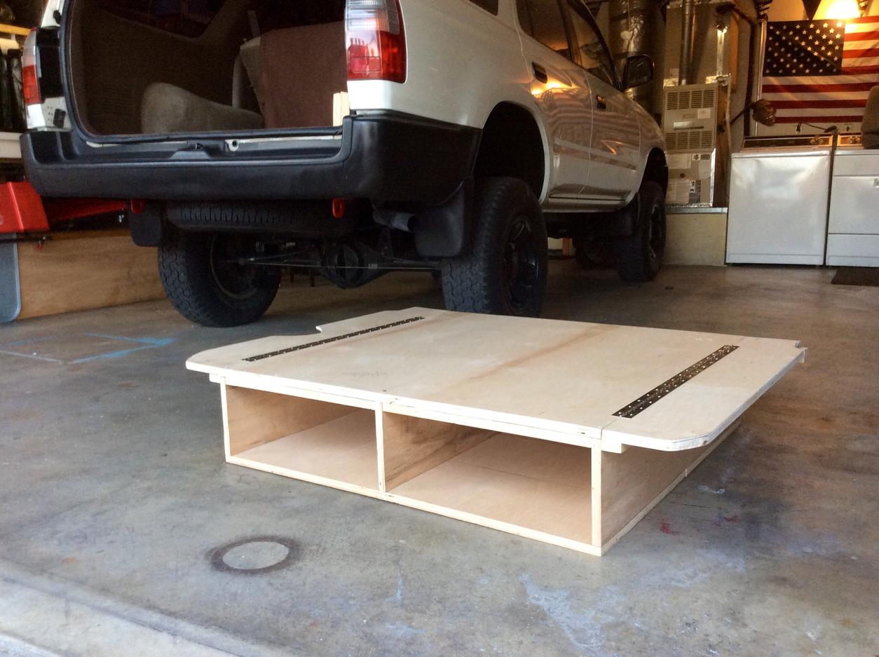

So, this is my third version of a rear storage unit. Each one has been a stepping stone to the next one. Ill post more details as it all comes to together.

I don't think a new version will be required I think you have made and found the master edition. Looks *****in awesome job brotha.

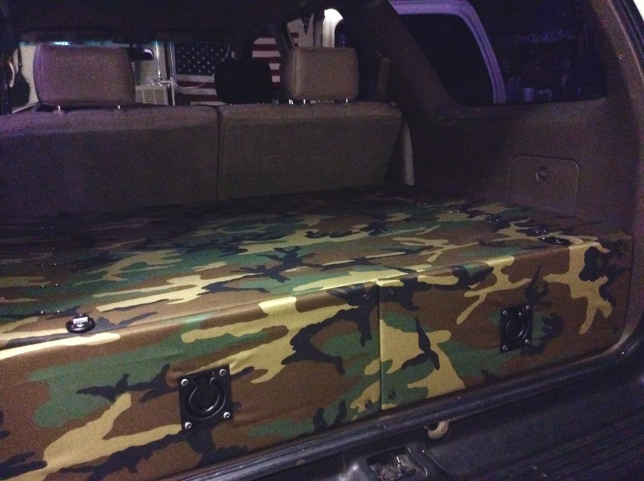

[MENTION=99874]7echo[/MENTION] here is a link to more build info. I haven't finished the inverter install, but Ill get some shots of what I did. Storage Solution
Wowwww! So many questions. Is the round hole for a speaker? More photos whenever.
