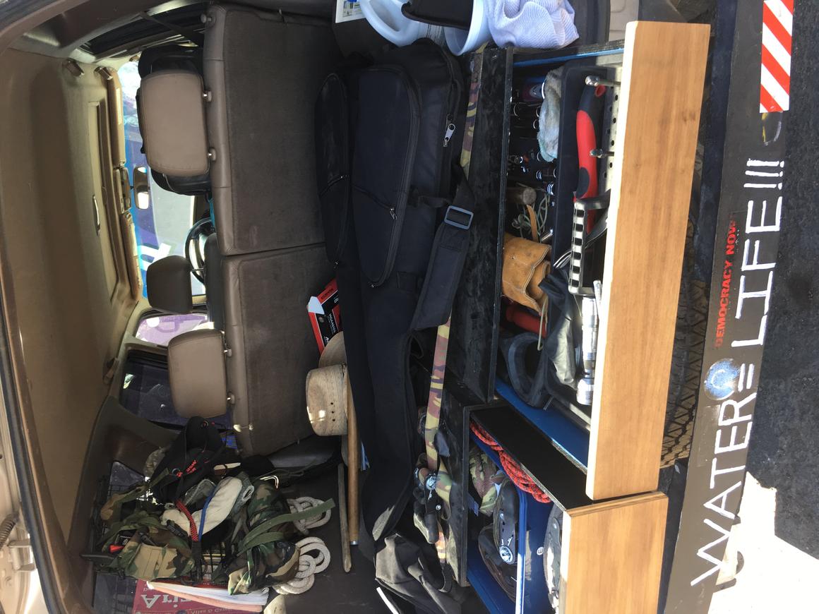

Where do you guys get your hinges for the drawer ? Home Depot ?
Which hinges are you referring to? The piano hinges? (Long, narrow ones) Or do you mean the rails for the drawers to slide on?
In pic, piano hinge in top, slide rails are on the drawers.

I was referring to the slide hinges that slide the drawer out
Several options already stated, but there is what I had in my wishlist on Amazon.
https://www.amazon.com/dp/B00GP28IOC/_encoding=UTF8?coliid=I3N4446HDV9SHA&colid=1GR0NNX7KNPQE
That brand you can find their product in different lengths and extreme weight. That turned out to be way overkill for what I needed. I just ended up with Home Depot and they still claimed to be rated up to 100 lbs. More then enough for me. In the Door Knob \ Cabinet Isle. I think the longest they had (at my store) was 22 or 24". Due to my air compressor, that was fine for me.
Are you saying you paid much more for similar item? I'll need to figure out the lenght of first. Thanks for the info.
Not at all. I think it's about the same price if you get that or go to Home Depot. Quality, I don't know about though. Yours has great reviews, where Home Depot I'm willing to bet came from China.
I lucked out. My longer set I had laying around from an older project I took apart, and my 12 inch ones I got for $.54 because I returned some things to HD that I didn't need.
Either way, if you get those or the ones from HD, I'm sure you're going to be satisfied with them.
