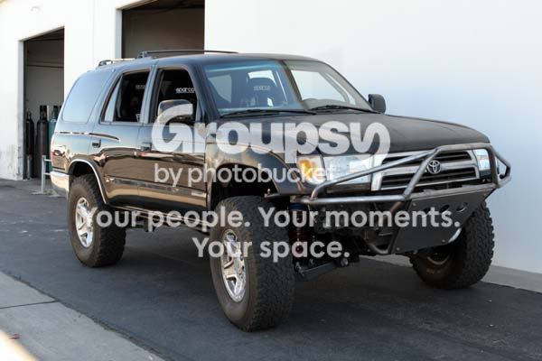

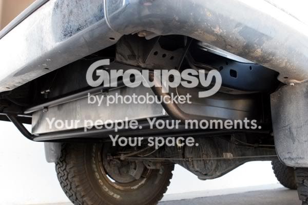

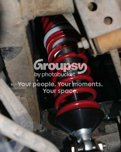

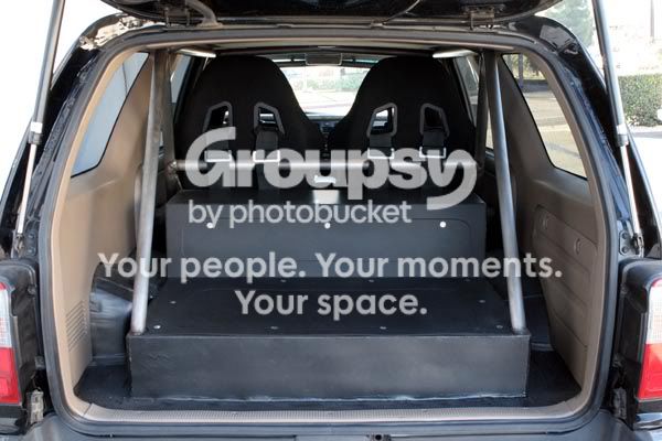

Here is a 3rd gen that Camburg did a long time ago and they did a 3 link similar to what 4running Daily was talking about. These are the only pictures I have of it.

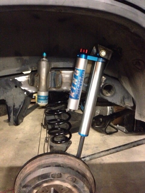

I've started kicking around ideas again for what to do over the summer when I'm not in school and have access to a shop back home. I wanted to do a cantilever setup, but I'm not sure how feasible and realistic it is to do everything needed for it in 3 months while working full time and then needing everything good to go to drive back to school.
I've seen a few guys running coilovers in the rear and mounting them in the wheel wells (usually SAS guys). One of my main goals over the summer is to get a wider rear axle, so I don't think I would have rubbing issues once the rear is widened 6-9". I measured a few months ago and I think I can stuff a 14" shock in the wheel wells without cutting into the body at all, based on where my bump stops are right now which is on the lower end of what I was thinking but would be a lot better than I have now and at least matches the front end.
Any thoughts before I put more brain power into this? Simple triangulated 4 link, ~14" coilovers, hydro bumps, widened rear end. I think that would do pretty well if I get some resi kings, maybe see if I could fit a secondary shock in the future.
