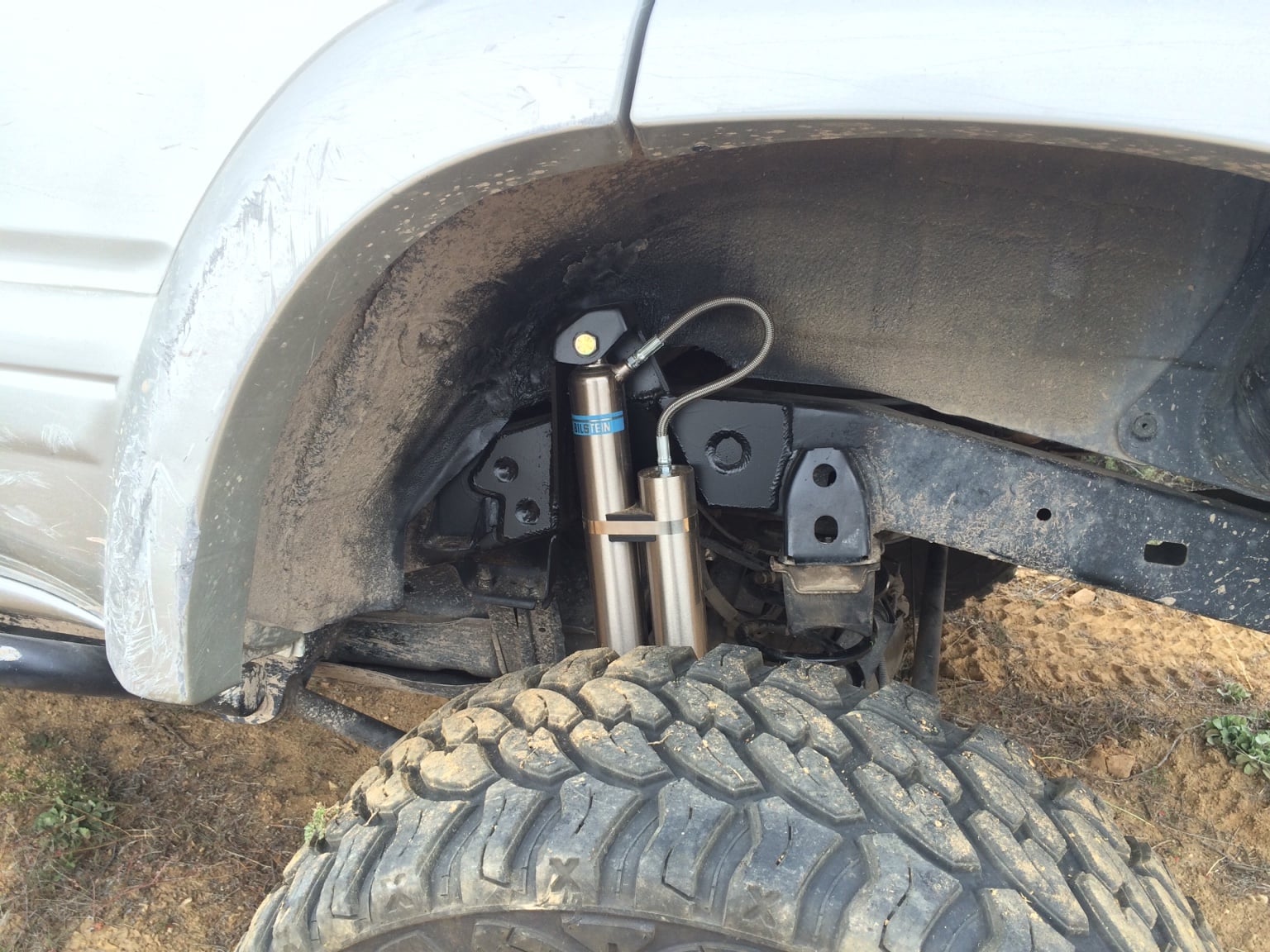

I did something very similar to what [MENTION=101910]Turbonate[/MENTION] did. My goal was to keep stock bump stop location while getting as much down travel without running into issues. I decided to use Bilstein 7100 12" short body shocks. It would be pretty hard to get much more than 12" shocks to fit without clearance issues or having to cut into the fender wells. It was pretty tough to get mine to fit while keeping stock bump stops. I wouldn't go more than 14" with stock links. Mine bind up quite a bit already but I still have stock links at the moment. I plan on fabbing so new links soon.

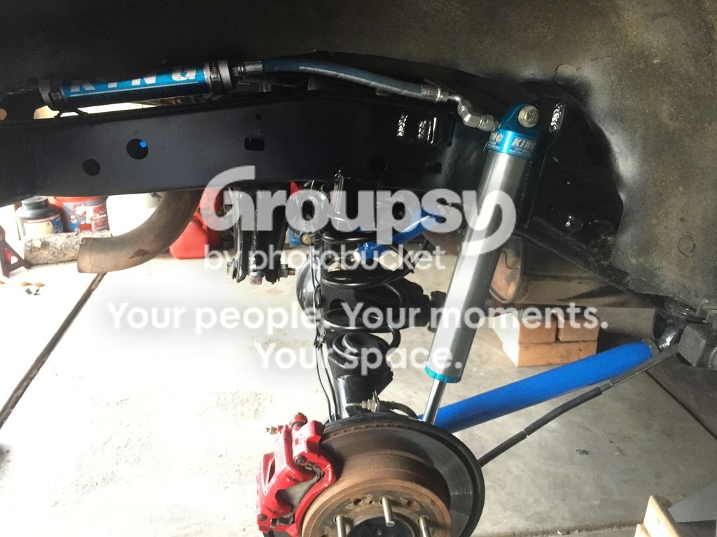

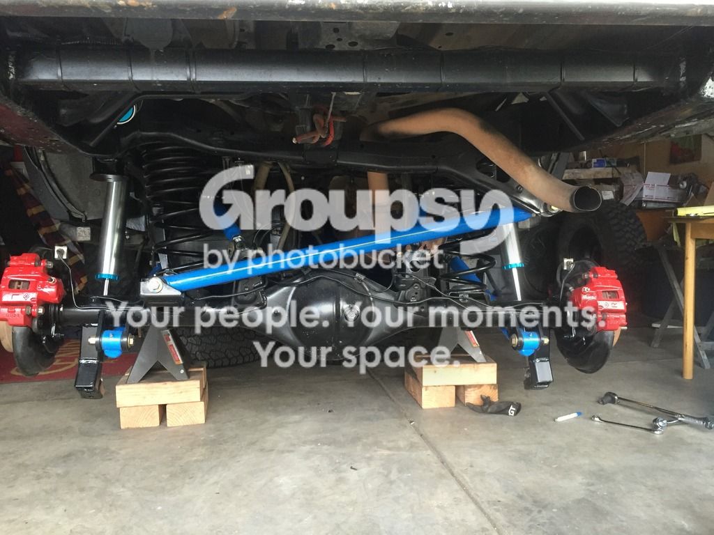

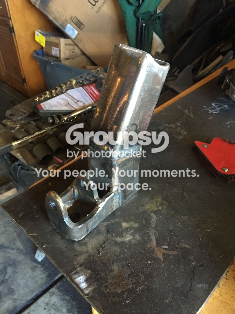

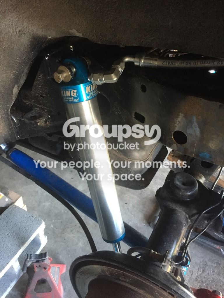

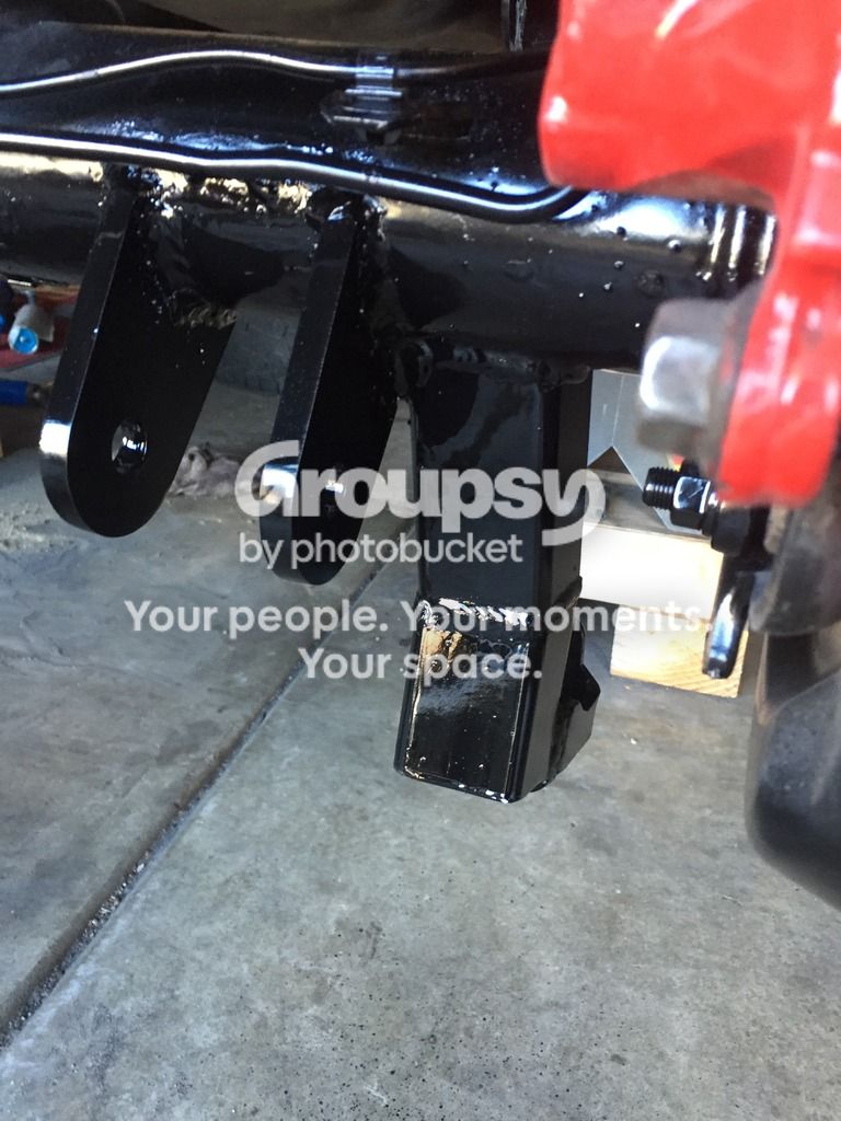

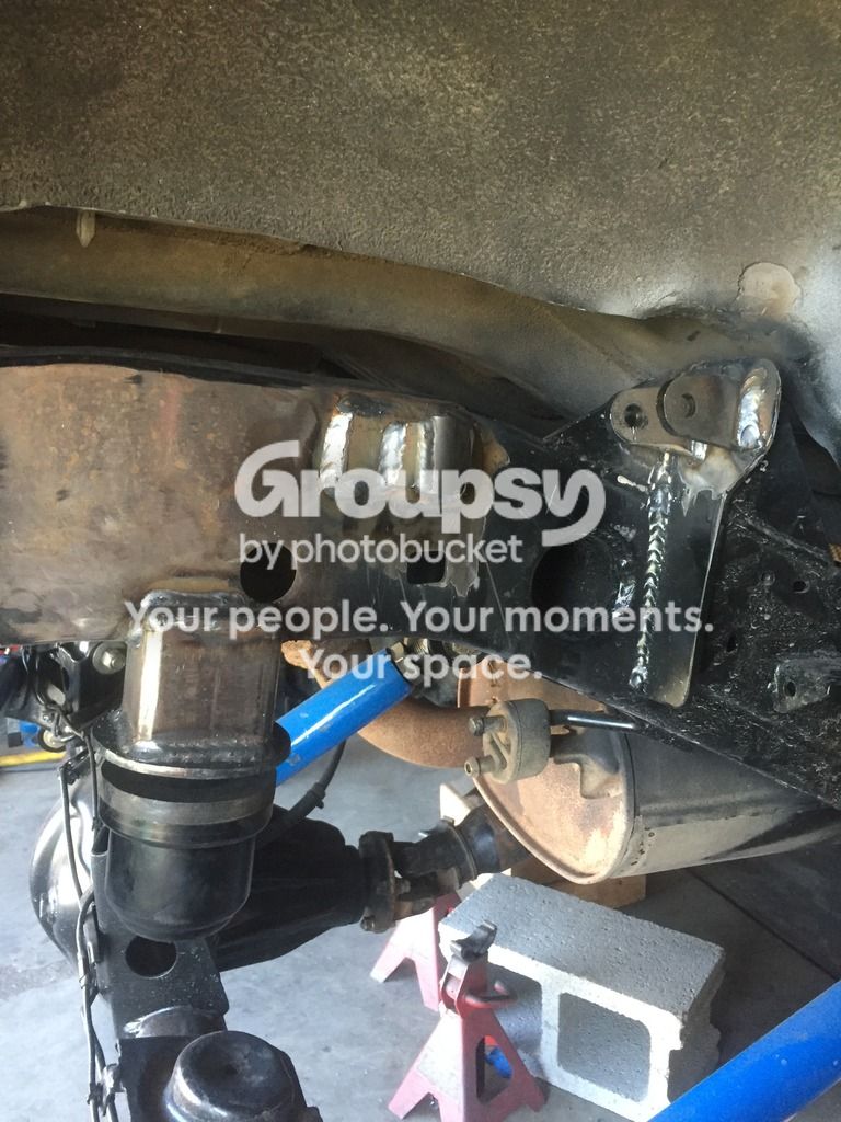

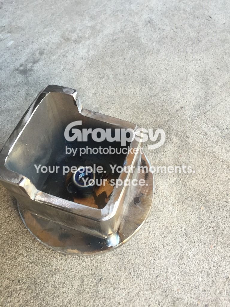

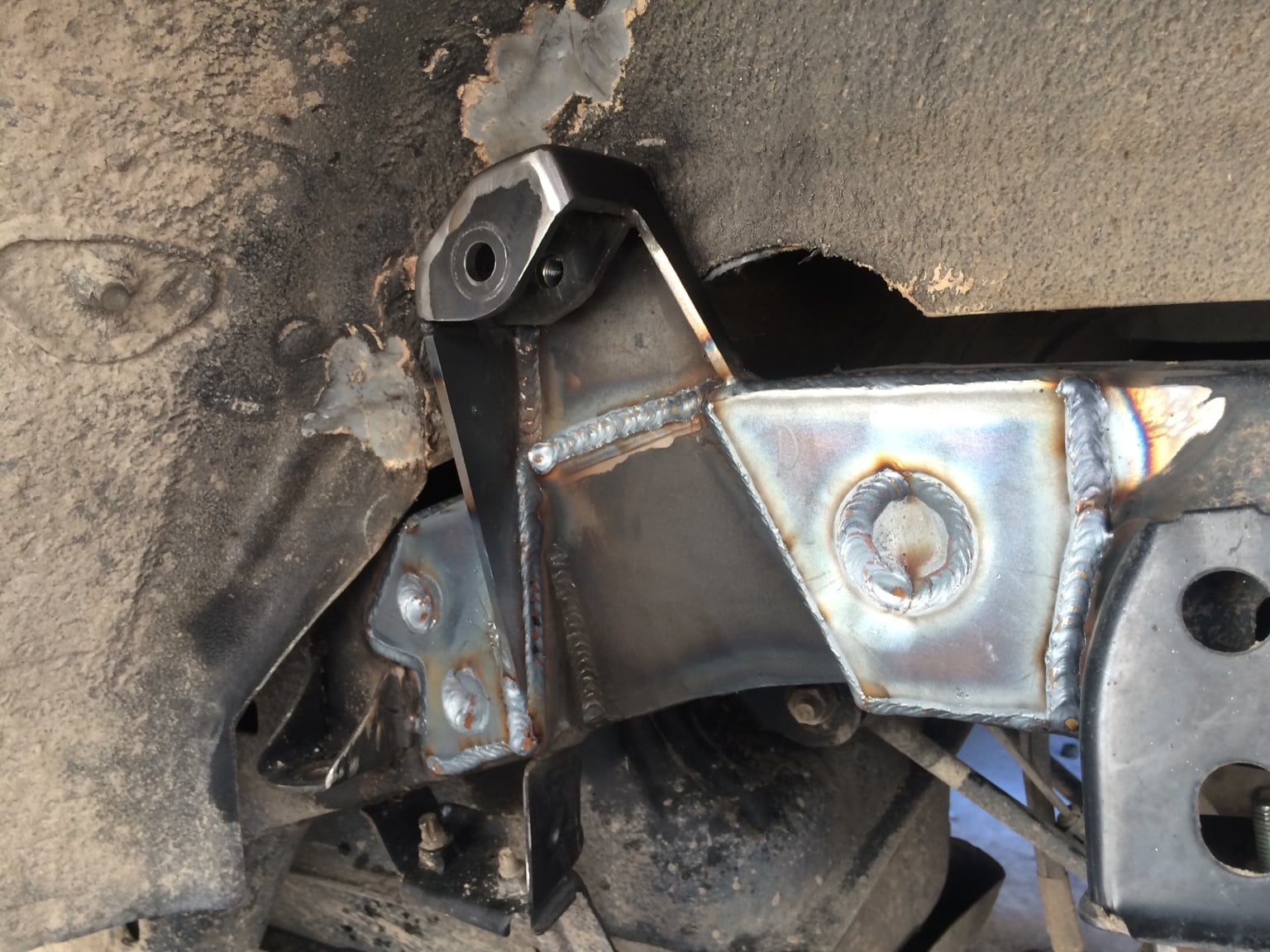

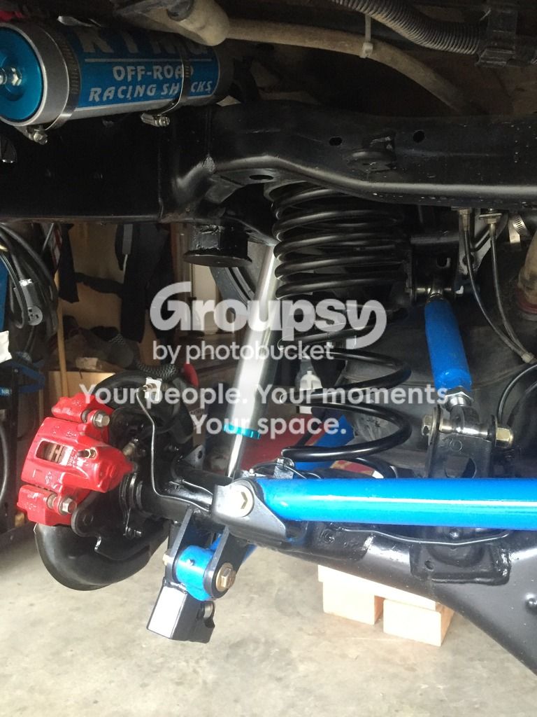

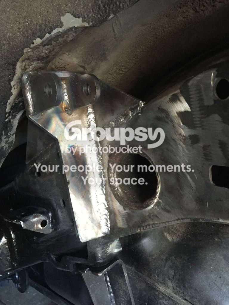

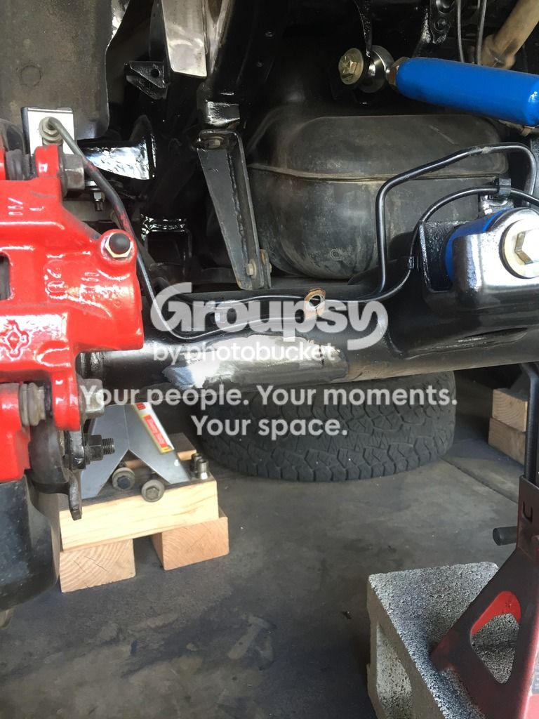

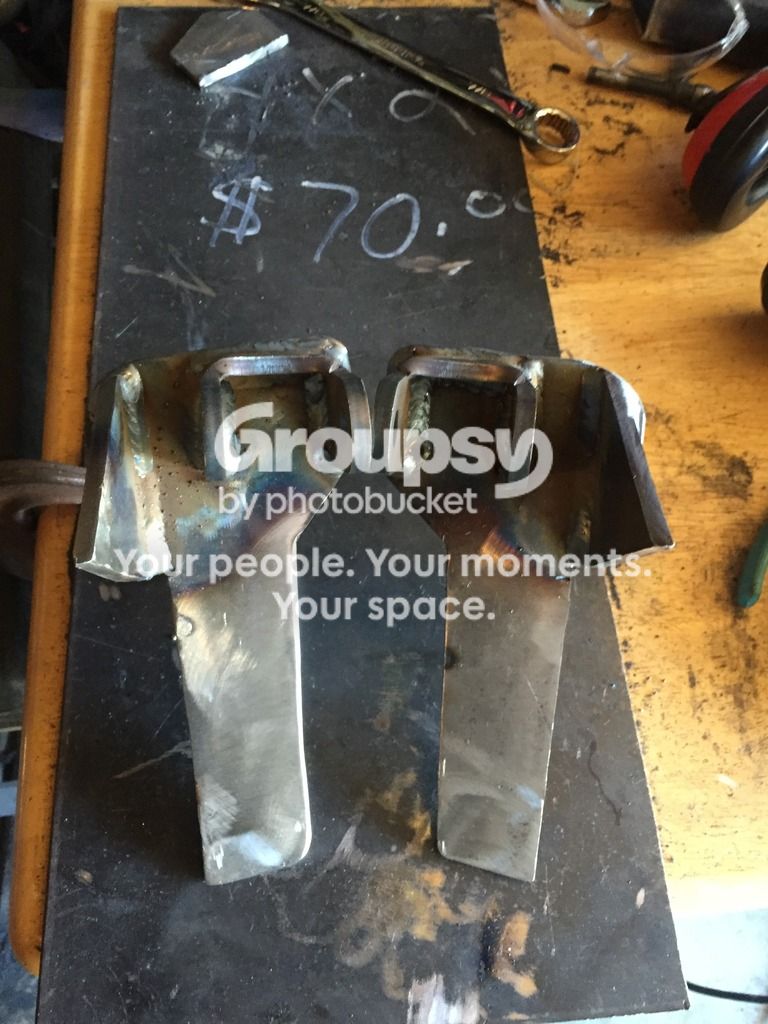

Here is what I recently did on my '04, wish I had seen this thread sooner, but wouldn't have really changed too much.
  • King 2.5 12" RR, 30.9" Extended, 18.9" collapsed with over cylinder top cap and welded lower rod end to get to those specs
  • Metal Tech LT HD coils, longer coil passenger side, shorted on the driver with a 1.5" DS spacer.
  • Heim and bushing on the LCA and pan, dual heimed on the uppers
  • Stock upper and lower shock and LCA mounts cut out, upper shock mount moved up 1" lower shock mount dropped 1"
Just saw this post. How do those kings feel in the back end? And do I feel much of a difference in the back end with replacing the bushings with heim joints? Being as that frees up articulation so well I am wondering if it makes the suspension feel less reactive
The Kings are fantastic compared to the Icons, night and day, really happy with the way it is working out. May play with the pressure and valving some, but overall they are setup quite well, especially for big hits when loaded down, which is where the Icons reallllly struggled.
I don't think you could feel the difference between bushings and heims, but the bushings will bind sooner and not articulate as well. My upper arms were heim/bushing before I started this project and when I began cycling everything noticed the bushing was binding pretty bad, so chopped it off and put a heim in there, now there is no binding at all on the upper links.
A bushing on the lower links was a necessary evil with the offset to avoid the link binding on the axle, there are a few options out there that could be used to get rid of the bushing on the axle end, but the axle side doesn't twist quite as much on the lower arms, so I can live with a bushing there. That end is in the mud and water more often too, so a heim joint there will wear a lot quicker than at the frame side.
Interesting. Whats the difference - are the Kings valved heavier on rebound for more weight? I would imagine coils perform similar between the two as long as they are similar spring rate. Which of the two (Kings or Icons) do you think would be better for on-road dynamics on a stock weighted 3rd gen? I know you can adjust valving on either. I would be interested in eventually upgrading to one of the two, but I have no plans of adding armor. I do mild off road, mostly local mountain trials. But the majority of my driving is on road, so that is my primary concern

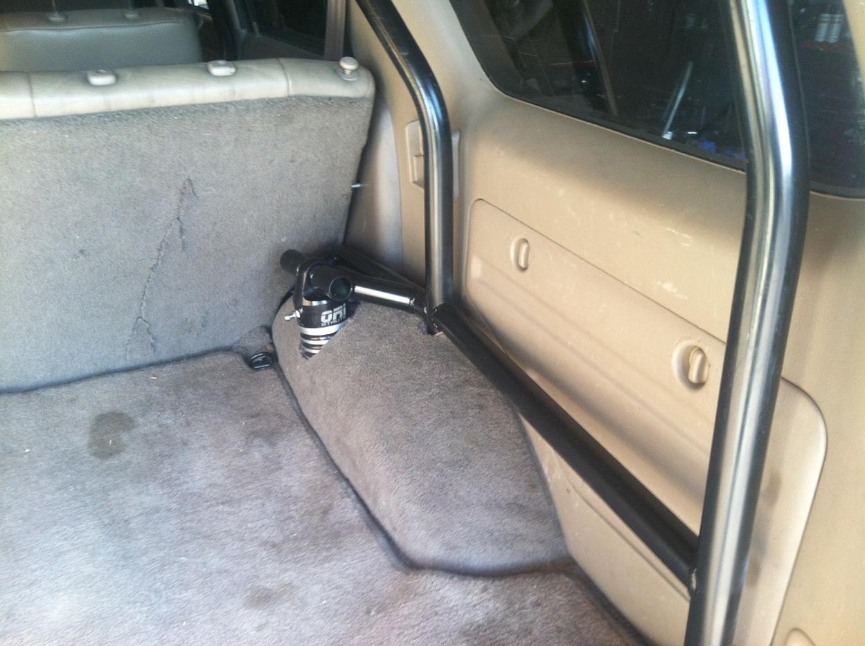

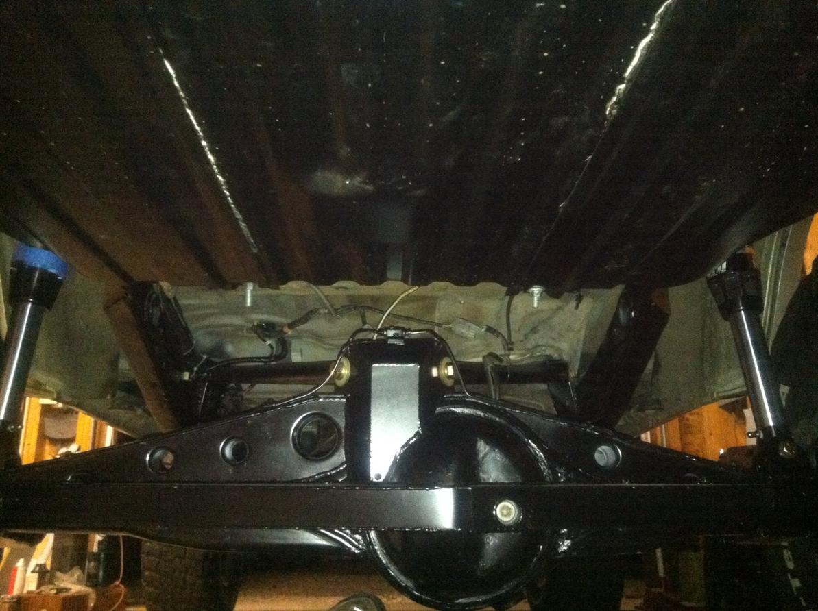

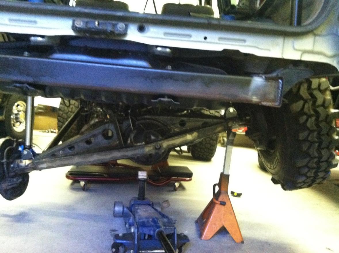

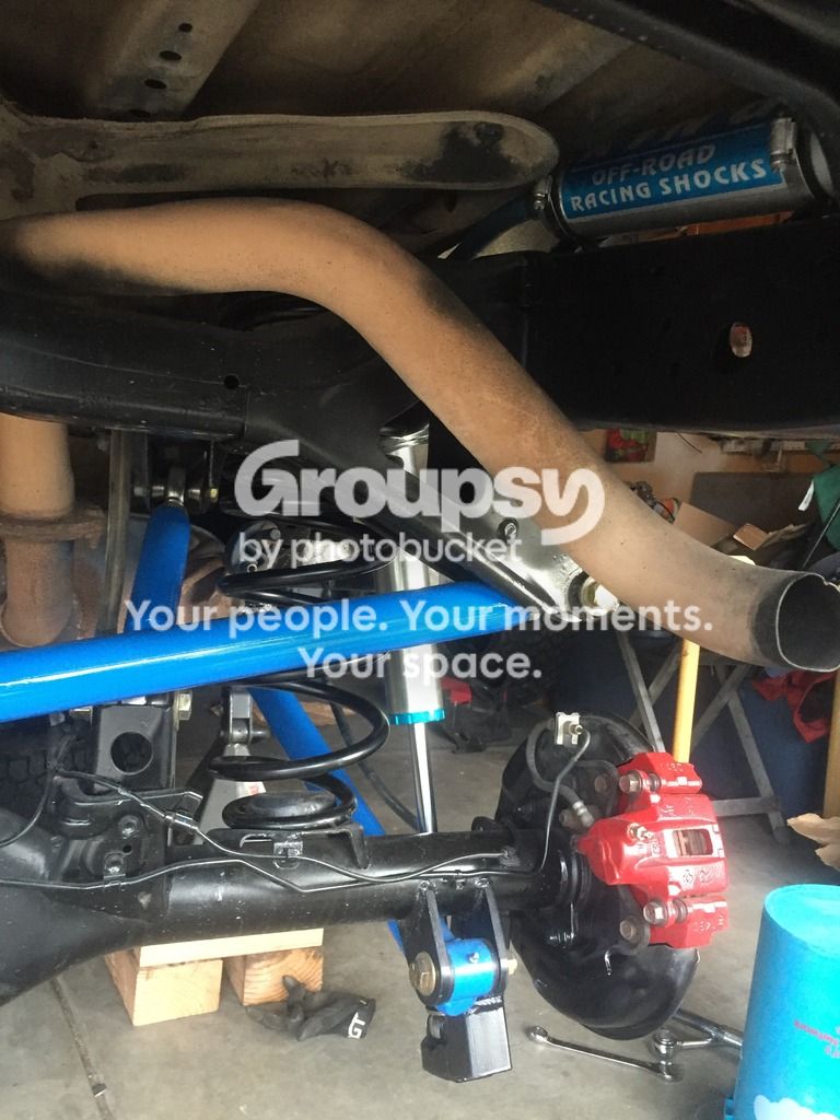

I chose the 4 link set up with the F-150 tank swap. Went through the floor as well to get the travel desired and to keep the 4runner low.
I started with coil-overs but the more I read, adding bump stops and the sway bar was going to be the ticket with all the miles I was planning on putting on it, also it was getting congested back there...The ORI's have been great .
