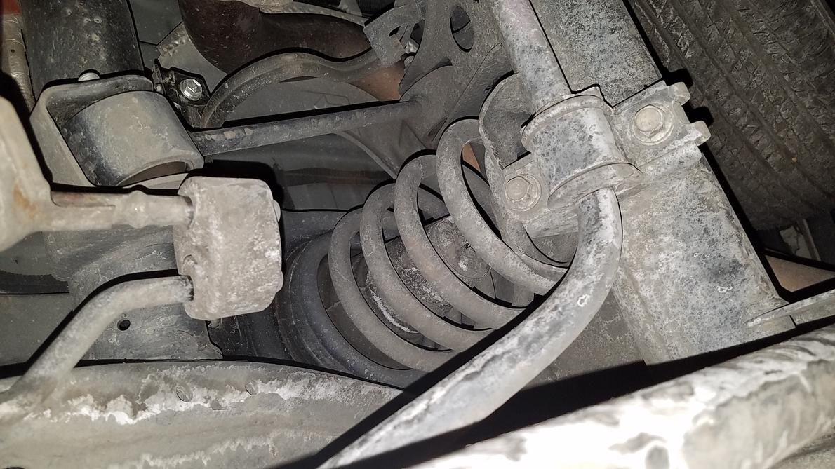

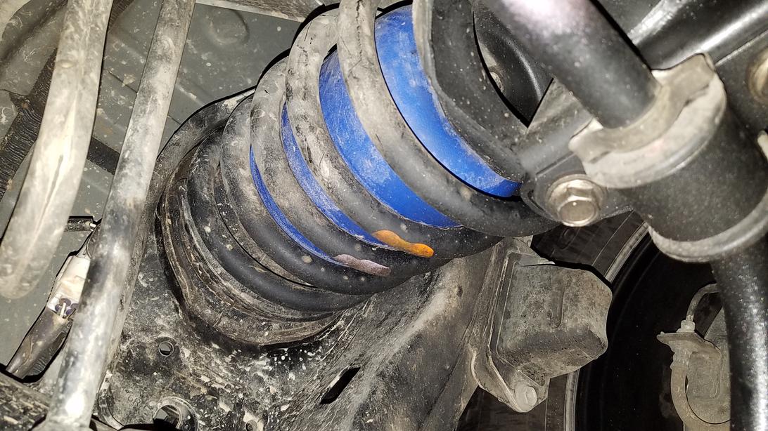

I put airbags in my '16 LE coils. I ended up putting in Firestone Ride-Rite (4135 Coil-Rite). I needed to drop the whole side including shock and removed the coils as I had to chop off the bump stop.
