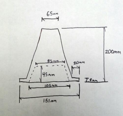

Hi,
Does anyone have the dimensions of the rear conical bump stops? Perhaps somebody has a spare uninstalled conical bump stop so it's easy to measure
I'm after the base diameter and the diameter of the cone's base.
Thanks

Just measured mine. 151mm base diameter. I also attached a drawing with other measurements.
