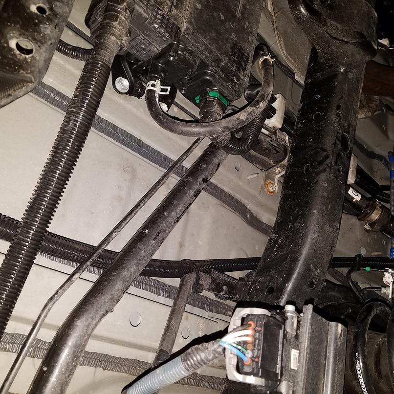

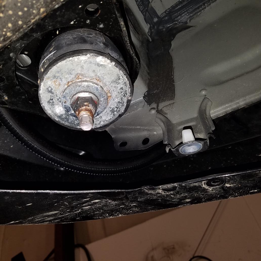

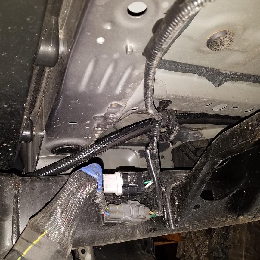

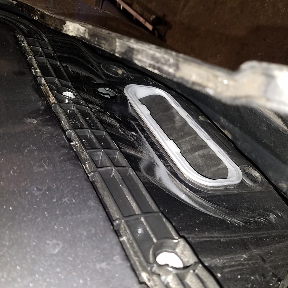

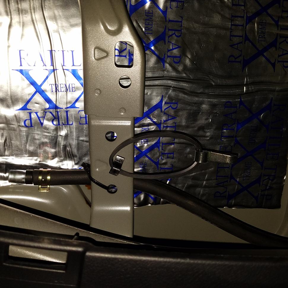

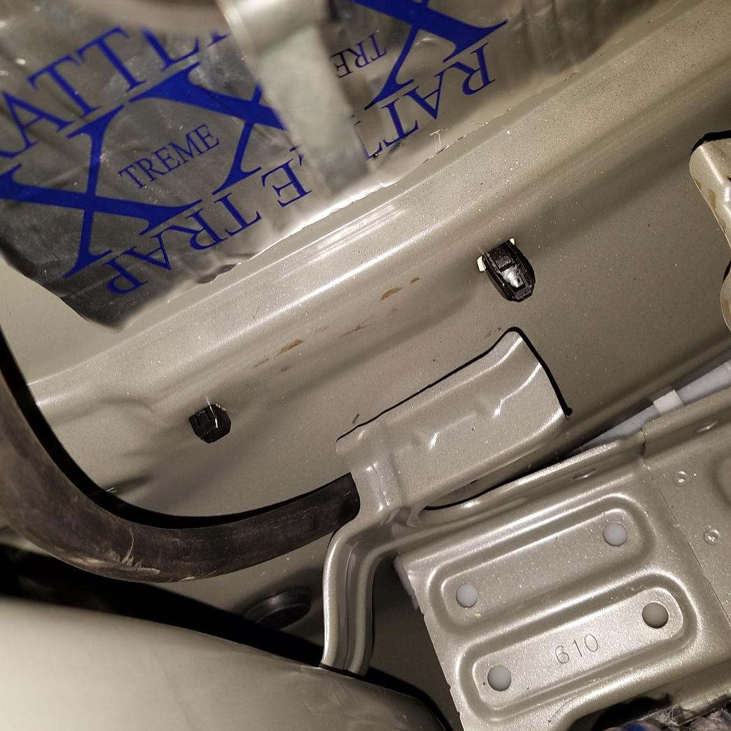

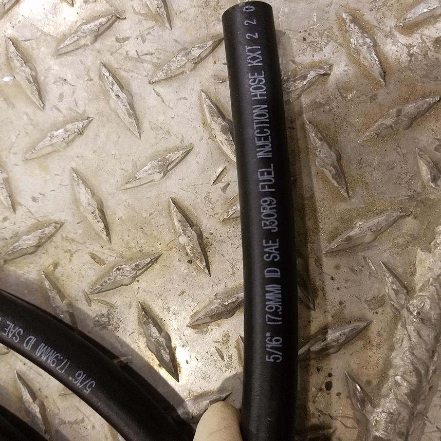

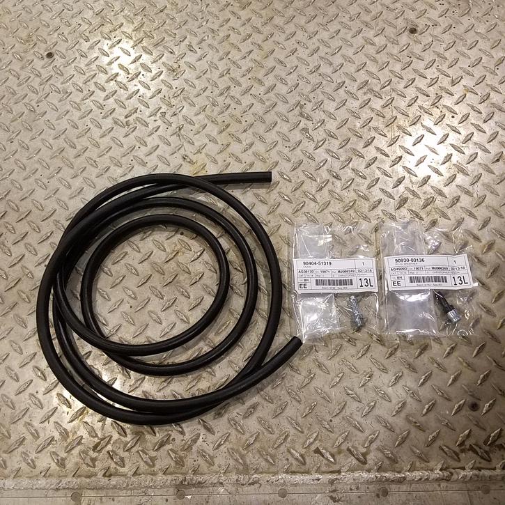

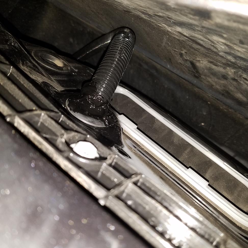

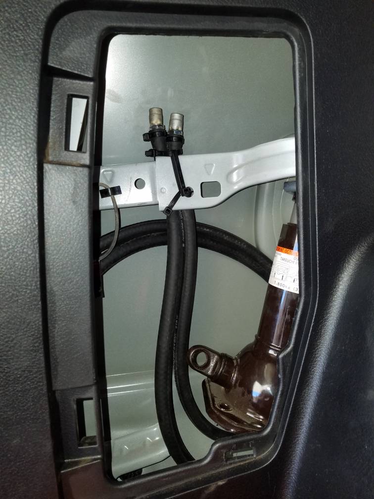

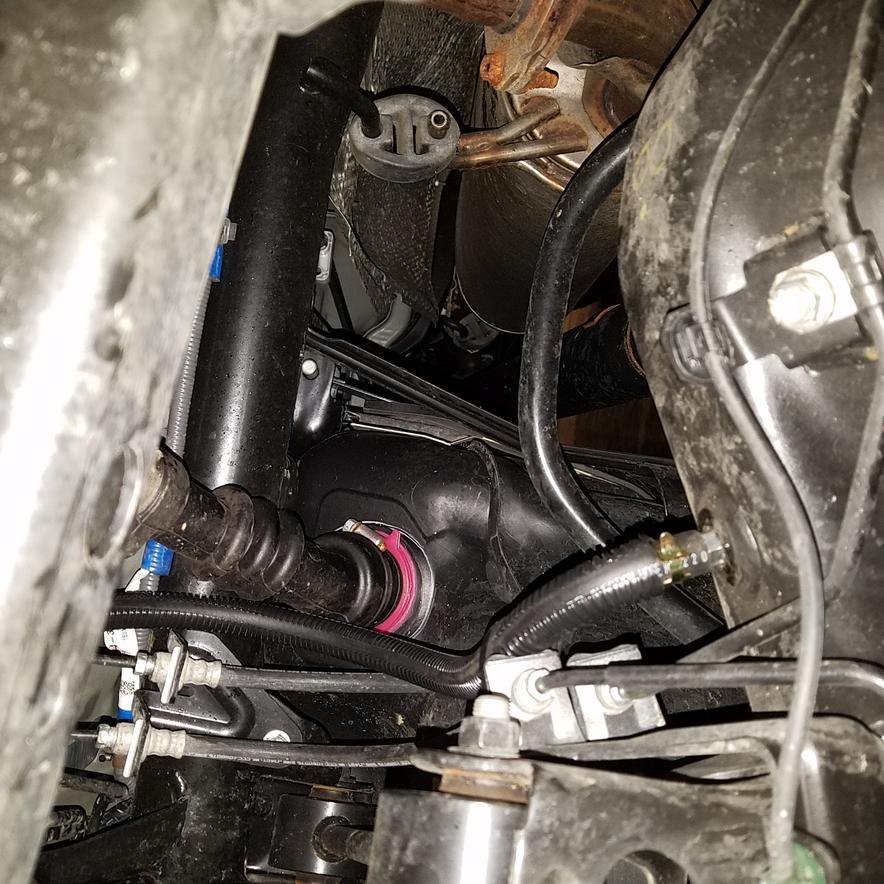

Here's what I did

Here's what I did. Just slightly different than what other have done.
I ran the tube up into the gas cap area. Another option is the ARB filtered diff breather kit in the engine compartment with the tube run along the frame to the breather. You'll find the link to the breather kit in one of the links here.
