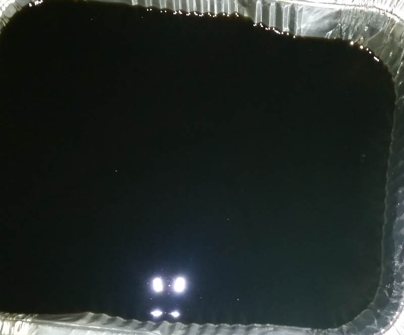

What kind of green is it? Like really cloudy/milky green like from
moisture contamination? Or the faint greenish that you pick up in gear lubes in sunlight? It's your truck and everything and I could completely be in left field about the roll washers play in help holding things from working loose but it's not one I'd like prove positive. Meaning it most likely will be fine, but you do understand if it does work loose you're off to the races with no horse in the money.

I would say it is a faint green, almost shining under the head lamp. Not muddy or milky, I have seen those in water contaminated diff fluid before. I got a picture. The fluid is dark color :embarassed: You can barely see the green hue in the bottom right corner due to cellphone camera flash...

I think that green sheen that catches the light is rather normal for many gear lubes. And I don't think that's really that dark for as many miles as you say are on it. It doesn't smell burnt does it? No grit on a clean towel ,no bits of metal shinning in the glint of sunlight-seems you're good to go.

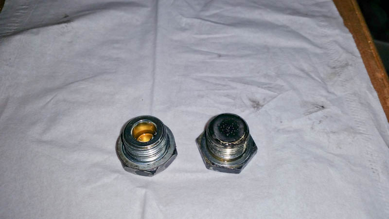

It stinks but doesn't smell burnt. No grit or shinning. The oil left on the bottom of oil drain pan is golden brown color, just like what you see on the drain plug here

By the way OP, where was the dirty plug in the photo from?

It is the magnetic drain plug with metal shavings.
... In that case I might reconsider the looks good. IMHO that gives you a good reason to put a new crush washer in there. You might want to pull the drain plug just to see if those shavings are an ongoing issue or just something left over from original break in as some have reported in their justification for an early flush of the gearboxes. And it can't hurt to "flush" it one more time so long as you don't introduce anything worse than you remove, right? The one downside I guess would environmental I suppose.
