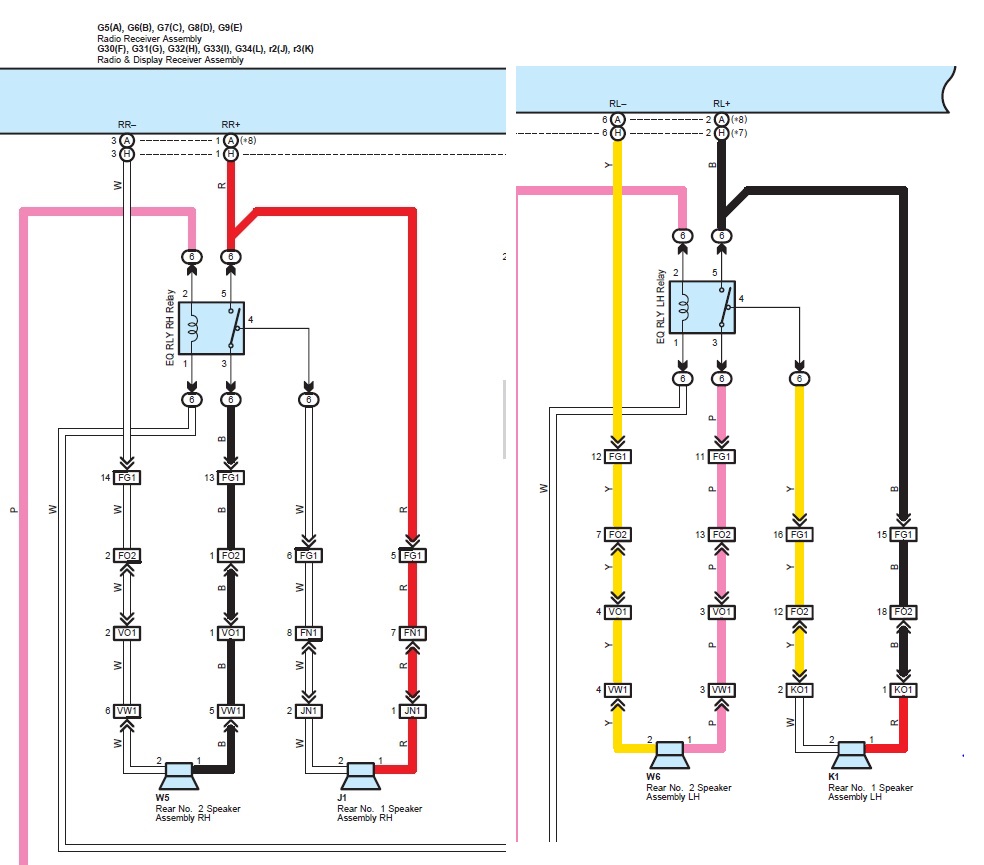

I am installing a system in my 2012 4runner. For the rear doors it seems that there is no place to hook up on the adapter? Any idea? I've looked over the adapter time after time, and I can not come up with any idea. Thanks for any help!
The wiring adaptor to hook up my kenwood ddx 719 to the stock wiring. I can hook up the hatch speakers and the front speakers/tweeters, but the rear doors I can't, so I'm trying to figure out how to.

but seriously, can you shoot us a few pics. It would help a bunch. I reinstalled some Infinity Kappa 63.9i's last weekend and used some 3M dual sided tape to hold the 'crossovers' in place.
This may help...

Did you try turn on the stereo? The adapter harness does not know how many speakers you have in the back. The stock wiring handles all of that. The rear door and hatch speakers are wired in series with a relay enabling "party mode". Assuming you didn't cut any wires, all of it should still work.
I have an amplifier and I tapped into the rear wiring at the head unit. I changed the hatch speakers and those are working. I wonder if I turn off party mode if the rear doors will work? Ill give that a shot. Im thinking that party mode might turn off/on from the rear doors to the hatch.
Dude you are wasting everyones time. You mean you didn't even press the Party Mode button to test it? That's exactly what it does. Cut off the door speakers!
