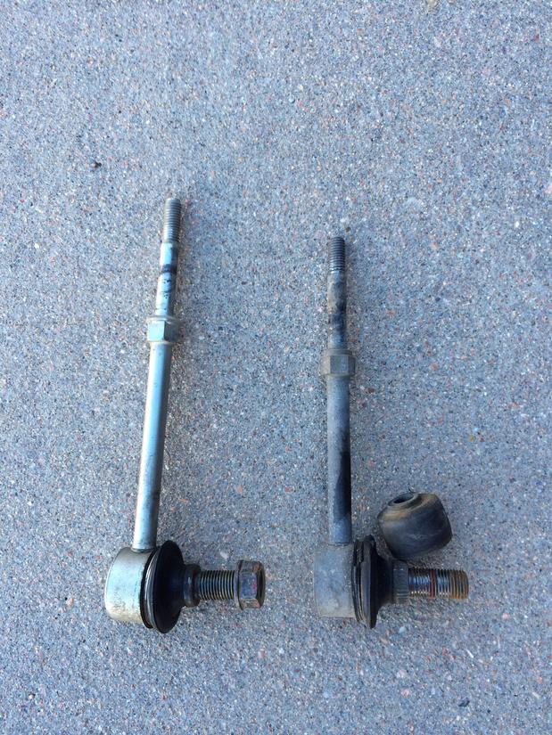

I'm running FJ rear links. They are a little longer and seem to be doing well.

I have the stock panhard bar mounts, but use 2nd gen sway bar links, so it should be pulled to the passenger side away from the tank. My grease zerk keeps getting knocked off from hitting the tank skid plate. Bad place to put a grease fitting. I'm going to put a 6mm bolt in the hole when I'm not greasing it. I think the tank is just too close for the additional suspension movement with a lift and a lot of flex off road.
Not sure if i understood you correctly but are you saying when you put the 2nd gen sway bar links on, it helped pull the drive shaft away from the gas tank?
No. Just noting that I have the longer 2nd gen links (thus less chance of breaking the 3rd gen links and allowing more flex).
I don't have the extended panhard bar bracket, so the added lift pulls the axle toward the passenger side (about 3/4" with 3 1/2" lift). Thus having the panhard bar bracket to move the bar down (or an adjustable bar) would move the axle back toward the driver's side, making it more likely to hit the skid plate. My real point was that the skid plate is just too close to the axle to work on lifted trucks without having the axle hit it. You need to move the tank over, or bang a big dent in the skid plate (and hope the drive shaft doesn't hit the gas tank!). I hope somebody has another solution. I'm tired of replacing grease zerks.
Ahhh, I gotcha. Your comment regarding the adjustable bar and drop bracket makes sense. I have both the adjustable bar and drop bracket still sitting in the box b/c I cant decide which way I want to go to avoid hitting the gas skid. So as of now, I'm willing to have my panhard out of spec to decrease the risk of having my driveshaft hitting the gas skid. I am kinda leaning towards installing the bracket on the driver side based on the few members I've seen go this route & it seemed to work but since this method is less common, I decided to hold out.
Any opinions/benefits of having a rear sway bar link that's an inch longer (using the stock 3rd gen front links) vs using the 2nd gen rear sway bar links that's around 2 inches longer?
