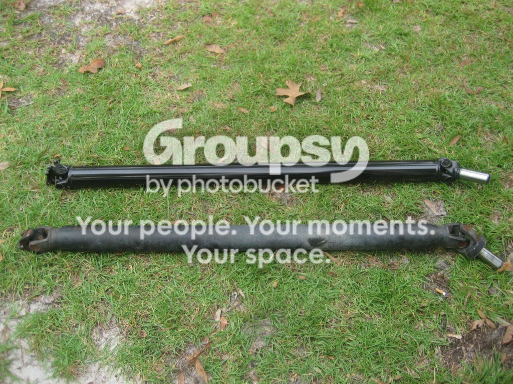

Fun fact for the day. Did you know that Low Range Offroad sells replacement u-joints to be used in place of the Matsuba u-joints? This u-joint can be used in various models 1979-2010. This u-joint will also work in our 3rd Gen's, but only in a DC set-up. These can not be used in a regulat CV set-up. I've talked with Low Range and was told these would work for the OP's application.
Low Range Offroad
Yeah, I saw that too. I wasn't sure if it was actually Matsuba, or just a replacement for it. Also, their little compatibility table says for the 4runner rear "non CV". I took that to mean not the DC (usually considered a CV), so I thought maybe the 2wd doesn't have the DC (hence it fits the front and rear non-cv joints). If they confirmed that that u-joint fits the 4wd DC, then awesome, that is even better. Though it also says it fits both the front and rear of the rear DS, which can't be correct, because the rear u-joint is a common part, and not the same as the joints in the DC (or so I read at least, I haven't taken mine apart to verify). If it really is the same u-joint in the rear of the DS and in the DC, then some folks just played a big joke on us...
The point still stands though that this isn't as easy as the rear u-joint, and most people probably are not up to it, especially if they don't have the equipment. I saw in one of those threads I posted that someone did it with a rented ball joint press (actually I don't think my autozones/oreilleys rent that big a ball joint press...) and one did it by pounding them with a hammer, but my experience has been that neither of those will be sufficient, and you really do need a press (then again, I have more rust than most...)
Also, I think we have the outside c-clamp design, which one of those posts mentioned is much harder to remove the cups because you can't press them all the way out, and they had to make a weld-on slide hammer.
EDIT: Actually, if the picture on their site is the actual part, then that is the inside clip design. I guess I need to check if I have the inside or outside design...
EDIT 2: Looks in this pic like we do actually have the inside clip design, so maybe that trouble the guys mentions doesn't apply to us...
So I still have a question about their compatibility table and whether that joint is actually correct, but if it is, then this should be doable, but again, I think not for the casual weekend mechanic.
I still have that gut feeling that if I tried to replace mine, it will still be a nightmare somehow...
All in all, it doesn't appear to me to be a job for the typical DIY'er. Maybe I'll change my tune once I do it myself, but I doubt it. Nothing has ever been easier than I expected...
Changing the u-joints can be challenging to say the least. If they have been changed before, then it's not that bog of a deal. If they have not, that is another story. I've had to use a torch and 10 ton shop press to change some. I wouldn't recommend changing these on your own if you've never done it before. After seeing how hard it is to find these u-joints, and how much they cost. I think I'd just buy a new shaft that has common u-joints in it, and allows you to rebuild them if needed.
BTW, for reference, the 2wd doesn't have a DC, so lowrange may have been referring to that one with front and rear being the same...
IMG_3670.jpg~original
Just came across this from High Angle Driveline. They state the Matsuba u-joints they now sell will work with both CV joints, and non CV joints. I sent them an email, just waiting to hear back.
*Edit. Came across some more information about the u-joints High Angle sells. Found the Matsuba part numbers we use, and they sell both.
Non CV: UJ-238 (The person I talked to at Low Range was not giving the correct information)
CV: UJ-236 (I'll verify once High Angle gets back to me)

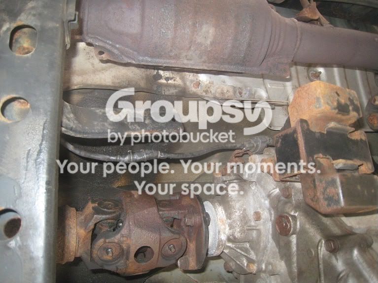

Well I put the runner in neutral, set the parking brake and climbed under the vehicle. It appears that the U-joints/DC are ok, but I have some serious backlash issues going on with my rear 3rd member. Not sure how much play is supposed to be in the transfer case but if I hold the rear pinion and try to turn the drive shaft there is no place. If I just grab the driveshaft and turn it I get about 1/2"-3/4" twist out of the driveline before the rear gears grab inside the diff :( I'm guessing I'm going to end up having to redo my 3rd member.
IMO, you should not have that much!
does the yoke screw in/out as you turn it?
pull the dline, and make sure the pinion nut is tight.
