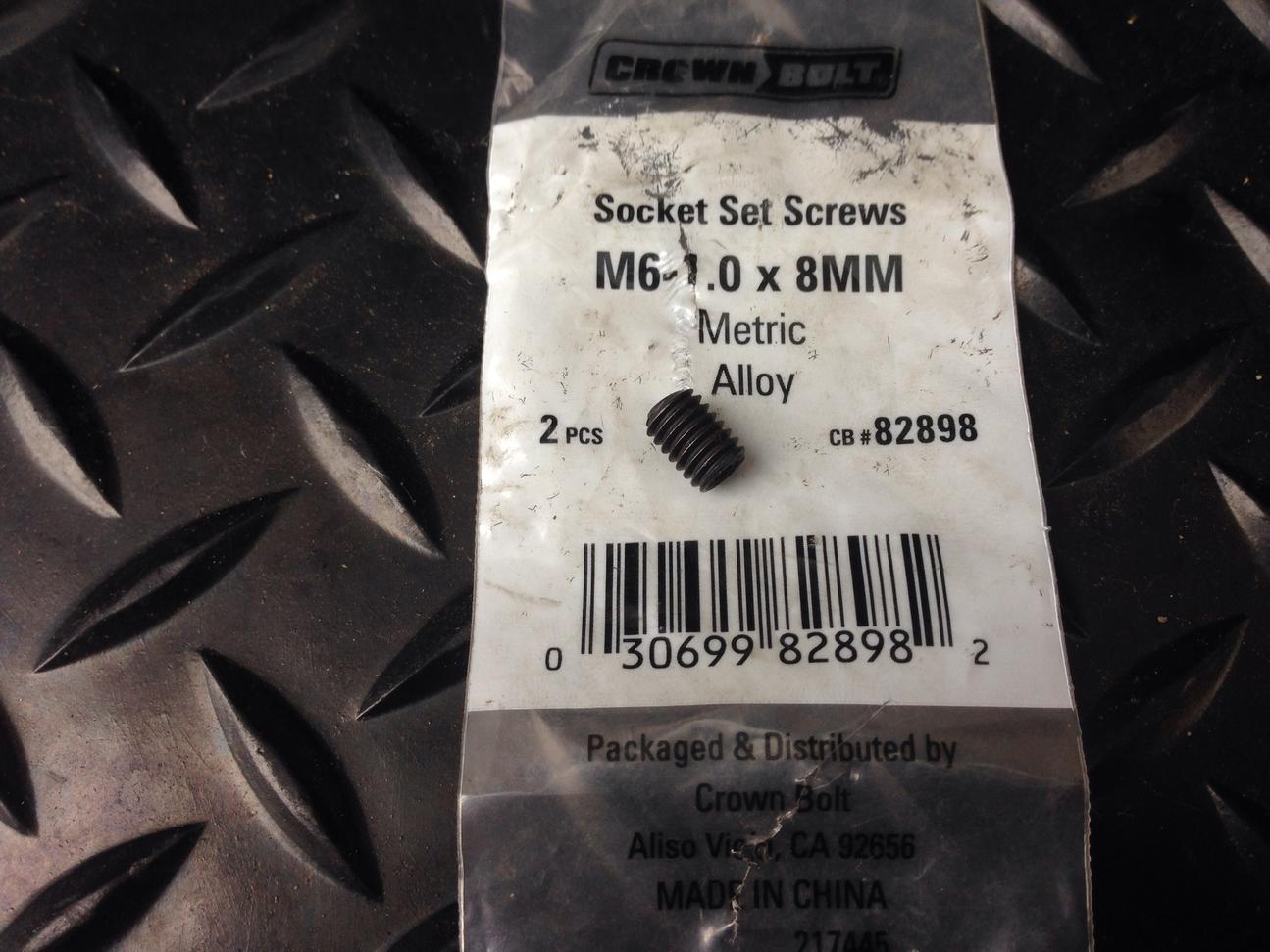

Do yourself a favor and use these for day to day, and put the zerks on only when servicing. I got tired of extracting the broken ones, these sit flush inside the housing. I did have to try a couple different lengths before i found the one that seated properly. I think i settled in 8mm but not 100% on that.
