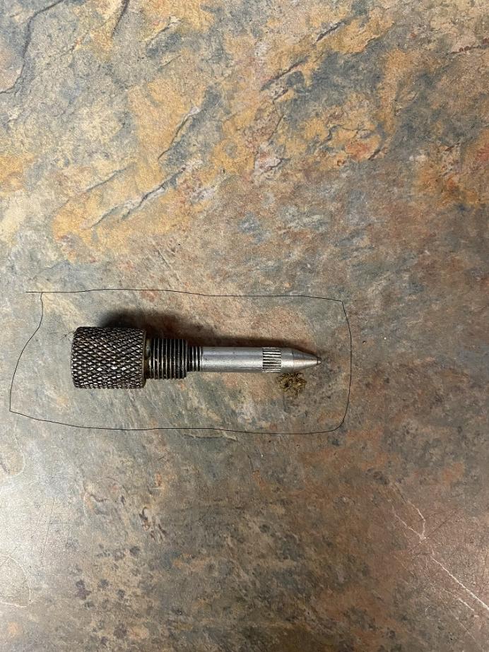

My grease gun came with this to use in tight places. You do need to make sure the zerk on the drive shaft is clean, and press the tip of this tightly against the ball of the zerk.

Yeah ive seen those. Hard to use sometimes as you really have to press it in. But like you said they work.
A needle grease fitting should work, but I grease mine fairly regularly and I've never had to use anything but the standard fitting. Just spin the driveshaft a little -- even if that means moving the vehicle a foot forward or back.
