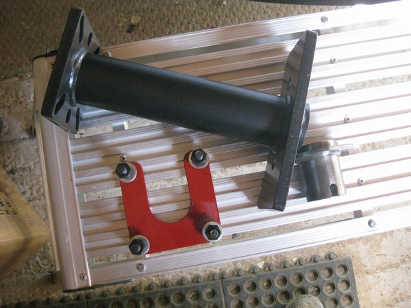

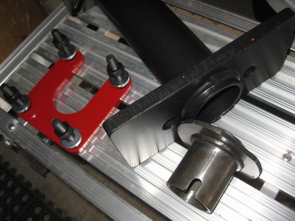

My new bearing removal tool arrived yesterday and it's even more refined that I expected. It no longer has gussets on the plate at the one end of the pipe; just nice clean welds so a bit less weight with the same strength. The fit and finish is top notch. Very pleased with the quality of these tools.
And, it's more functional and more affordable than what the competitions is selling.

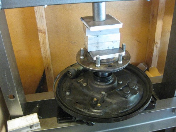

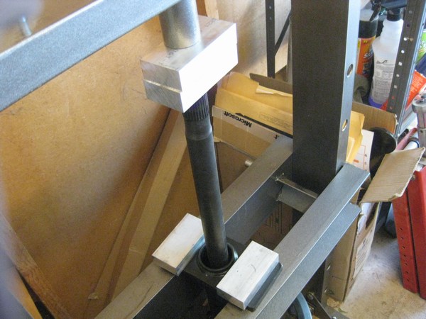

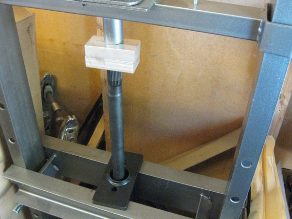

A little more info to share. The bearing tool worked perfect. Made the job so easy. I work alone 99.9% of the time so lifting the lower cross member to raise and lower it can be a pain so I picked up some aluminum blocks and 4" square plates to take up the space. The blocks can be used flat, sideways, vertical, or stacked along with the 4"x.5" plates.
Hey that's a great idea, where did you pick up the aluminum blocks?
