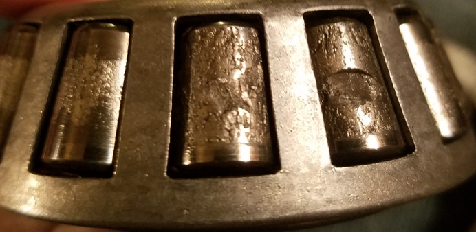

I just got done working on my E-locker 3rd replacing trashed bearings, see pic. After everything was put back I couldn’t get the locker to work, and of course I forgot to test before working on it. The only issue I had working on the 3rd was forgetting to lock it before removal, had to jump it manually on the bench before getting the 3rd back in.

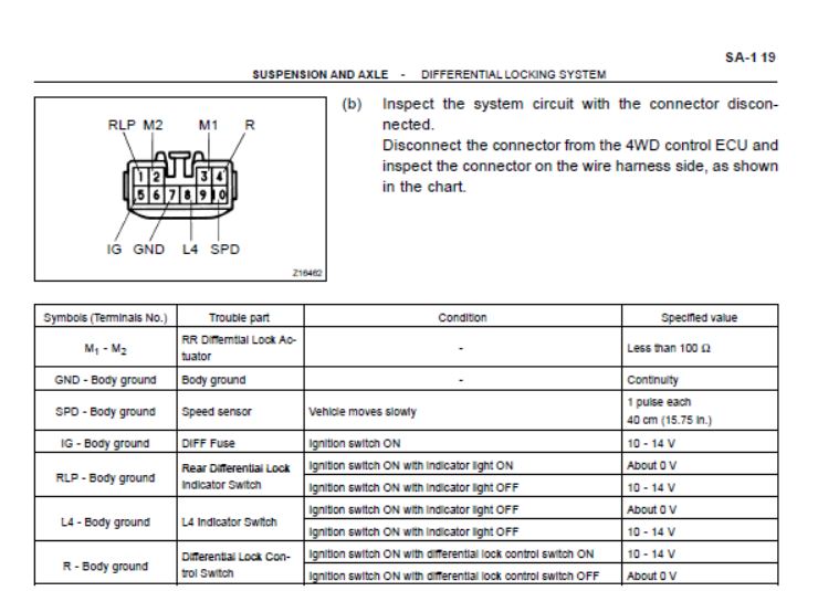

Tested resistance at 4WD(diff) ECU between motor leads and got <100 ohm.

Also tried all the tricks to get the locker to lock before I took the actuator off. I think its just not telling the motor to run.
Is there a easy way to test the L4 switch? Is there a 4lo light? i just see green 4wd and red diff lock.
I'll try the tests below and see.
